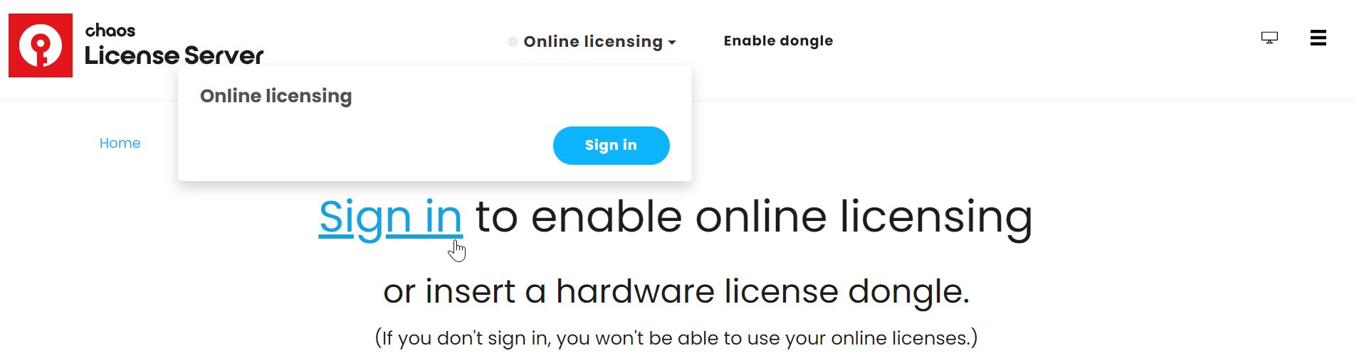

  • After the installation is complete, you will be redirected to the Chaos License Server's Interface. If you are not signed into a Chaos account, go to the Online licensing dropdown menu and select Sign in.
  • You are then prompted to enter your username/email and password.

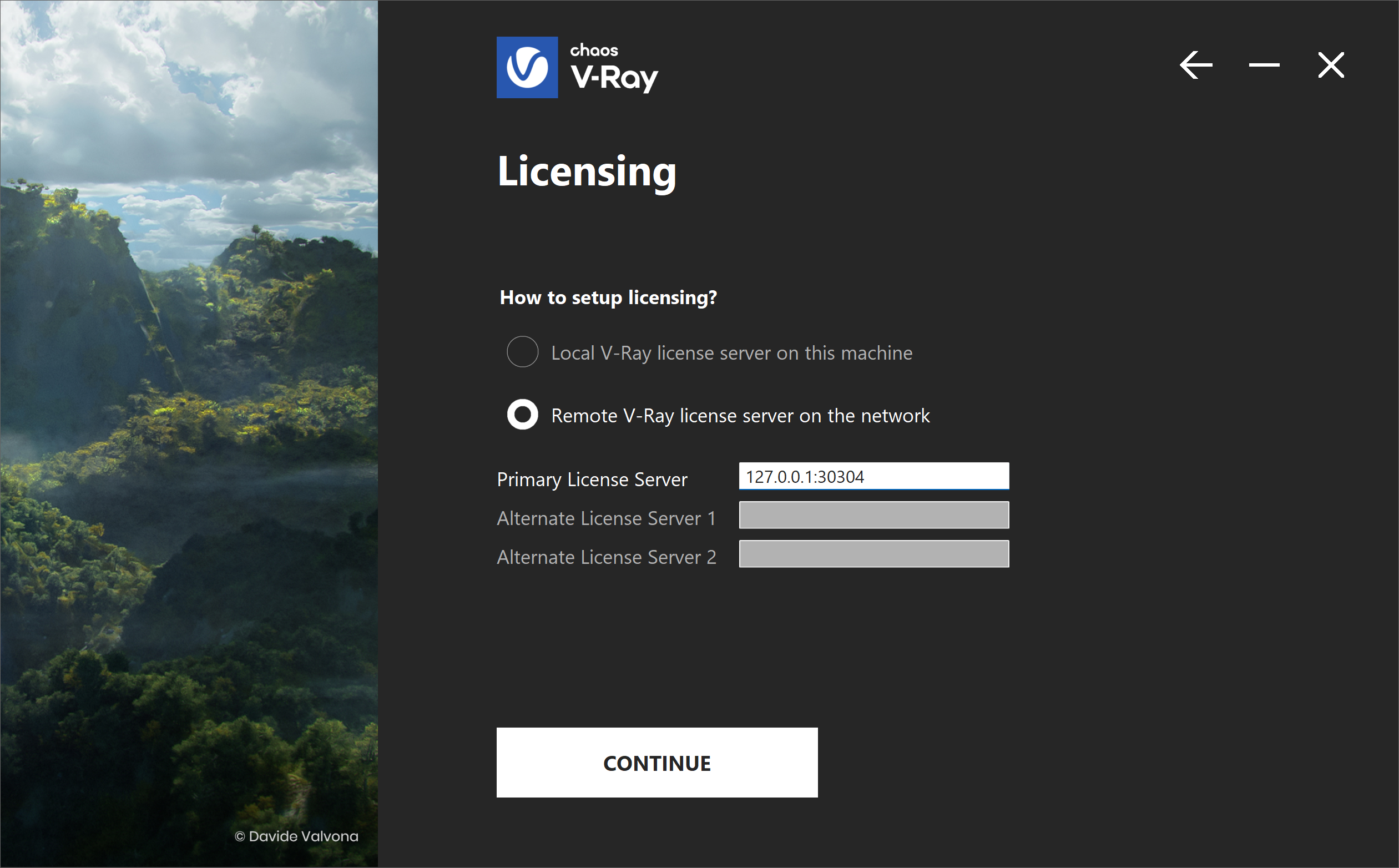

  • When installing your Chaos product, at the Licensing step, select Remote. In the Primary License Server field, type the server IP address that your license administrator gave you. At the end, add the :30304 port.
Example screenshot
