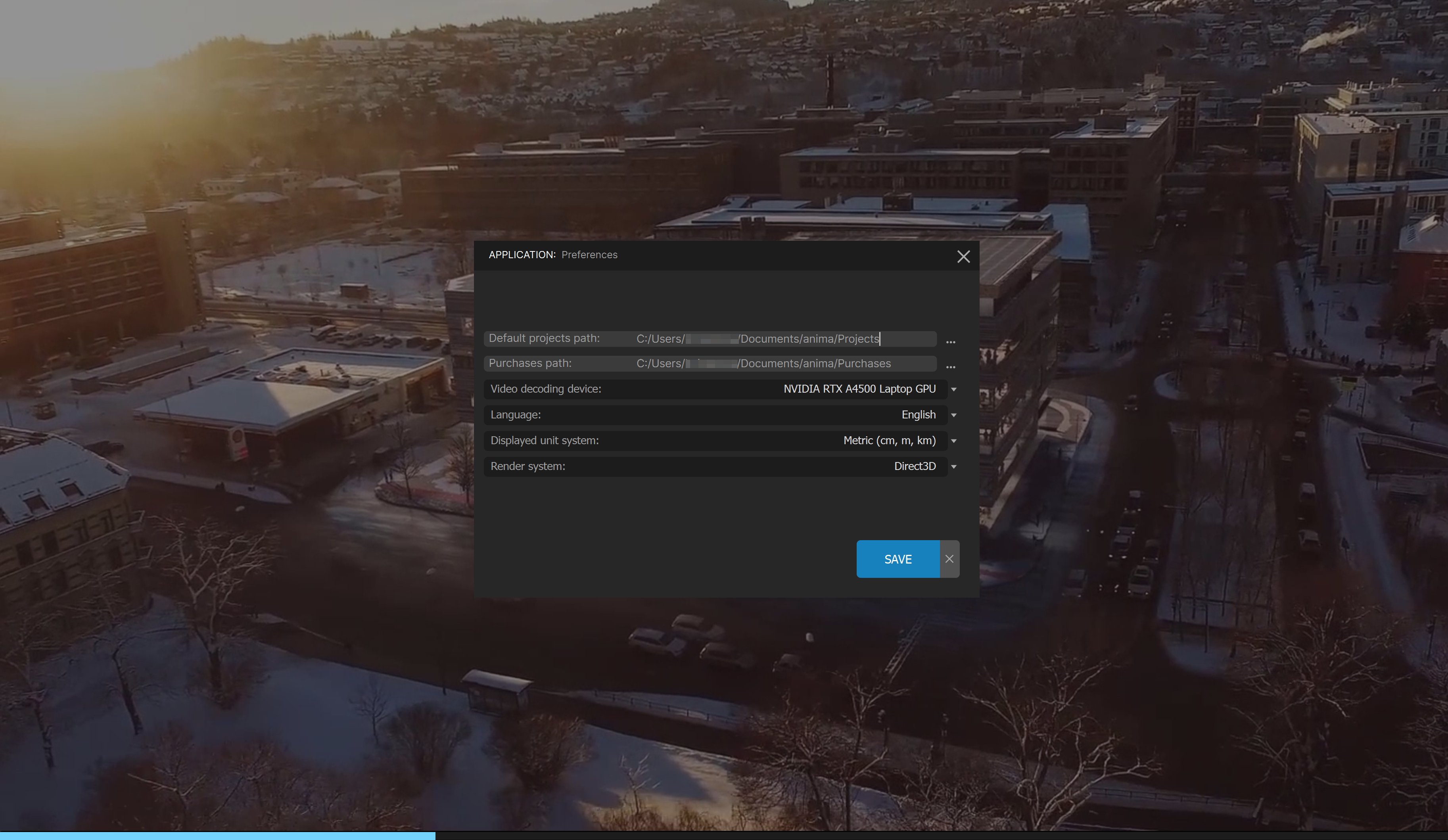

First boot: Preferences
Anima is started for the first time, the first window shown right after the splash screen is a reduced version of the Preferences dialog.
In that first boot preferences dialog, you can define the following options: Default projects path – This is the path where the projects you create will be stored by default. You will be able to define a different one in the Create New Project dialog too, but the path you set here will be used as the root path of your projects by default. Purchases path – This is the path where all the downloaded models from Anima will be placed. Video decoding device – Defines the device that will be decoding the video streams of the 4D actors. The options will be CPU or any of the GPUs supporting NVDEC that you may have installed in your system. (It might happen that some of your GPUs do not have hardware decoding capabilities yet. If that happens, Anima will detect it automatically and fall back to using the CPU as the decoding device.) Language – Sets the language of the interface. Currently, only English and Spanish are supported. Displayed unit system – Sets the displayed units (Metric or Imperial). Render system – Sets the Graphic Drivers used by the 3D viewport (OpenGL or Direct3D). If Anima shows an error right on start and closes, it is a good idea to try switching this setting to the alternative one. |
In a normal situation, this dialog should be shown only once, the first time you start Anima on the machine. However, you can also force it to appear again by using the “Anima Safe Mode” shortcut icon available in the Windows Start menu: |
All these settings can be changed anytime from the Preferences dialog available in Anima Menu > Edit > Preferences. |

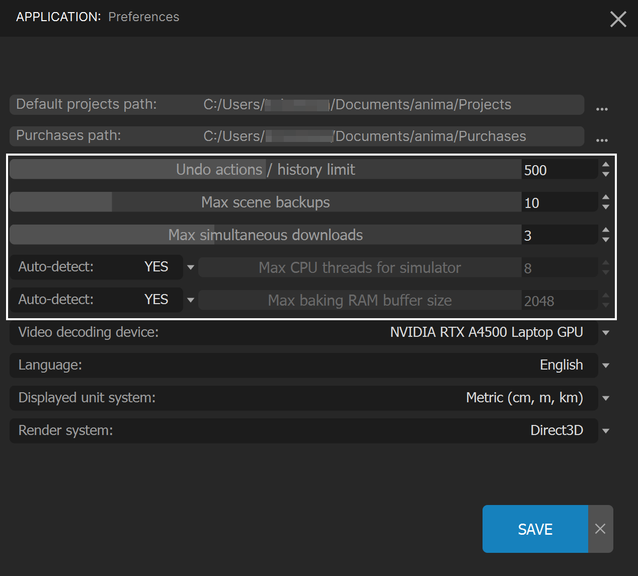

Which will show the following dialog with a few extra options. Undo actions | history limit – Sets the maximum number of actions that can be undone. Max scene backups – Sets the maximum number of scene backups that will be kept (learn more about this in the Scenes article). Max simultaneous downloads – Sets the number of actors that can be downloaded simultaneously. The maximum is 6, but you can choose a lower number if you want (learn more about how to download models from the library in the Installing Actors article). Max CPU threads for simulator – Configures the number of CPU threads dedicated to calculating the simulation. In most cases, the default Auto setting provides optimum results, but you can disable this and define the number of threads manually. Max baking RAM buffer size – Configures the amount of RAM used for baking animations before saving them to disk. Again, the default Auto setting provides optimum results in most cases, but you can disable this and define the RAM manually. If you don’t understand the need for some of those settings, don’t worry and bare with us, keep reading and you will understand them all soon. |
When all the options are defined, click the SAVE button to continue. |

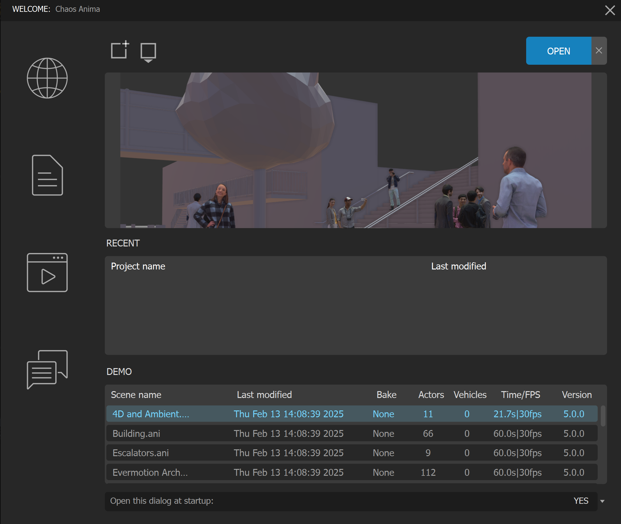

The Welcome Screen
After the initial boot, the first dialog that appears when Anima is launched is the Welcome Screen.
This window gives instant access to most of the things you will probably want to do when you start working. In the center of the window (RECENT), you will find a brief list of the recently modified projects on your machine, with the most recent at the top of the list. At the upper center, you can see a preview of the last scene that was saved from that project. Above the preview, there are 4 shortcuts to quickly manage the projects: Create New ( ), Browse ( ), Open and Close Window ( ). Below the recent projects, a list of the DEMO files is displayed, which is handy if you want to check some of the examples provided by the installer. On the left side, a column with five links is displayed to let you quickly access useful Anima resources that are available online: the Chaos Anima website ( ), this Anima documentation ( ), the Chaos Anima Youtube channel ( ) where you will find a lot of sample videos and tutorials, the Frequently Asked Questions and direct contact to our great Support Service ( ) where we will be happy to give you any assistance you may need. At the bottom center, you can choose whether you want to see this Welcome Screen or not when Anima is started. If you choose not to show it automatically, you can always show it manually by going to Anima Menu > View > Welcome screen. |
This is the complete list of items described:
Create a New Project – Create a new project.
Browse Project – Opens the browser to manually select the path of the project that you want to open (that is not in the recent projects list).
Open Selected Project – Opens the scene selected in the Project Scenes list.
Close Welcome Screen – Click to close the welcome screen.
Preview – Shows a preview of the scene selected in the Project Scenes list. These are generated by Anima automatically.
Recent Projects – Lists the 5 most recently used projects.
Demo Scenes – Open any of those scenes to see sample files that show Anima‘s key features.
View Website – Click here to open the Chaos website.
Open Documentation – Click here to go to the Anima online documentation.
View Video Tutorials – Click here to access Anima tutorials.
FAQ – Click here to see frequently asked questions about Anima.
Contact Support – If you have a question that’s not answered in our documentation, in the tutorials or in our Facebook User Group, click this button to contact our Support service and open a ticket.
Open at Startup – Choose whether you want the welcome screen to appear when Anima starts.

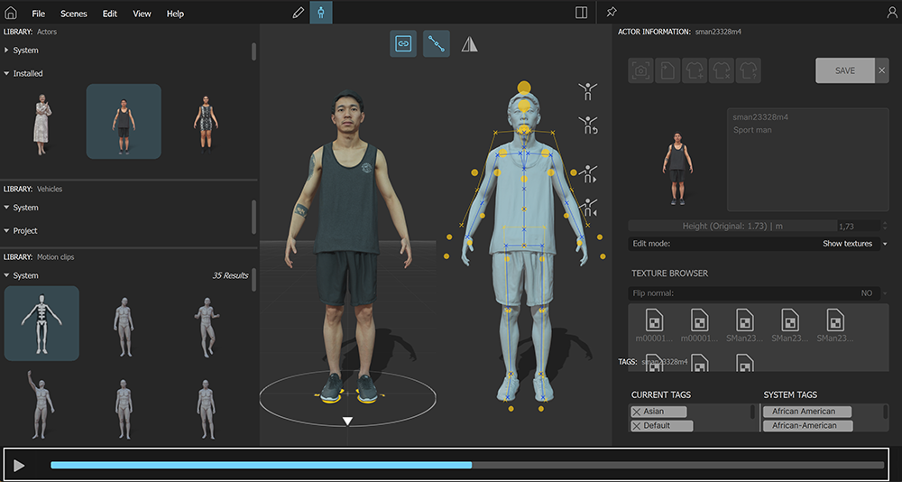

The Edit Mode Interface
The Edit Mode is the place to adjust, fine-tune and preview the animations of the actors. It is also the place to import new models and motion clips from external files in FBX format.
Notice that not all the actors can be modified. For example, the 4D models use cutting-edge technology with animated textures and dynamic topology that is simply too complex to be adjusted.
The model types that can be duplicated and modified are the Posed (static) and the Rigged (animable), either purchased from our website or imported in FBX from third-party providers.
In the Posed it is possible to modify the textures, generate more color variations, adjust the height or organize the TAGs associated with each model to easily find them later in the library.
In the Rigged it is possible to modify all the things already mentioned for the Posed, adding also the adjustment of the Base Pose of the bone structure, which can be helpful to fine-tune the simulations.
The base pose of the Motion Clips can also be adjusted, both in the ones provided in the default library and in the ones that you might have imported from third-party providers. It is also possible to edit the TAGs and Categories of the motion clips to organize them as you wish.
Main MenuThis is the core of the application, where you get access to all the other submenus (File, Scenes, Edit, View, Help).
ModeThe mode switch is used to toggle the workspace between Draw and Edit modes. |
Actors LibraryContains a list of all the actors available in the current project and the ones from the library that have already been downloaded to the Purchases folder. Please note that all the Library Panels have filters available in their titles (see number 4 from the previous Drawing Mode scheme) Import Model ( ) . Use it to import new actors in FBX format. |
Motion Clips LibraryContains a list of all the motion clips and categories available in the current project and allows you to import additional motion clips. Import Motion clip ( ) . Use it to import new animations in FBX format. |
Preview windowDisplays a preview of the character selected in the Actors Library with the animation selected in the Motion Clips Library. Any edits to the pose or textures are updated live in this window. |
Pose Editor WindowUse the pose editor to adjust the Actor’s pose for the currently selected motion clip. This can be used to correct individual actors for each individual motion clip (with one clip selected) or apply changes to the main pose of this actor (with the Rest-Pose selected). Joints – Click hold and drag them to change the angle or the position to adjust the pose. Current Actor bones (yellow). Reference Actor bones (blue). |
Preview Viewport ControlsSynchronize Viewports – Links the rotation of both viewports. Reference Pose – Shows the Anima default standard actor and both bone structures ( blue -> default actor & yellow -> current actor) to use it as a reference pose for adjustments. Only is available when the Rest-Pose is selected. Symmetrical pose edit – Lets you edit the left and right sides of the actor at the same time.
Pose Edit ToolsTools that can help you edit the pose: Pose Reset  Undo last saved pose  Copy pose  Paste pose  |
User Account | PanelsUse the Account button to sign in/out of your user account and access your models and notifications. Use the Panels button to show or hide the panels available in Draw mode (Actor library, Clip library, Actor Information, and Tags). |
Actor / Clip InformationDisplays settings and components for the currently selected Actor or motion clip. |
Tags / CategoriesTags and categories help you to organize your resources and allow the system to match the correct motion clip to the characters. |

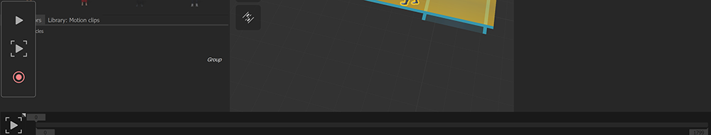

Playback
Plays the motion clip and the character selected.
