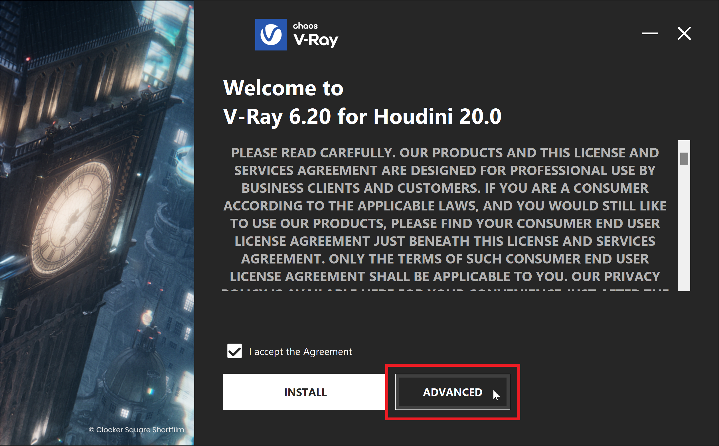

  • Download your Chaos product(s) and run the installation wizard. After accepting the End User License Agreement, you need to select the Advanced installation option.
Example screenshot
