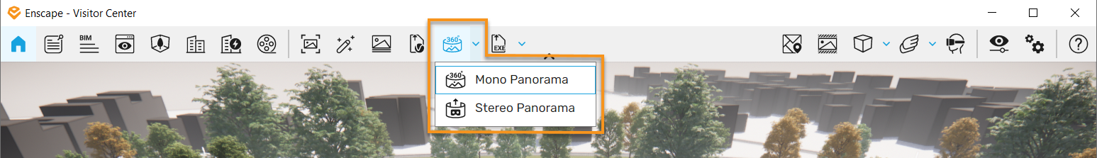

Load a project into your CAD, start Enscape and open the Visual Settings window and set the Projection to Perspective. Optionally, you can adjust the Panorama Resolution in the Visual Settings’ Output tab. Higher panorama resolutions will take longer to export.
Navigate to a position in the Enscape Viewport where you want the panorama to be captured from. You can click the Render Panorama button directly (which will export a Mono Panorama by default) or click the small arrow next to the Render Panorama button to choose Stereo Panorama if you want to view the panorama in Google Cardboard.
Enscape's Render Panorama buttons

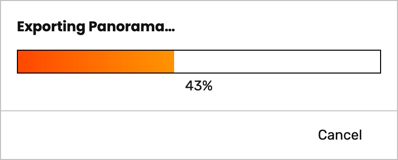

The panorama will now be generated and exported, indicated by a progress bar.
Once exported, by opening Enscape’s Upload Management dialog via the associated Upload Management button located back in Enscape’s CAD specific toolbar, you will be able to manage your exported panoramas further.
Panorama Export Progress Bar

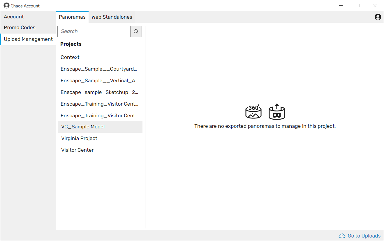

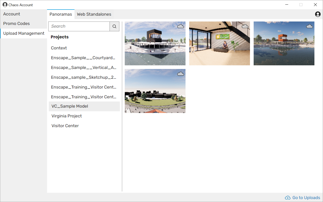

The Upload Management dialog will open and display the Panorama tab by default. If no panorama has yet been exported from a project the dialog will reflect this fact:
Upload Management dialog if no panoramas have been created
If you haven’t done so already, go ahead and create a panorama as outlined above. Come back to the Upload Management dialog, select the project listed under the Projects section of the dialog and any associated panoramas for that project will be shown in the dialog window.

A set of exported mono panoramas

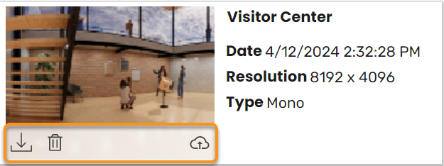

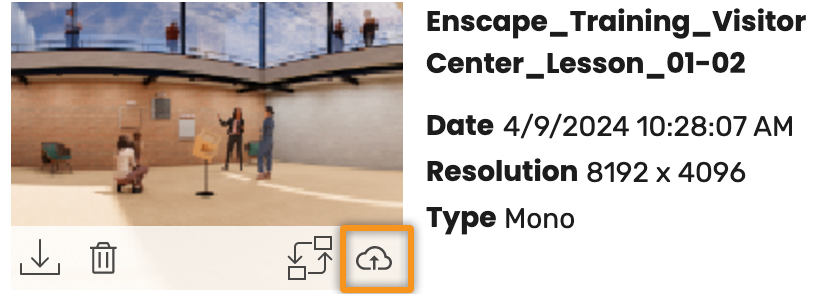

Hovering your mouse over any of the panorama thumbnails in the Upload Management dialog will display a set of buttons, as well as some information about which project the panorama is associated with, when it was created, its resolution, and if it is a mono or stereo panorama.
Default buttons available on exported panorama

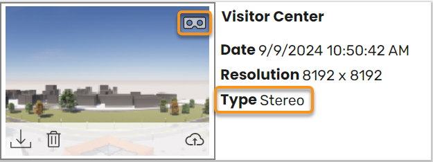

Thumbnails for stereo panoramas will additionally display a ‘glasses’ icon, as well as indicating the Type of panorama when mousing over it.
Stereo Panorama

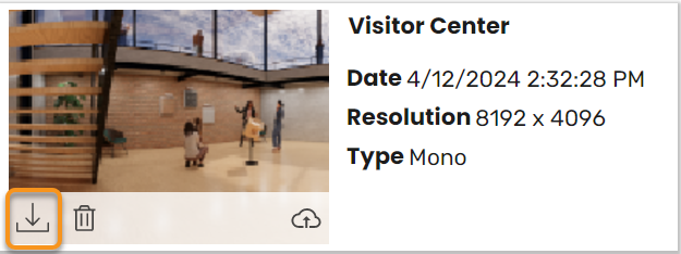

The four buttons along the bottom of the thumbnail allow the following functions:
Save panorama as file… – will prompt you to save the file locally. You will be able to choose from a JPEG Image (*.jpg, *.jpeg), Portable Network Graphics (*.png), Windows BitMap (*.bmp), or Tagged Image File (*.tif, *.tiff).
Save panorama as a file button

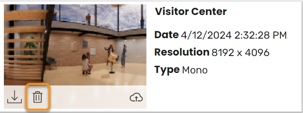

Delete panorama – file (only available when the panorama is not uploaded to the cloud.
Delete panorama button

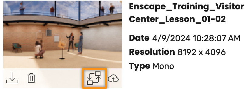

Replace uploaded panorama in cloud… – As long as there is already a panorama uploaded to the cloud, then the Replace uploaded panorama in cloud… will become available to the user. This allows the panorama selected in the Upload Management dialog to replace a panorama that is already uploaded to the cloud. When replacing a panorama, any QR Code or URL associated with the panorama in the cloud to be replaced will be adopted by the panorama that replaces it.
Replace uploaded panorama in the cloud button
Upload panorama to cloud – This will result in the selected panorama being uploaded to the cloud so it can be shared and be used in the Gallery / Tour feature.
Upload panorama to cloud button

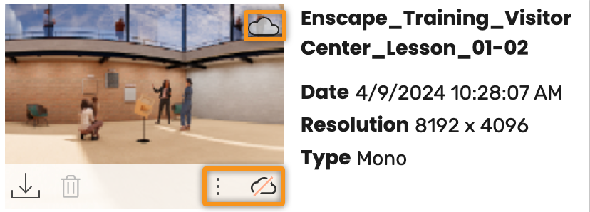

Once a panorama has been uploaded to the cloud, the thumbnail will display a small cloud symbol at the top right of the thumbnail image to indicate that image is now also stored in the cloud. If you hover your mouse over panorama thumbnails you will notice the above four buttons have changed slightly to reflect some more functions that become available to a panorama that is stored in the cloud.
You can still download the panorama as a file locally, but deleting it is disabled, and two new buttons appear.
Functions available for panoramas uploaded to the cloud

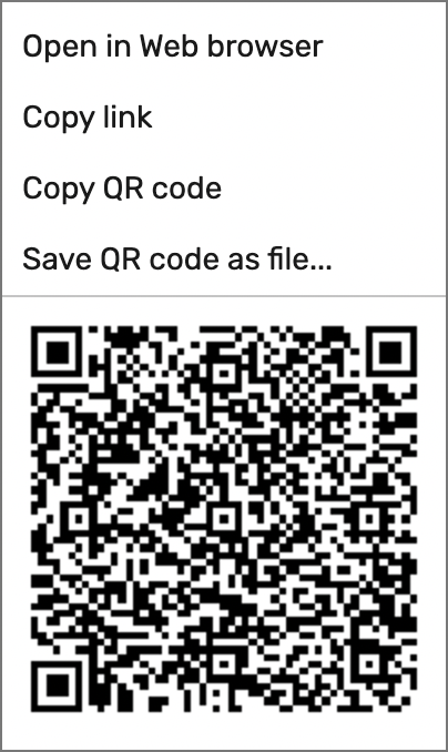

Clicking on the 3 vertical dots will reveal the following menu which, as well as providing an option to view the panorama in your web browser, also provides a QR code which can be directly scanned or which can be saved as a file locally, or which can be directly copied and then pasted into a document. The Copy link option will copy the panoramas URL.
Note that, if you use the Replace uploaded panorama in cloud… the QR code associated with the file being replaced will be retained and used for the panorama that replaces it.
Menu for QR code, copy link, and open panorama in browser

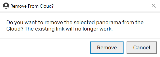

The last button, a cloud with a line through it, will remove the panorama from the cloud if clicked. The panorama will remain in the Upload Management window until deleted via the Delete panorama button.
You will be prompted to confirm deletion from the cloud.

Prompt to confirm removal of panorama from the cloud

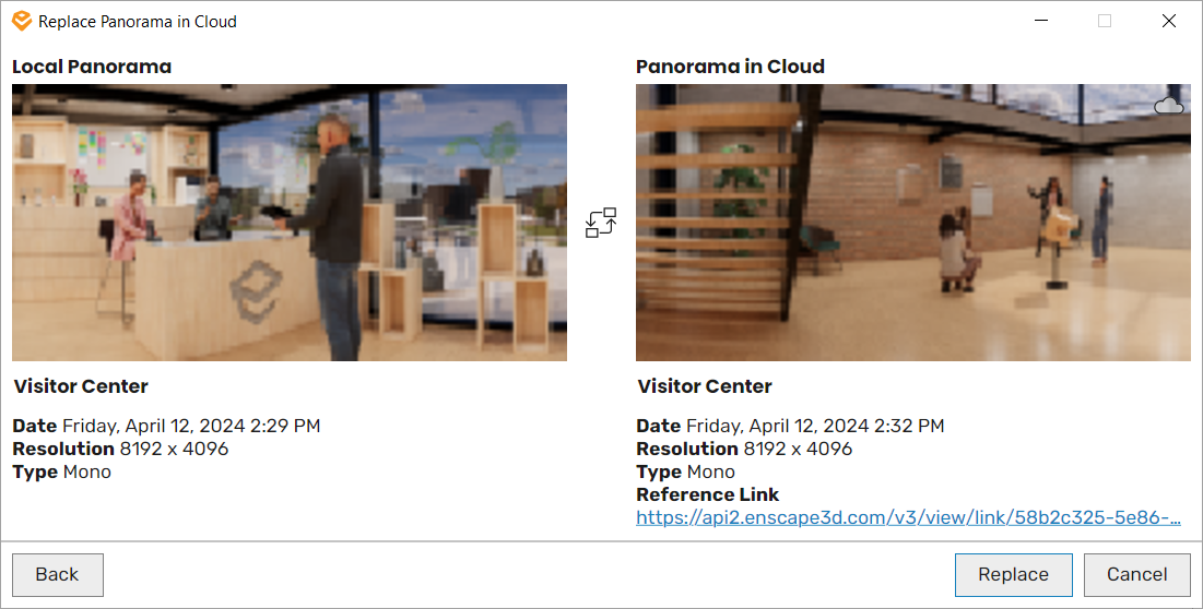

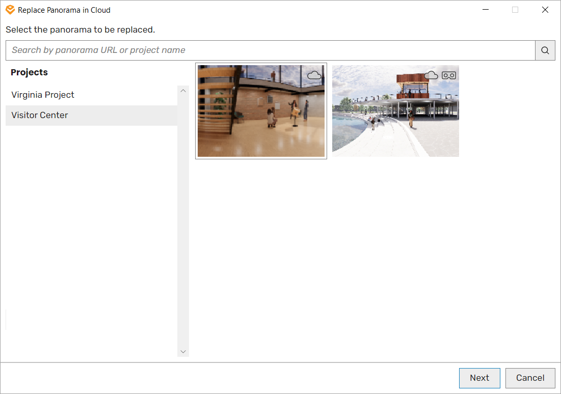

Replace a Panorama
To replace a panorama in the cloud you will need at least one panorama already uploaded to the cloud and at least one panorama that is not uploaded to the cloud but is listed in the Upload Management dialog.
Once these requirements are met, click the Replace uploaded panorama in the cloud… button which will open a dialog where you can choose the file you’d like to replace.
Replace Panorama dialog
Click Next to confirm the replacement, here in this example you’ll notice were replacing a mono panorama with a stereo panorama:
Replacement Confirmation dialog

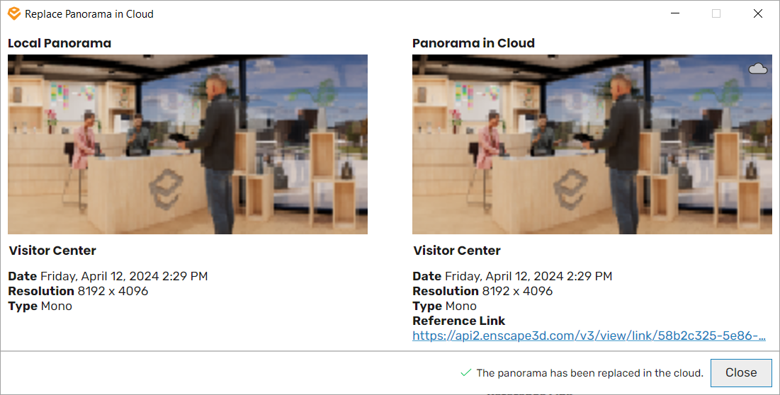

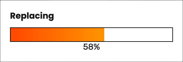

Go ahead and click the Replace button if you are sure you would like to continue. A ‘Replacing’ progress bar will indicate replacement is processing. Note, the Reference Link will stay the same for the newly uploaded panorama.
Replacement Process Bar
On completion you will then be informed replacement has succeeded by the message ‘The panorama has been replaced in the cloud’. Click Close.
Confirmation that a panorama has been replaced

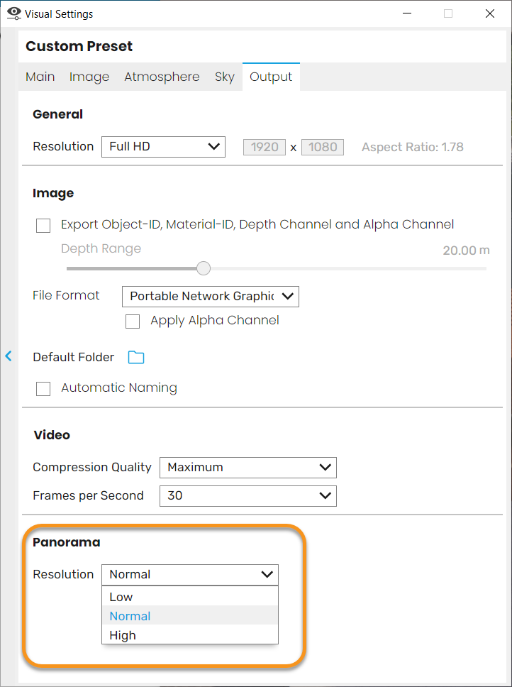

In the Enscape settings, you can modify the overall rendering quality of panorama files, and this can be found in the Visual SettingsOutput tab. This also affects the panorama rendering time and quality. Medium generally produces great results at a high speed, Ultra provides the highest quality but takes the longest time.
The resolution can be specified in the Output tab from the PanoramaResolution drop down menu. Be aware that only the height is taken into account. The width is adjusted accordingly.
Resolution
Mono
Stereo
Low
2048×4096
4096×4096
Normal
4096×8192
8192x 8192
High
8192×16384
16384×16384
If you are not happy with the exposure brightness in your final panorama, disable Automatic Exposure in the Visual Settings’ Main tab and set a manual exposure that works for you. If Auto Exposure is enabled, Enscape measures a good exposure when starting the panorama capture that might not be ideal for the overall panorama.

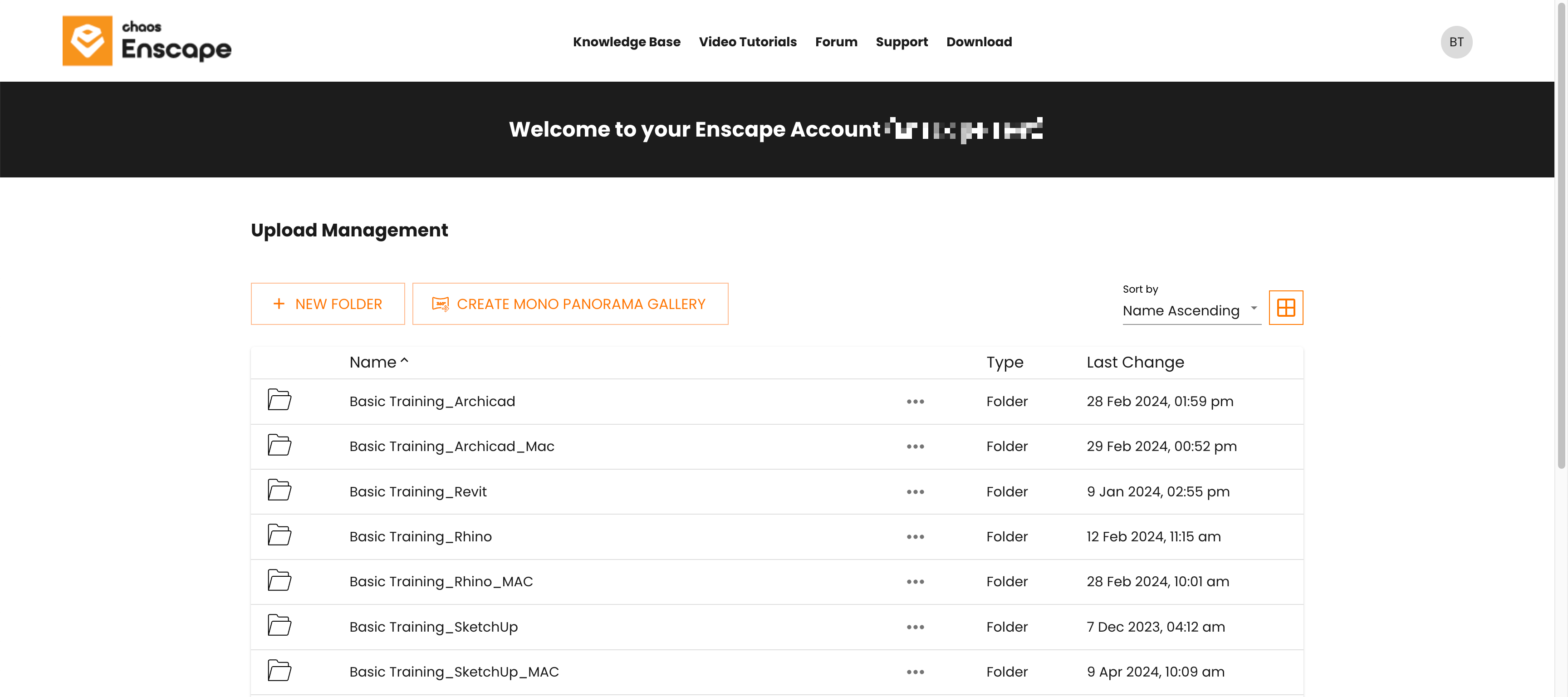

Enscape Accounts Upload Area
When you are logged in to your Enscape Account, navigate to the Uploads area to access a feature that allows you to create a Gallery or Tour made up of multiple panoramas created from the same CAD project.
Make sure to refer to this Manage Uploads article to understand how having an account will allow you to log in and access this feature.
NOTE: The Panorama Gallery / Tour feature is not available to Trial users (and Students/Educators purchased prior to February 07, 2023). Additionally, the Panorama Gallery / Tour will not work in VR HMD units.
Once you have uploaded a panorama to the cloud, it will be available in the Enscape Account Upload area.
In the Enscape Account -> Uploads area, a folder will be automatically created using the same name as the CAD Project the panorama has been exported from.
Enscape Account Upload Management

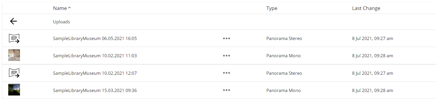

If your panoramas are created in stereo, then these will not be available for selection for a Gallery or Tour, as only mono panoramas are supported. Mono panoramas are listed in the Enscape Account Upload area along with a small thumbnail of the panorama. Stereo panoramas will have a generic icon next to them instead. You will also notice the distinction is also made under the Type column.
Any panoramas that are uploaded to the cloud will use the name, date, and time as their file name by default. These files can be renamed in your Enscape Account -> Uploads area if required.
Renaming, Moving, Deleting, and Share Options can be accessed via the 3 dots menu next to each panorama listed in the Uploads area of your Enscape Account.
Mono and Stereo Panoramas listed in Upload Management

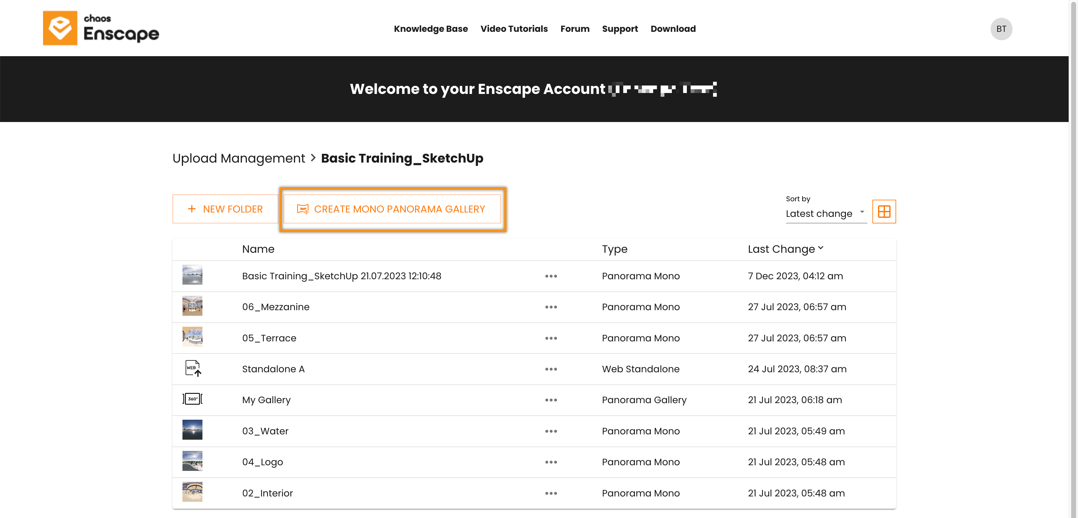

To begin to create the Gallery / Tour, click on the Create Mono Panorama Gallery button.
Once you have uploaded any Panorama from a project to the Cloud, it will be available in your Enscape Account Upload area.

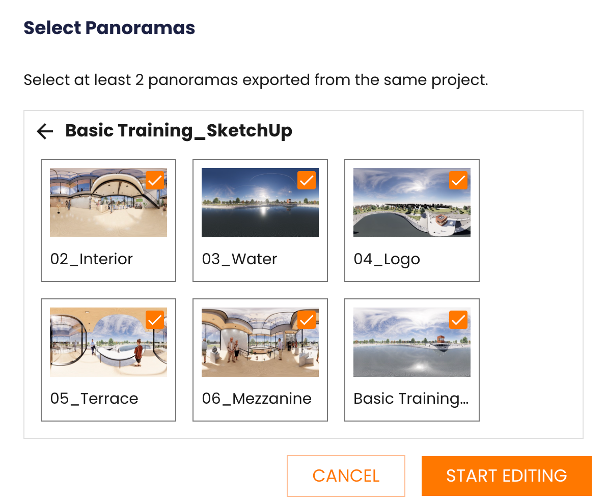

Then select the panoramas you want to use from the Select Panoramas dialog that will appear and press Start Editing once done. Note that you will need to select at least 2 panoramas from the same project to continue past this point and that only mono panoramas can be used.
Select the panoramas you want to include in the Gallery

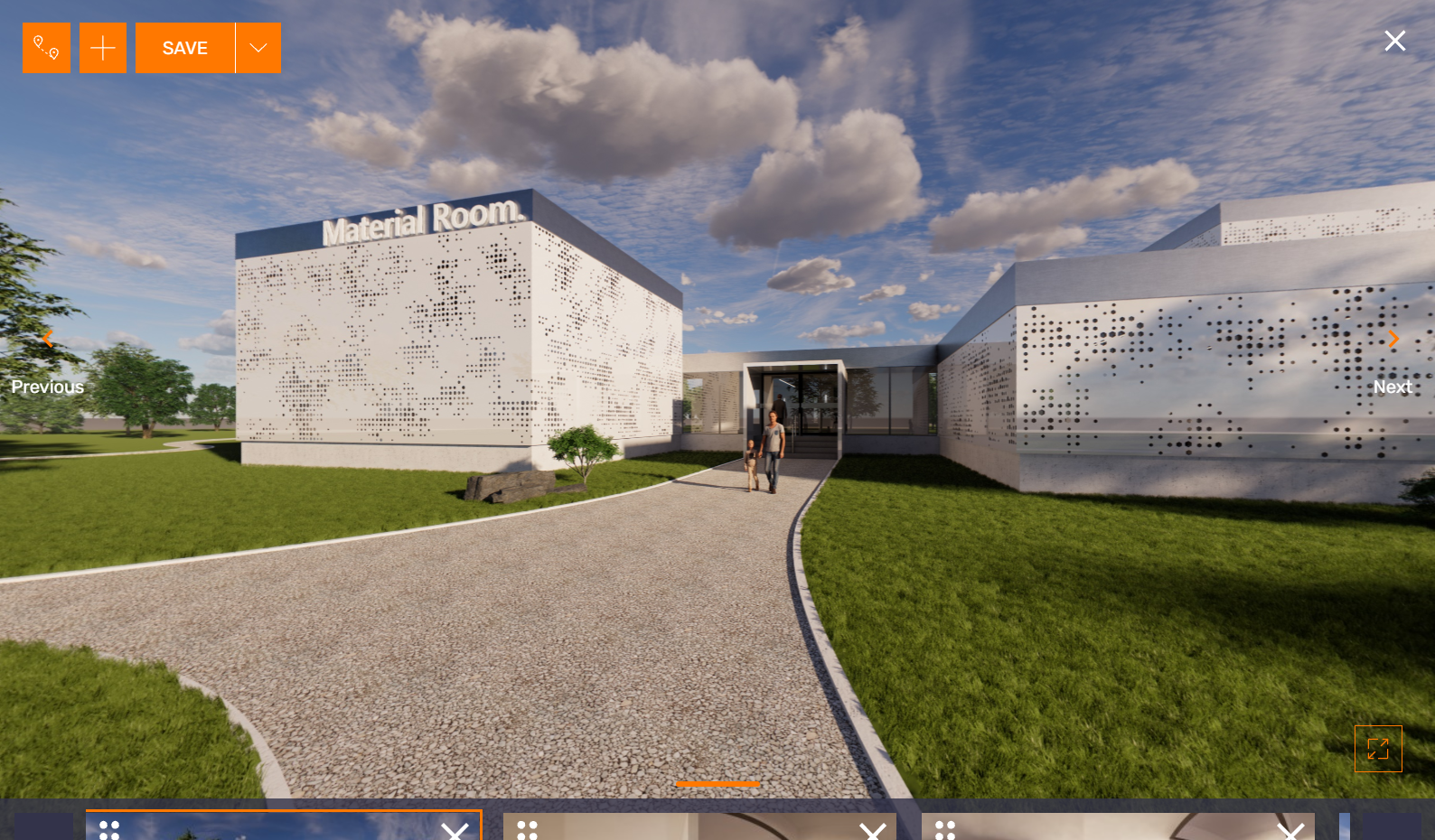

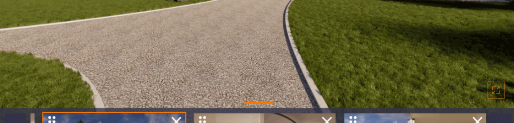

The Gallery provides a slideshow with Previous and Next buttons located at the left and right sides of the browser window.
The Gallery Editing mode can also be set to full screen by clicking the button located at the bottom right side of the browser window. Press [Esc] to exit full screen mode.
Gallery Navigation buttons

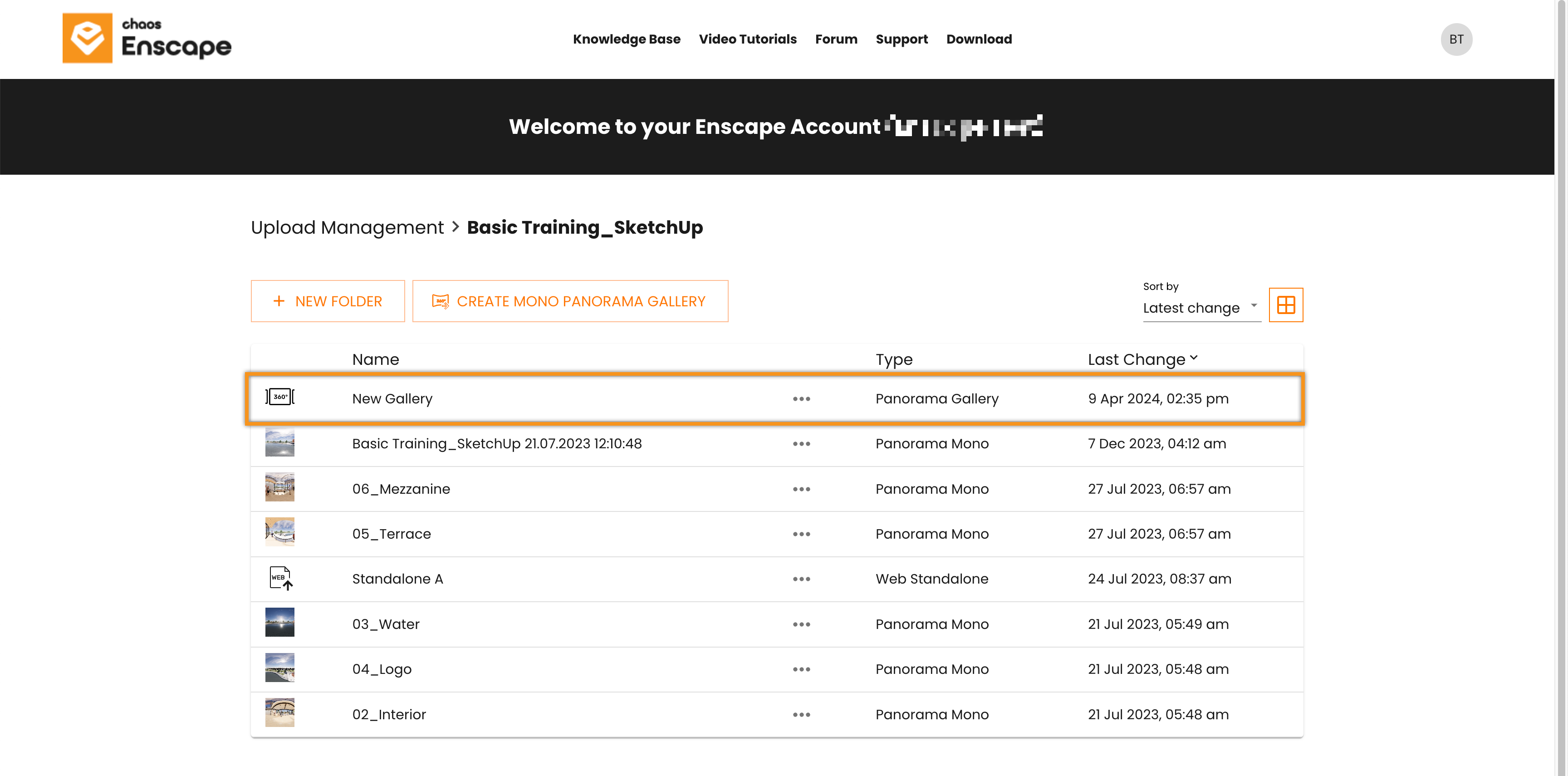

Once the Gallery / Tour has been saved, it will be listed in your Enscape Account with an associated Gallery / Tour icon as well as being named under the Type column. From here you can move, share, rename, or delete a Gallery / Tour, and this is explained fully in the Manage Uploads article.
The Gallery is now available in your Enscape Account
