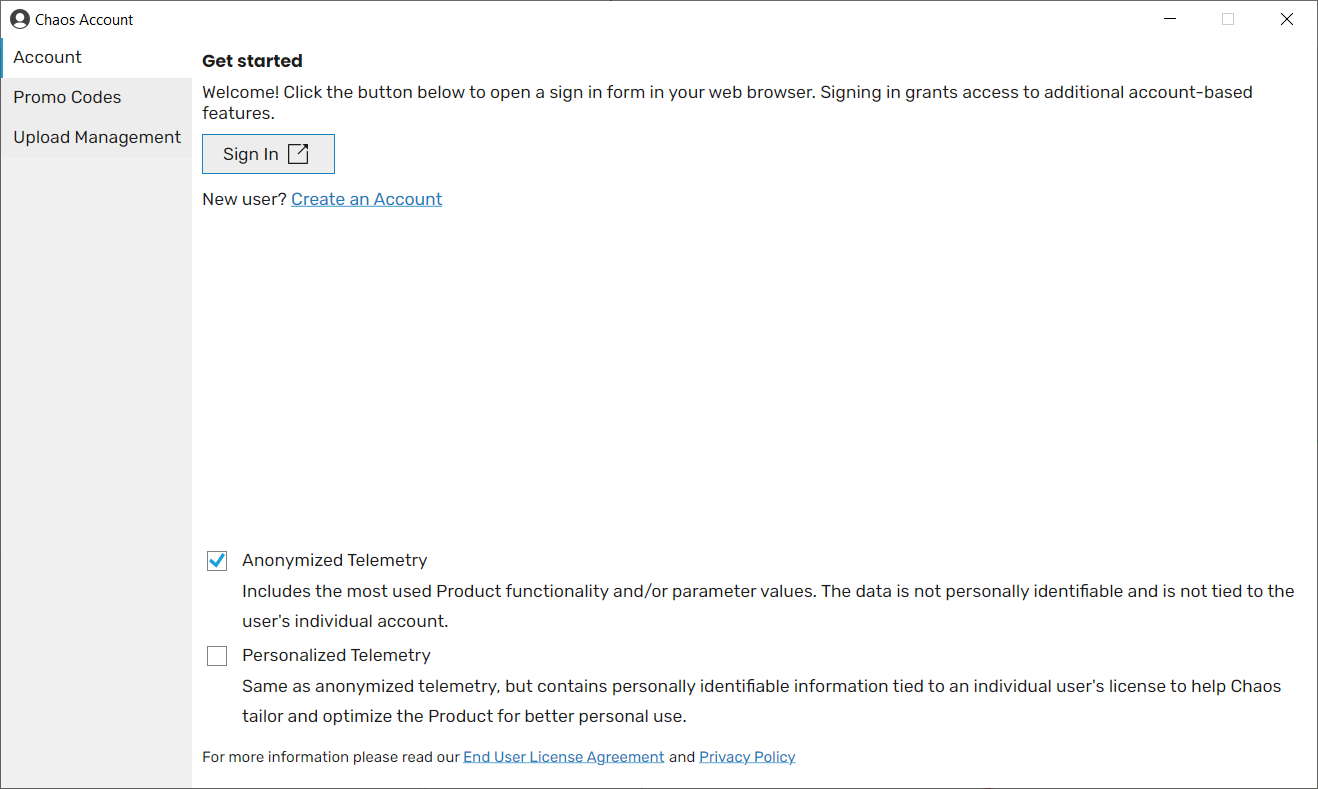

Sign in button in the Chaos Account window

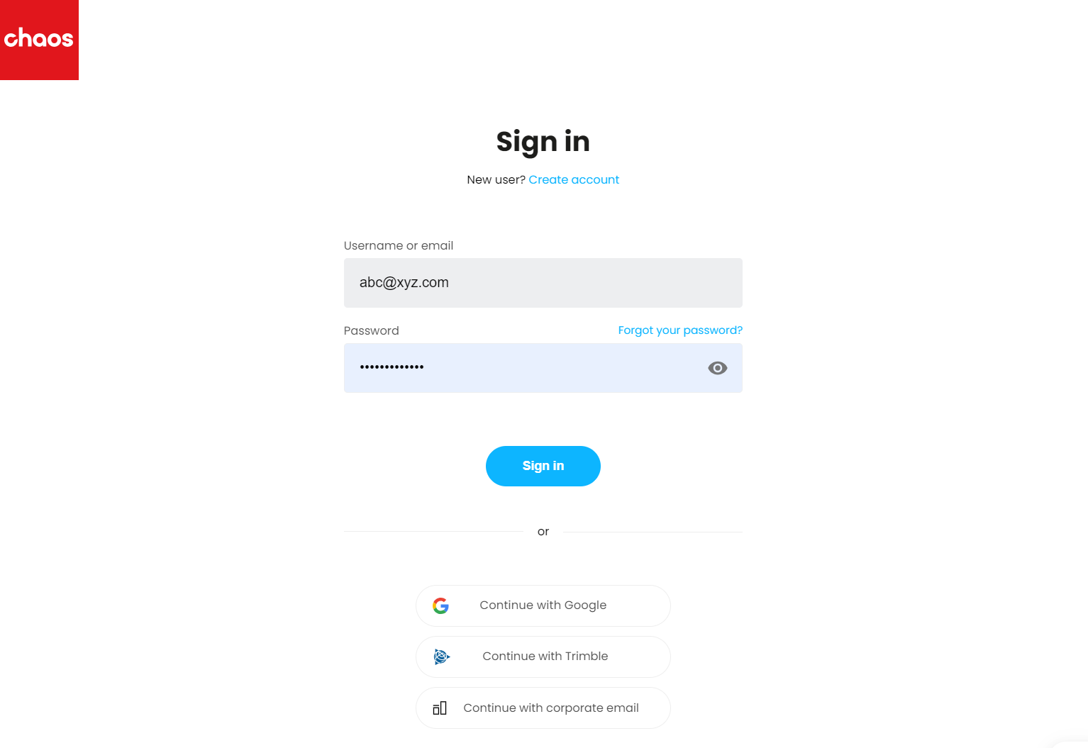

Once you click sign in, you will be directed to the sign in page on your web browser. Here you can fill in your login credentials and click Sign in.
Login credentials window

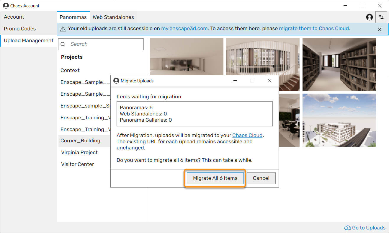

Migration to Chaos Cloud
By opening Enscape’s Upload Management dialog via the associated Upload Management button my.enscape3d.com. To access them here, please migrate them to Chaos Cloud.” In order to start the migration, you can either click on the link in the note, or click on the migrate button on top right of the window.
located back in Enscape’s CAD specific toolbar, you will be able to manage your uploads. The Upload Management dialog will open and display the Panorama tab by default. If you already have panoramas and web standalones saved, a note will show up on top of the upload management window, informing you that “Your old panoramas are still accessible onMigrate button
Once you click on the migrate button, the Migrate Uploads window will open and give you an overview of items waiting for migration. This will include the number of Panoramas, Web Standalones and Panorama Galleries (If you already have galleries created in your Enscape Cloud). Please note that the existing URL for each upload is not affected and still remains accessible and unchanged.
Once you are ready to migrate, click Migrate All Items.
Migrate Uploads Window
After this step, Migration to Chaos Cloud will start and you will be able to see the status bar for each upload.
Migrating to Chaos Cloud
When you are done with the migration, you can simply click the Go to Uploads link on the bottom right of the window. This will take you to your projects menu in the Chaos Cloud. Here you will see all your migrated projects sorted under project folders. Within each folder you will find all your uploads without the need to sort them manually inside Chaos Cloud.
