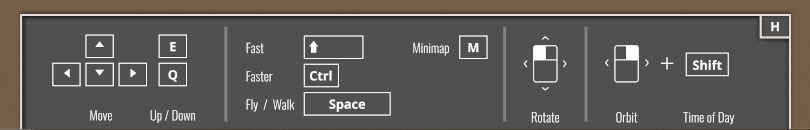

Once the server has finished processing the data, your default browser will open. Once the Standalone has loaded in to your browser it will automatically display your project from the same position that was showing in the Enscape window. The Help Overlay appears automatically when the web standalone is opened. You can toggle it on and off using the H key on your keyboard. Movement in any direction can be controlled on your keyboard via the arrow keys, and the E and Q keys to move up and down, respectively. To speed up the movement somewhat, hold the Shift key; to speed it up even more, hold the CRTL key. Toggle between Fly and Walk mode with the spacebar. Pressing M turns the mini map on and off. To generally rotate the view, click in the window with your left mouse key and drag in the desired direction. Adjust the time of day by pressing shift, holding the right mouse key, and moving the mouse. |
Help Overlay in the Web Standalone

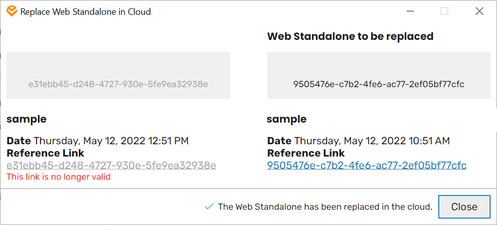

Replace a Web Standalone
Clicking on the Replace another uploaded Web Standalone in the Cloud with this… button will result in the associated Replace Web Standalone in Cloud dialog to open, where you are asked to choose the Web Standalone to replace. You can replace Web Standalones that have been exported from different projects and these will retain the URL / link associated with the Web Standalone being replaced / deleted. |
Replace Web Standalone dialog |
Once you’ve selected the file to replace, you will be asked to confirm the details of the exchange. |
Details of the Web Standalone to be replaced |
And then a final confirmation dialog to proceed, as the Web Standalone to be replaced will be deleted entirely. |
Final confirmation to replace a Web Standalone |
If successful, you will receive a confirmation notice that the Web Standalone has been replaced. Additionally, please refer to this article that explains how you can further manage Web Standalone files via your Enscape Account Upload section. |
Replacement of Web Standalone successful |
