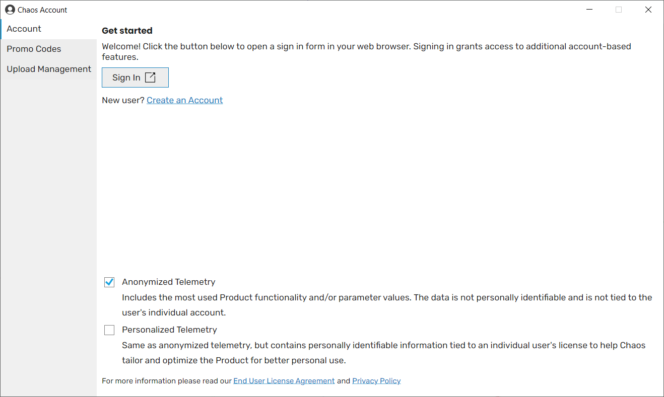

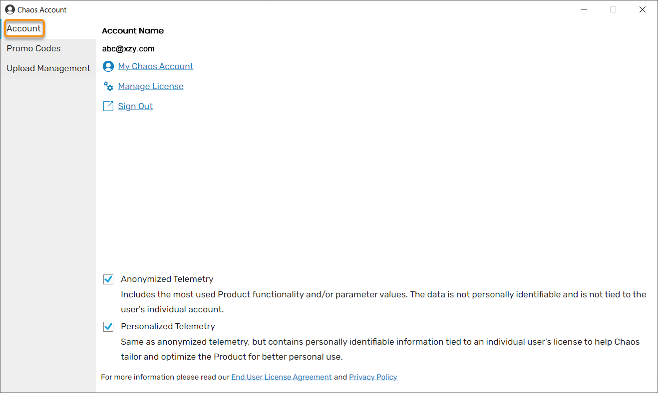

Sign in button in the Chaos Account window
Once you click sign in, you will be directed to the sign in page on your web browser. Here you can fill in your login credentials and click Sign in.
Login credentials window
After successfully signing in, you will be able to see your account details in the Chaos Account  window -> Account.
User signed in

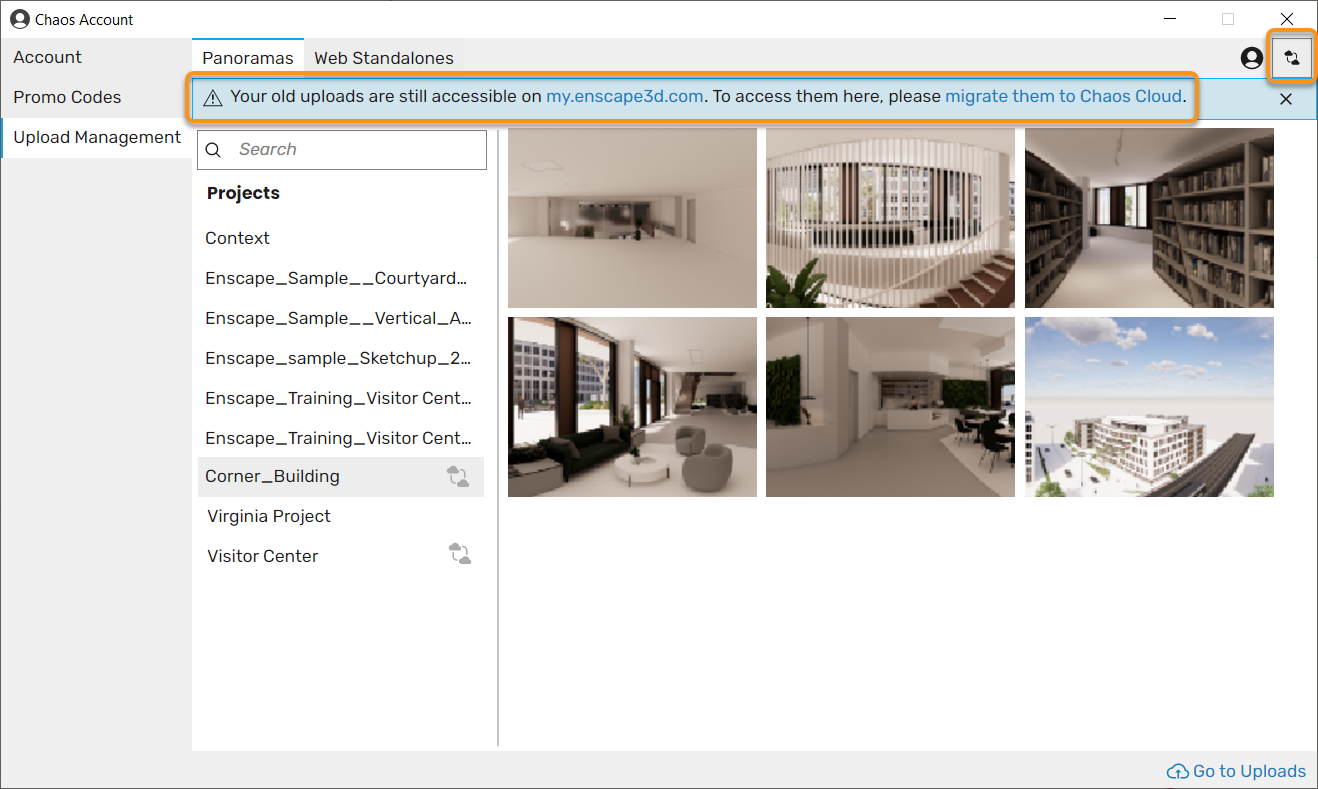

By opening Enscape’s Upload Management dialog via the associated Upload Management button located back in Enscape’s CAD specific toolbar, you will be able to manage your uploads. The Upload Management dialog will open and display the Panorama tab by default. If you already have panoramas and web standalones saved, a note will show up on top of the upload management window, informing you that “Your old panoramas are still accessible on my.enscape3d.com. To access them here, please migrate them to Chaos Cloud.”  In order to start the migration, you can either click on the link in the note, or click on the migrate button on top right of the window.
Migrate button

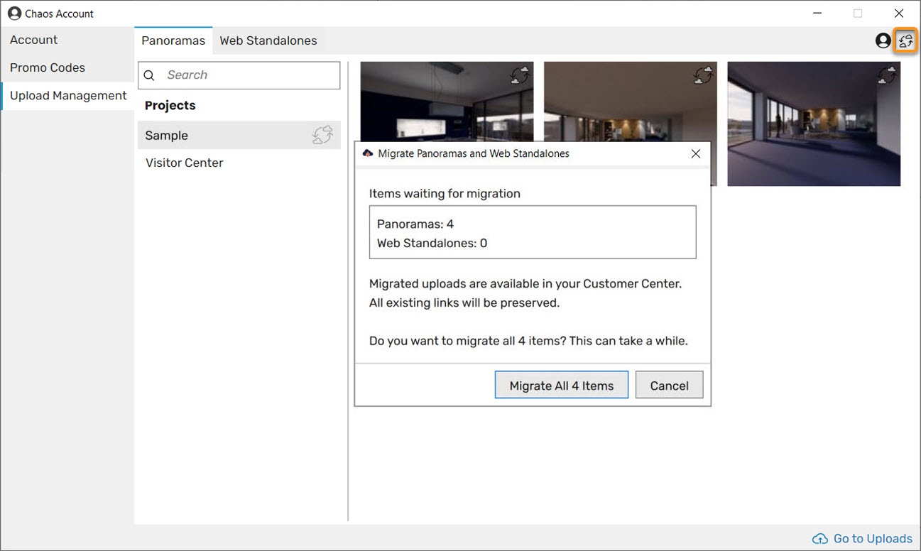

Once you click on the migrate button, the Migrate Uploads window will open and give you an overview of items waiting for migration. This will include the number of Panoramas, Web Standalones and Panorama Galleries (If you already have galleries created in your Enscape Cloud). Please note that the existing URL for each upload is not affected and still remains accessible and unchanged.
Once you are ready to migrate, click Migrate All Items.
Migrate Uploads Window

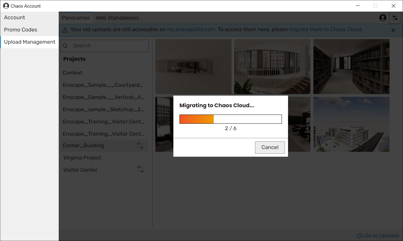

After this step, Migration to Chaos Cloud will start and you will be able to see the status bar for each upload.
Migrating to Chaos Cloud

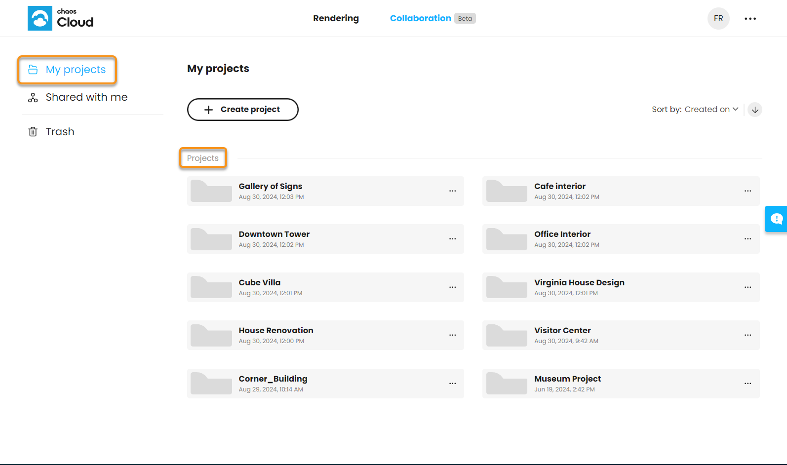

Create a Project
To start working with Chaos Cloud collaboration, you first have to create a project. Projects help you organize your files and folders. If you have created Panoramas and Web Standalones for your projects using Enscape 4.1.1 onwards, or migrated them through Enscape, you would be able to see those project folders already on your Cloud Account.
To create a new project directly on the Cloud, press the Create project button, choose a name for your project and you can start uploading files to that project folder.

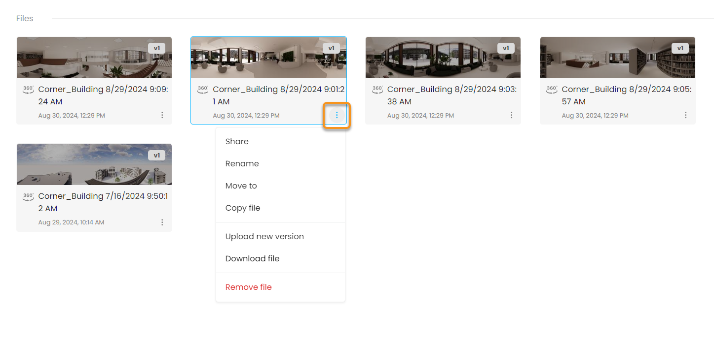

You can sort the files by date created, name, or by date the file was modified. Additionally, there is always a Content Menu (the three dots) option available for each item, no matter what Type the item is:
Content Menu
File Content Menu

You can upload additional versions for the file. Press the three dot menu on the image and select the Upload new version. Alternatively, use the plus button in Present mode and choose Version. Once you upload the new version, you can still access the previous one(s).
Open the file in Present mode and at the center top find the drop down menu. You can see a list of all available versions for this file.
Press the Compare versions button to view the images side by side, or compared with an A/B slider.
You can delete each of the versions from the delete icon. Once you open the file in Present Mode, there is a separate three dot menu. From there, you can access the File info option, which opens the Information panel. This panel contains information about the date of creation, size, format and creator of the file.

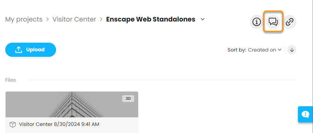

Collaborators can leave comments on folders and files. For files, once opened in Present mode, find the comments icon. With the blue comment icon that appears upon hovering the image, you can select the specific spot where to leave the comment.
You can add one or more image attachments to your comments, which users can view in a large gallery while reading the comment section. You can also add visual annotations to image files.
You can add a rectangle, arrow, line, or a free drawing with different color options to communicate visually over your files.
You can resolve comments by using the green check button . Resolved comments have a separate tab, where you can find them, and if needed, Reopen them using the similar icon.
In folders, find the comments icon at the top right corner of the page.
Comments Icon

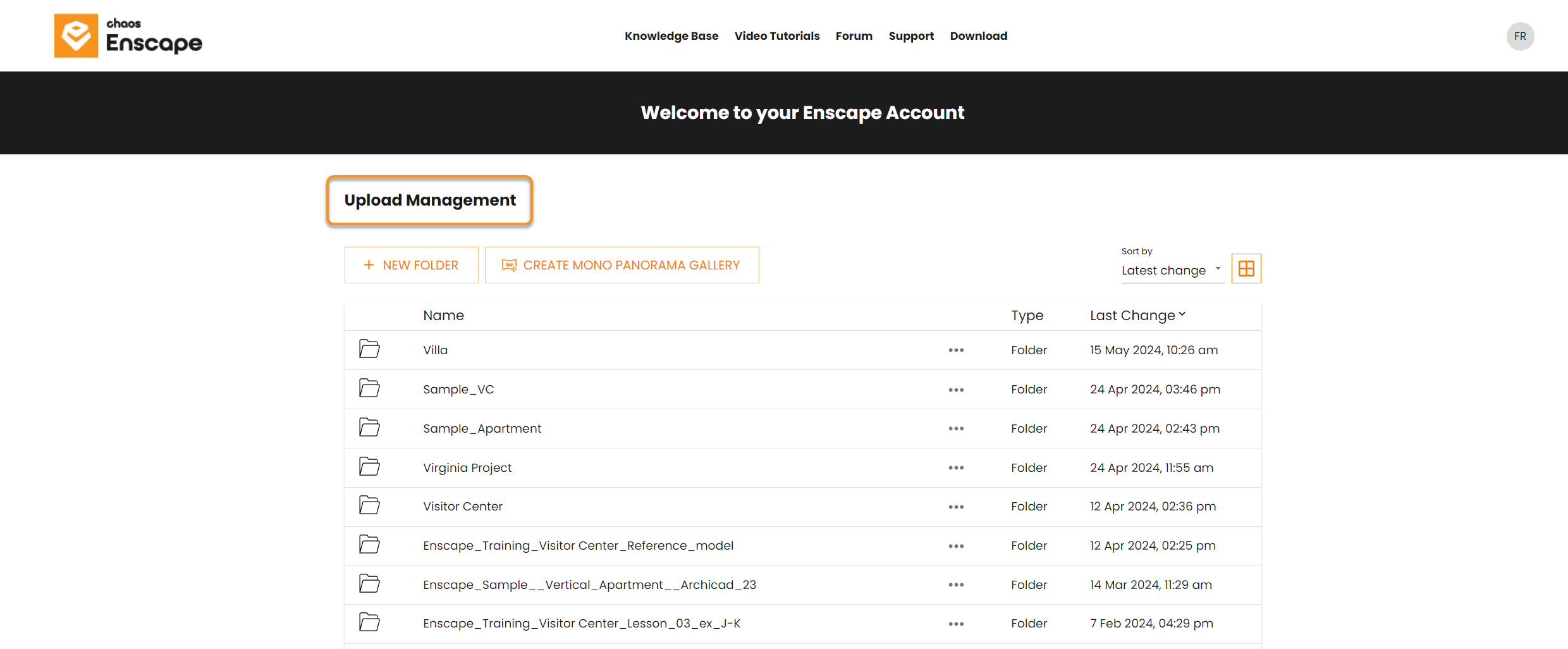

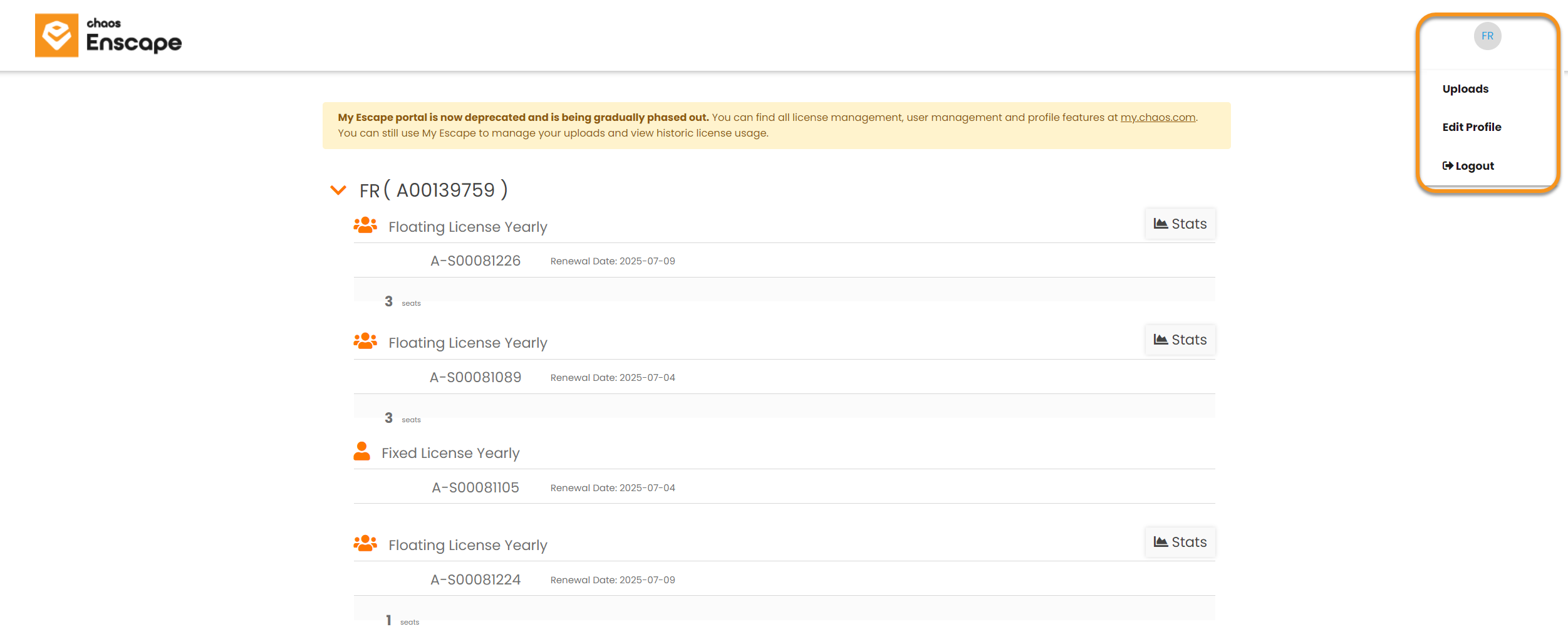

Once you have set up an account, log in to the Enscape Account and then select the Uploads option from the drop-down menu available at the top right-hand side of the page.
You will see the following menu options:
Enscape Account showing the Menu options, including Uploads
Existing Enscape users will be by default see the historic license usage overview. They can click Uploads from the menu on the top right. Whereas, new users will, by default after logging in, be taken directly to the Uploads folder.
Upload Management
Notice that there is a Type column for each item listed and these are the object Types that can managed:
  • Folder
  • Panorama Mono
  • Panorama Stereo
  • Panorama Gallery
  • Web Standalone
The top level is made up of all types as ‘Folder’. These are the different CAD project folders you uploaded types for using this account. If we click on one of these Folder items it will show the contents of that project folder, which could be any of the types listed above.

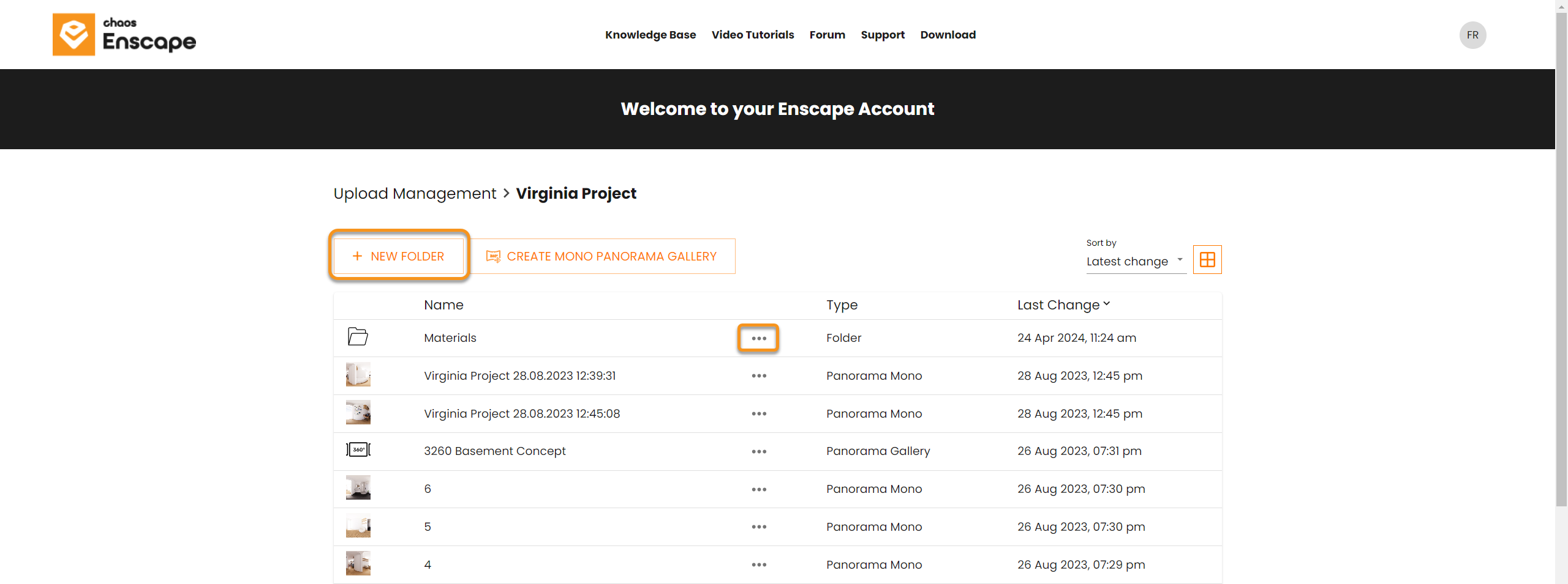

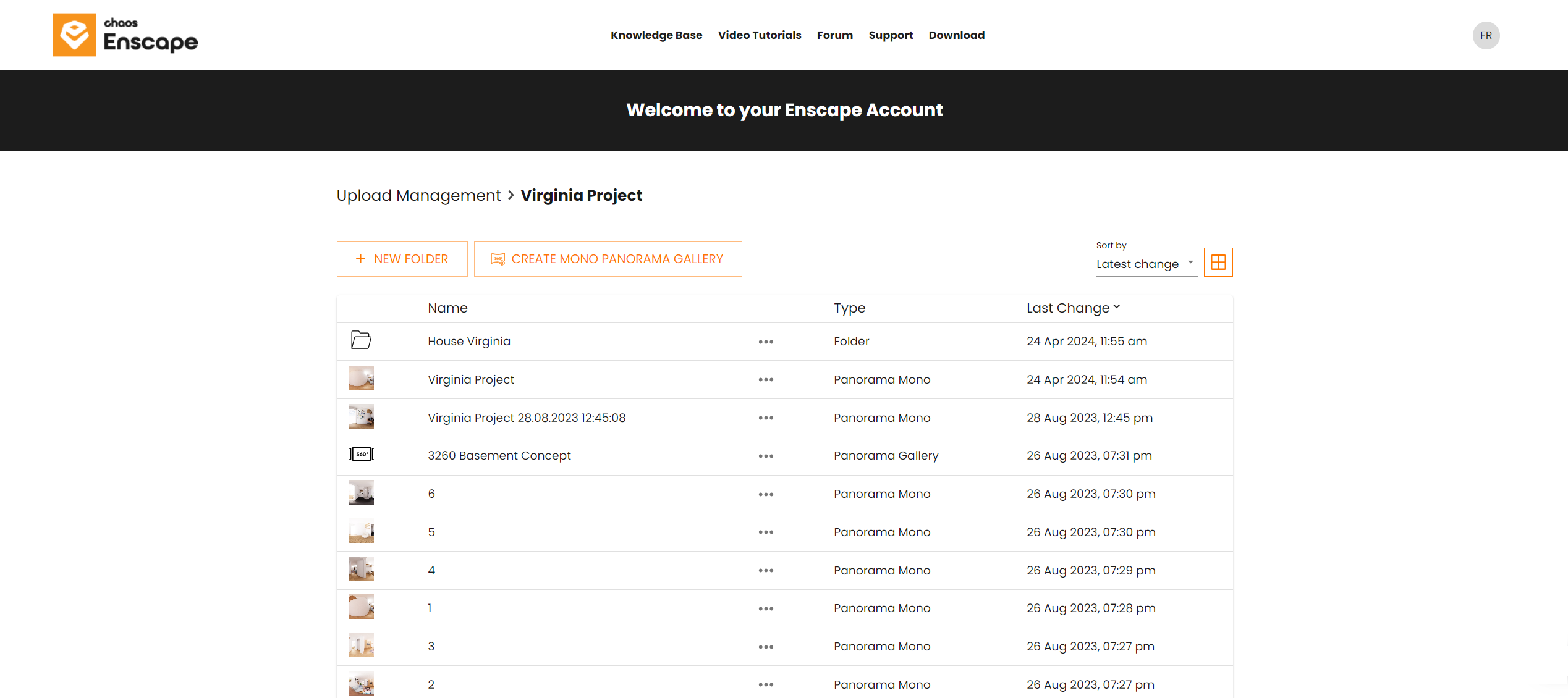

Contents of a Folder
If an item in a folder is of Type Panorama, you can directly click on it to open and view the Panorama itself in a new browser tab / window. The same process is applied where a Type WebStandalone may be listed.
There is no limit to how many items you can place inside a Folder. Note, that you can also add another folder within a folder via the ‘New Folder’ button to create sub-folders. Click the black arrow button at top left to return to the Parent Folder.
New Folder and Context Menu buttons
This Context Menu is accessed via the 3 dots button and provides the following options:

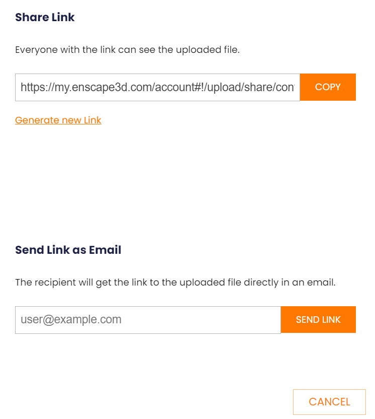

Clicking on the Share Options button will show the following popup:
Share Options
You can either use the Copy button to copy the URL which can then be pasted into an email or document.
Or, you can send the URL link directly to an email address by adding the recipients email address and clicking the Send Link button.
In cases where you have a previously shared an item, but want to quickly limit the access to that item, you can then click the Generate new Link option, which will show the following message:
Generate a new link
Click the Generate button to finalize the change of the URL. You should notice that the URL changes and a small notice will be shown in green text stating ‘New link created!’ which confirms the change was successful.
This function will help you to manage access to Panorama and Web Standalone files you have previously shared.
Generation of a new link was successful

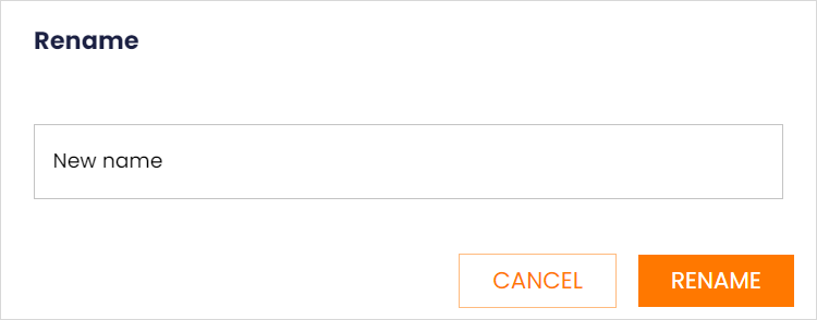

Rename
Selecting the Rename option provides a dialog to allow the renaming of a file. This field can not be left empty.
Once filled out, click the Rename button to complete the process.

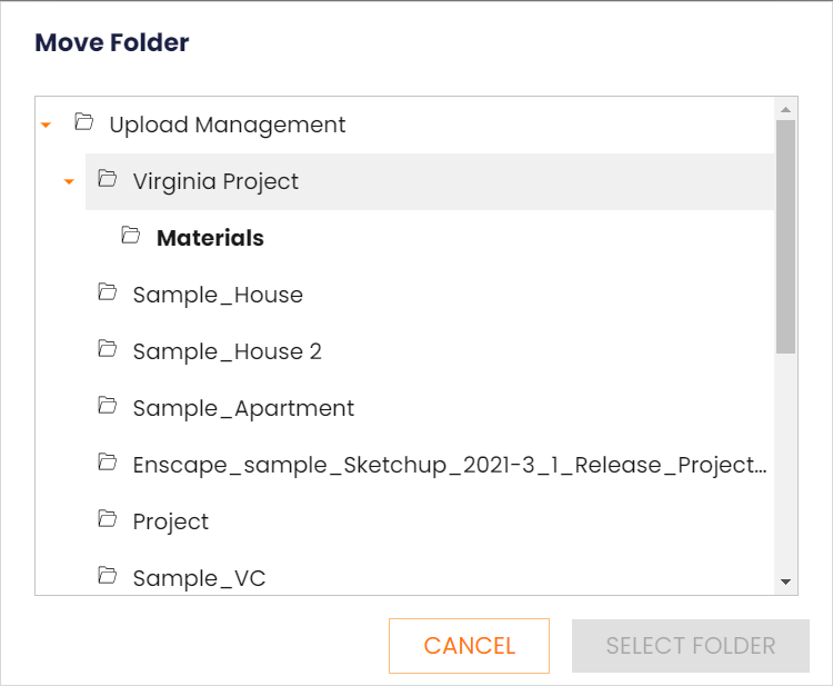

Move
Selecting the Move option will result in a dialog opening where the whole folder structure the user has created will be displayed. This allows  you to select the location you’d like to move the item to. The item you are wanting to move is always shown in bold text.
Once you’ve chosen the new location from the list, the Select Folder button will turn orange, meaning its now available to click on. Click on it to complete the process and the folder structure will be changed accordingly.
Move item dialog

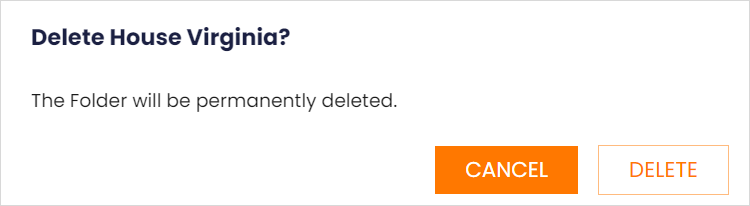

Delete
Lastly, the Delete option will prompt you to confirm deletion before proceeding to remove the selected item completely.
In a case where a user is deleted and the license rights removed, or if a user lost access to their machine, the deletion of Panoramas from that user account can be requested by the account admin directly to Enscape
Delete an item
