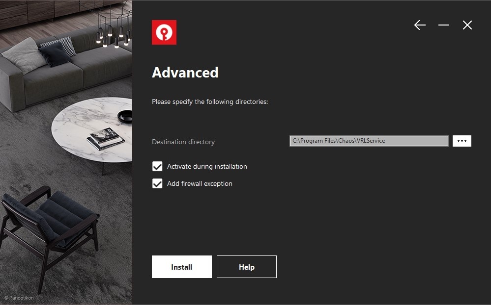

By default, the License Server installer adds a firewall exception to your system's settings. If you have opted to disable this setting while installing, or you have manually removed the firewall exception after the installation, this might prevent the License Server from establishing a connection. You can either re-install the License Server and make sure the option Add firewall exception is enabled in the installer, or you can manually add a firewall exception to your system's settings.
Re-install the License Server
Re-install the License Server and make sure the option Add firewall exception is enabled. This option can be changed by clicking Customize after agreeing to the License Agreement but before installing.
Windows installer with "Add firewall exception" option enabled

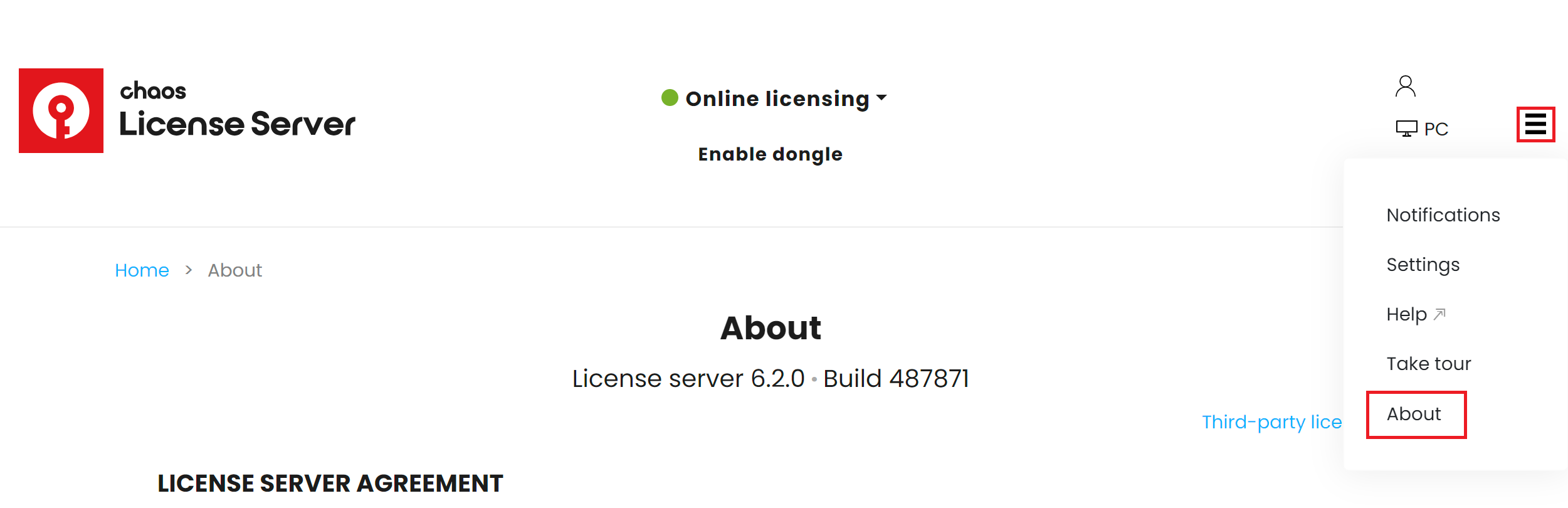

About License Server information
Find information about the License Server version you use, as well as the full End-User License Agreement and third-party licenses from the Hamburger () menu of your local host: http://localhost:30304/#/about
