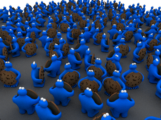

Set Up the Render
You should see something like this in the viewport:
 Add a VRay Dome Light to the scene and render.
The result should be like this:

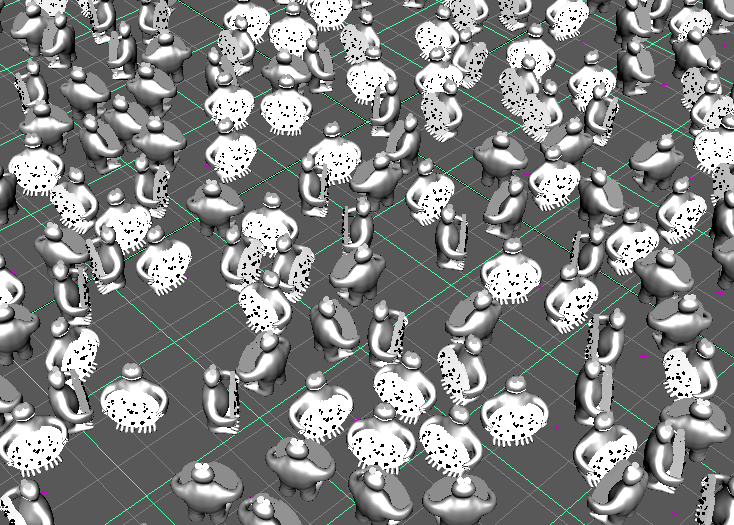

Part III: Adding Multiple Archives

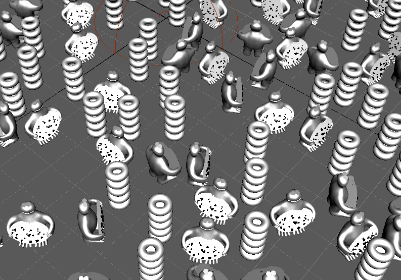

More than one archive can be instanced in the same XGen description. Here is an example with a second archive.
And let's see how this looks in the viewport.
And when rendered it should look like this.

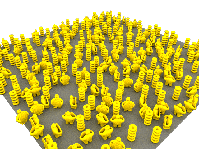

Part IV: Per Patch/Description Materials
A material can be assigned to a patch/description and all archive instances can be forced to use that material.
Select the description from the Outliner and right click in the viewport > Assign New Material.
To make everything yellow we can assign a VRayMtl to the description and tick the Use Per Patch/Description Material For Archives option from the VRay settings in the Preview/Output tab:
There may not be a change in the viewport, but when rendered it should look like this:

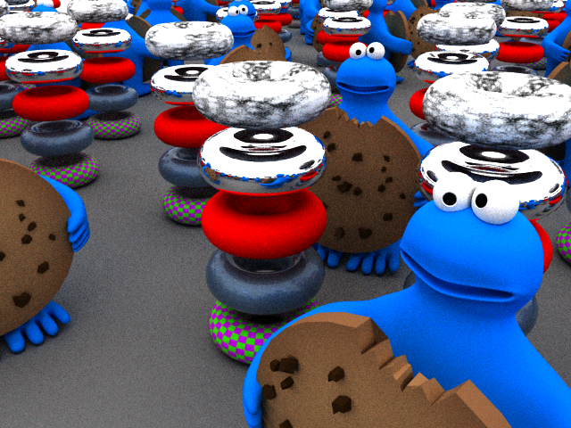

  1. Projected textures can be used too! Here is an example with a projected file texture instead of the yellow diffuse color:

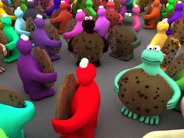

Part V: Shading Archive Instances Uniquely
Archive instances can be shaded uniquely through the use of Custom Shader Parameters. Unlike XGen Hair there are no specified/hardcoded names for such parameters - colors and floats with any name can be used with VRay User Color and VRay User Scalar and can be plugged to anything.

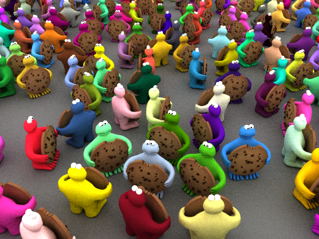

Here we will get rid of the tori archive and make each cookie monster body with a unique random color.
Add a V-Ray User Color Map
Disable the Use Per Patch/Description Material For Archives option from the VRay settings in the Preview/Output tab.
Since the materials for the archive have been imported we can select the cookie_monster:body_blue material and attach a VRay User Color to the Diffuse Color.
Give User attribute name "body_color" as a value (or whatever name you like - It should just match the name of the parameter we will add later).
Add a Custom Shader Parameter
Go to the Preview/Output tab of the XGen window and scroll down to the Custom Shader Parameters section.
Add body_color as type color like so.
Randomize the Color with an Expression
Go to the expression editor for the new attribute.
Set the following expression:
[rand(0,1), rand(0,1),rand(0,1)]
And when rendered it should look like this:

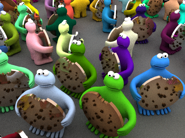

Add a V-Ray User Scalar Map
To render each cookie with a random amount of reflectivity we can create a VRay User Scalar and plug it to the Amount of the reflection of cookie_monster:BrownMtl.
Set the Reflection Color to white so that the Amount dictates the reflectivity.
Set the User attribute name of the VRay User Scalar to something like "reflectivity".
Randomize the Reflectivity
Add a custom shader parameter of type float.
Set the expression of the new parameter to the following:
rand(0,1)
And when rendered it should look like this (with every cookie having different reflectivity):

  1. A texture map could be also used to drive the Custom Shader Parameters like explained in the XGen General page
  2. Here is another render with randomized refraction for the cookies instead of reflectivity

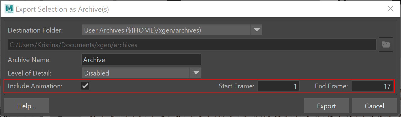

XGen can export an archive with animation within it from the export menu as shown below:
As an example here is the cookie monster with its eyes animated for 26 frames:
