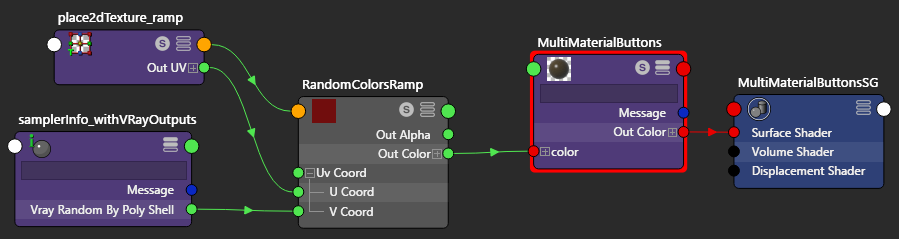

Example: Random Colors by Poly Shell
The SamplerInfo node, with the V-Ray Additional outputs in the Maya Hypershade, makes it possible to apply a random color (or texture) to multiple objects that have been combined into a single object. This is done by connecting the Vray Random By Poly Shell output to a ramp texture which is then connected to any texture channel in a material. This applies a different color (or texture connected to a color slot in the ramp texture) to each poly shell within a scene.
In the example rendering below, the switches, sliders, and buttons in the bottom part of the image have been combined into a single object. As such, Vray Random By Poly Shell will apply a different color randomly to each poly shell within the object.
Vray Random By Poly Shell controlling the V coordinates of a V Ramp with Linear interpolation.
The V coordinates of a V Ramp with Interpolation set to Linear.

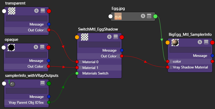

The Maya SamplerInfo node, with the V-Ray Additional outputs in the Hypershade, makes it possible to control which geometry casts shadows on other geometry within a scene. With this method, you control the casting and receiving of shadows via the VRaySwitchMtl material and Object IDs for the various objects.
For the object that is casting shadows on other objects:
  • Assign the shadow-casting object an Object ID of 0.
  • In the material for this object, add Material Attributes and choose V-Ray Material Override as the type. This makes the Shadow Material slot available for the material.
  • Create a VRaySwitchMtl material, and connect the Materials Switch attribute to the Vray Parent Obj IDTex output of a SamplerInfo node.
  • Place this VRaySwitchMtl within the Shadow Material slot.
For objects that could potentially receive shadows from the shadow-casting object in the scene, assign an Object ID of 1 to geometry objects that you want to receive shadows, and an Object ID of 0 to geometry objects that you do not want to receive shadows. No special material is required for these objects.
In the example below, the V-Ray Switch material set up for shadow control is assigned to the topmost egg. By setting different Object IDs for other objects in the scene, shadows cast by the topmost egg can be limited to certain objects.
For more details, see the Controlling Shadows Using the Sampler Info Node page for a step-by-step tutorial.

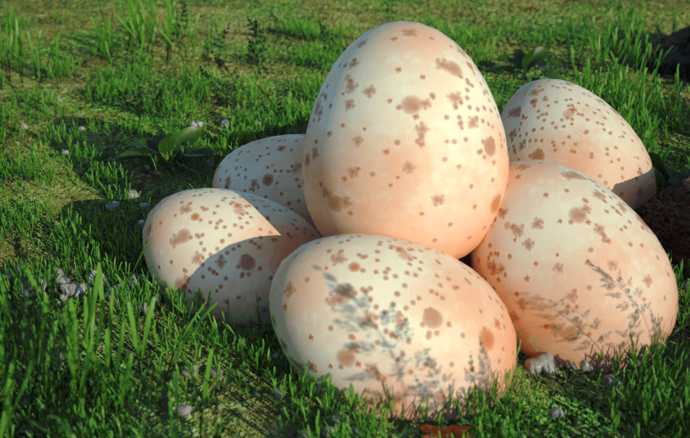

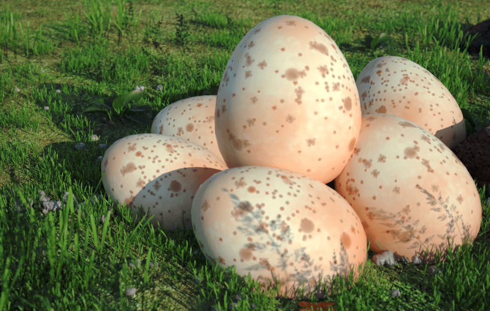

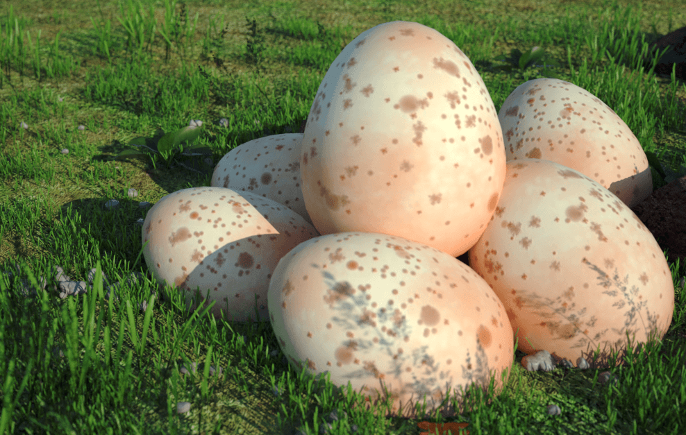

No Switch Material used.
Topmost egg casts shadows on other eggs and grass.
Eggs in grass have Object ID of 0, grass has Object ID of 1.
Topmost egg casts shadows on the grass but not on the other eggs.
Eggs in grass have Object ID of 1, grass has Object ID of 0.
Topmost egg casts shadows on other eggs but not on the grass.

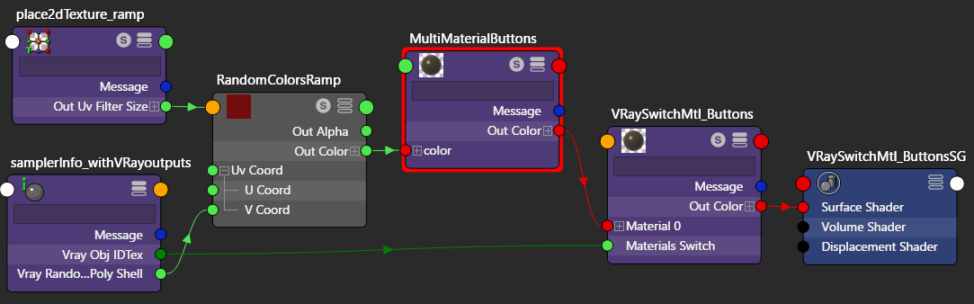

Example: Random Colors with Switch Material
The SamplerInfo node with the V-Ray Additional outputs, in Maya Hypershade, makes it possible to apply a random color (or texture) by connecting the Vray Obj IDTex output to the Material Switch channel on a VRaySwitchMtl.
Vray Obj ID Tex controlling the V coordinates of a V Ramp with Linear interpolation.
Notice how the colors produced can be anywhere between the different colors in the gradient.
Vray Obj ID Tex controlling the V coordinates of a V Ramp with Interpolation set to None.
Notice how the colors produced are only the colors set in the gradient.
The V coordinates of a V Ramp with Linear interpolation.
The V coordinates of a V Ramp with Interpolation set to None.
