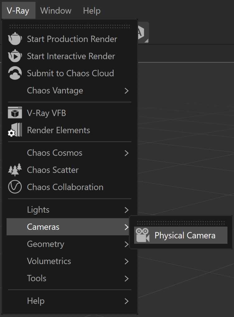

UI Path: V-Ray menu > Cameras > Physical Camera
UI Path: V-Ray Toolbar > Physical Camera

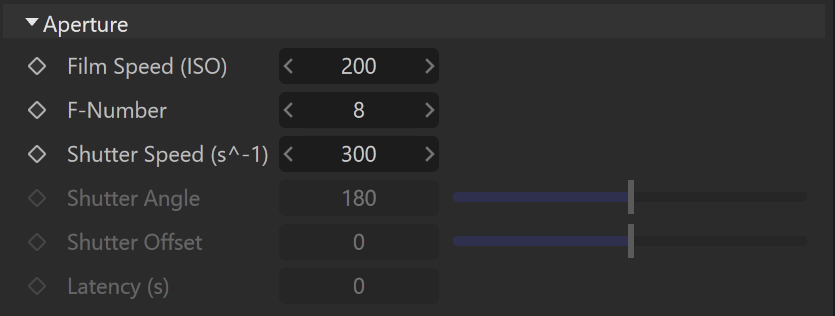

Aperture
Film Speed (ISO) – Determines the film power (i.e. sensitivity). Smaller values make the image darker, while larger values make it brighter. See the Film Speed (ISO) example for more information. This option is not available for V-Ray GPU.
F-Number – Determines the width of the camera aperture and, indirectly, exposure. If the Exposure option is set to Physical Exposure or Exposure Value, changing the F-number affects the image brightness. See the F-Number example below for more information.
Shutter Speed (s^-1) – Specifies the shutter speed, in inverse seconds, for the Still Camera Type. For example, shutter speed of 1/30 s corresponds to a value of 30 for this parameter. See the Shutter Speed example for more information.
Shutter Angle Specifies the shutter angle (in degrees) for the Movie Camera Type.
Shutter Offset – Specifies the shutter offset (in degrees) for the Movie Camera Type.
Latency (s) – Specifies the CCD matrix latency (in seconds) when the Camera Type is set to Video. This option is not available for V-Ray GPU.

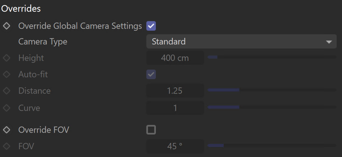

Overrides
These options override the values entered in the Camera Overrides tab of the Render Settings for the current camera.
The Overrides are applied to the camera only when the General > Use Physical Camera option is enabled.
Override Global Camera Settings – Enables the per-camera override options. The rollout is grayed out if this option is disabled.
Camera Type – Types of cameras available in V-Ray. Depending on the camera type, different options become available in the rollout. You may set the current camera to be overridden by selecting one of the following:
Standard – Allows for the current scene camera to be used (usually a pinhole camera).
Spherical – A camera with a spherically shaped lens.
Cylindrical (point) – This camera casts all rays from the center of a cylinder. In the vertical direction, the camera acts as a pinhole camera, and in the horizontal direction, the camera acts as a spherical camera.
Cylindrical (ortho) – This camera casts all rays from the center of a cylinder. In the vertical direction, the camera acts as an orthographic view, and in the horizontal direction, the camera acts as a spherical camera.
Box – Six standard cameras placed on the sides of a box. This type of camera is excellent for generation of environment maps for cube mapping and generates a vertical cross format image.
Fish Eye – This special type of camera captures the scene as if it is a pinhole camera pointed at a 100% reflective sphere that reflects the scene back into the camera's shutter, as with using a light probe in HDRI photography. You can use the Distance and FOV settings to control which part of the sphere is captured by the camera. Note that the virtual reflective sphere has always a radius of 1.0.
Warped Spherical (old-style) – A spherical camera with slightly different mapping formula than the Spherical camera.
Orthogonal – An orthographic camera enabling flat, non-perspective views.
Pinhole – Overrides the scene camera to force it to be a pinhole camera.
Spherical Panorama – Spherical camera with independent horizontal and vertical FOV selection that is useful for generating lat-long images for spherical VR use.
Cube6x1 – A variant of the Box camera with the cube sides arranged in a single row. Unlike the Box camera's output, Cube6x1 does not produce an empty space in the output image and is quite useful in generating cubic VR output.
Height – Specifies the height of a Cylindrical (ortho) camera.
Auto-fit Controls the auto-fit option of the Fish Eye camera. When enabled, V-Ray calculates the Distance value automatically so that the rendered image fits horizontally with the image's dimensions.
Distance – Determines the focal distance of the Fish Eye camera. We recommend using the Auto-fit option for a fast, realistic look.
Curve Controls the degree of warping for a Fish Eye camera. A value of 1.0 corresponds to a real world fish-eye camera. Lower values increase warping, while higher values reduce warping. Technically, this value controls the angle at which rays are reflected by the virtual sphere of the camera.
Override FOVOverrides the Cinema 4D's camera FOV (field-of-view) angle. Some V-Ray camera types can take FOV ranges from 0 to 360 degrees, whereas the cameras in Cinema 4D are limited to 180 degrees.
FOV – Determines the new field of view for the current camera.

Film Speed (ISO) = 200
Move the slider to see the other images.
Example: F-Number
The F-Number parameter controls the aperture size of the virtual camera. Lowering the F-Number value increases the aperture size and so makes the image brighter since more light enters the camera. In reverse, increasing the F-Number makes the image darker, as the aperture is closed. This parameter also determines the amount of the Depth of Field (DOF) effect.
The images in this example show the effect of changing the F-Number. The following constant settings are used for some parameters: Exposure is set to Physical Exposure, Shutter Speed is 125, ISO is 100, Vignetting is 1.0, and White Balance is white.
F-Number = 2.8
F-Number = 4
F-Number = 5.6
