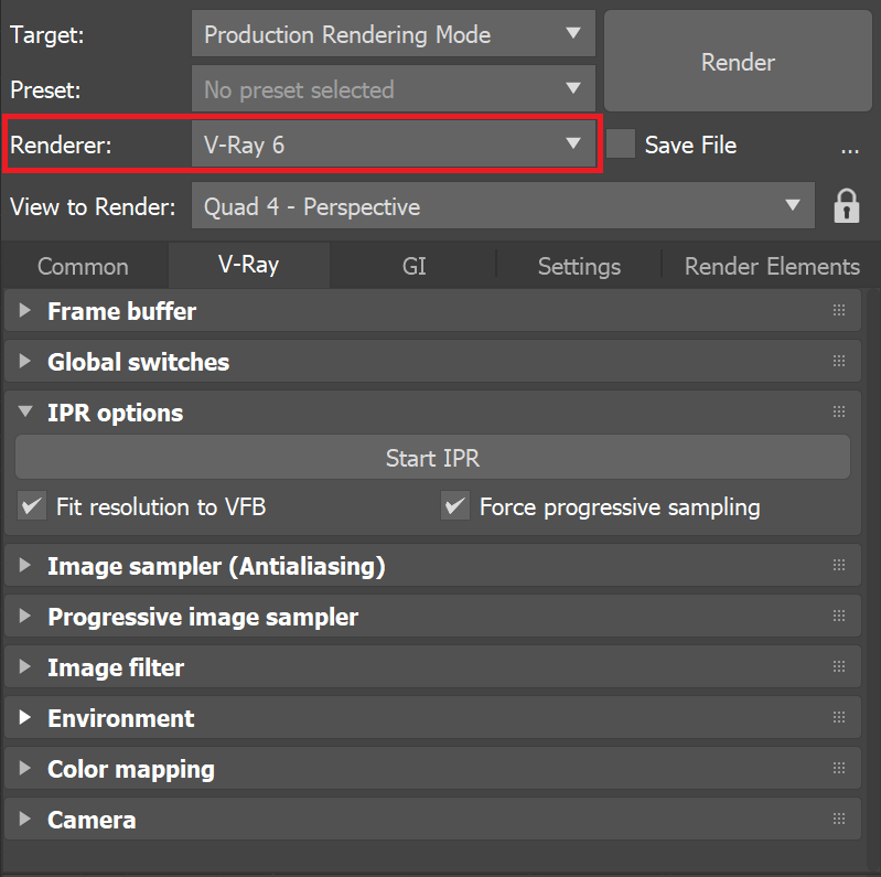

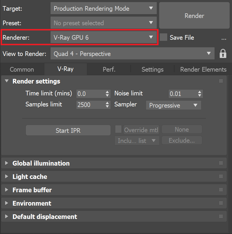

In the Render Setup window, make sure the render engine is set to V-Ray. To open the VFB, click the Last VFB button on the Toolbar, or go to the respective Render Setup rollout for V-Ray or V-Ray GPU engine.
When the Renderer is V-Ray, the IPR options rollout appears under the V-Ray tab.
When the Renderer is V-Ray GPU, the IPR options appear under the Render settings rollout of the V-Ray tab.

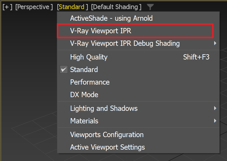

When the renderer is V-Ray, V-Ray Viewport IPR is accessible through the Shading menu of the Viewport
When the renderer is V-Ray GPU, GPU IPR is accessible through the Shading menu of the Viewport

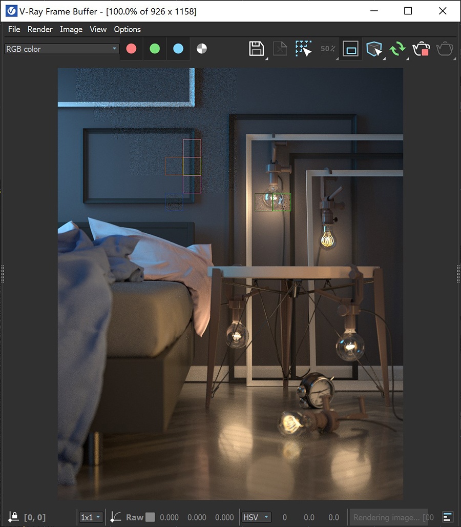

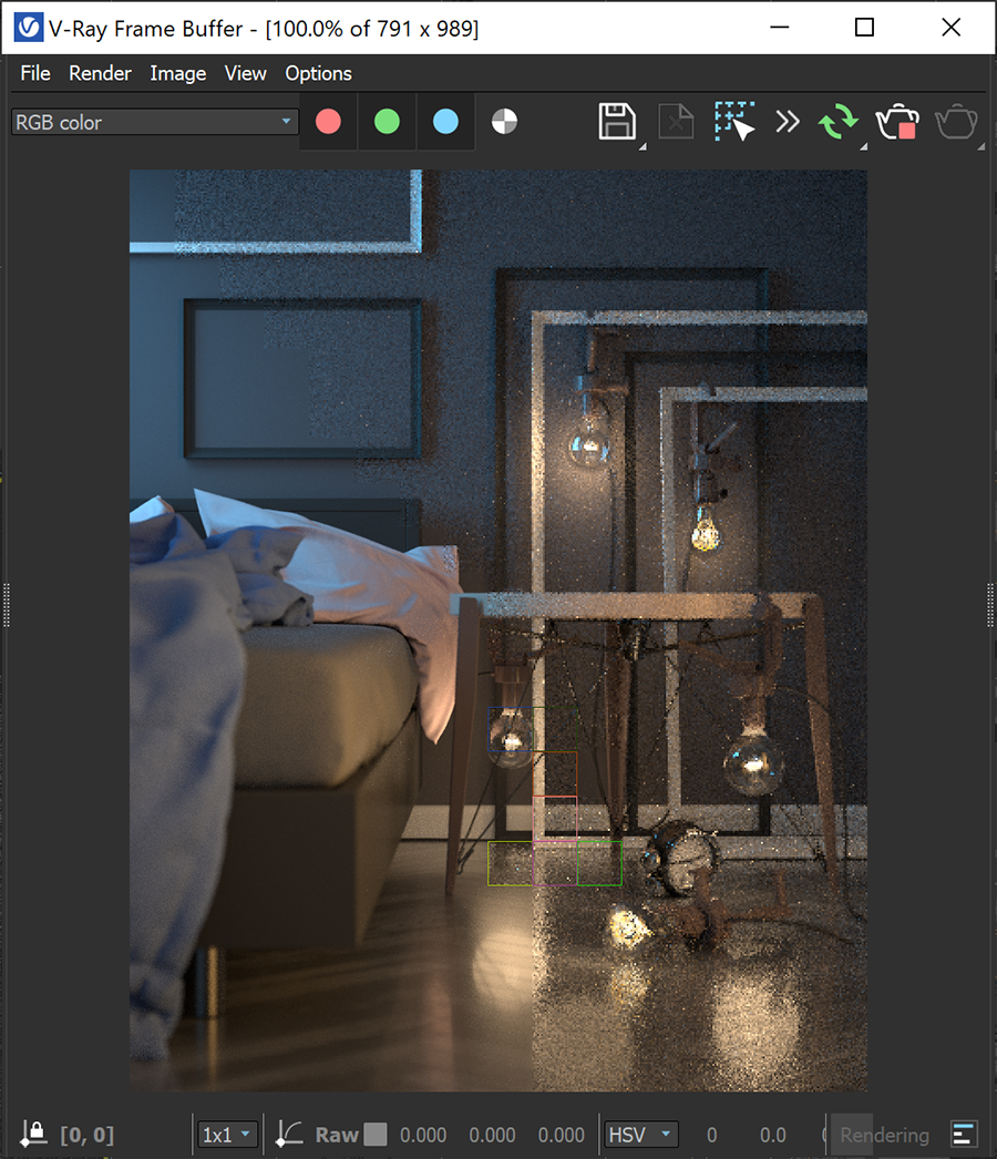

While IPR is running, if the Fit resolution to VFB option is enabled in the IPR options rollout, the render refreshes to fill the VFB when the VFB window is resized. The render output size also changes accordingly. The same setting for V-Ray GPU can be found in the V-Ray tab > Frame buffer rollout > Fit IPR resolution to VFB.
Rendering at Original Size (926 x 1158)
Rendering with VFB Resized (791 x 989)

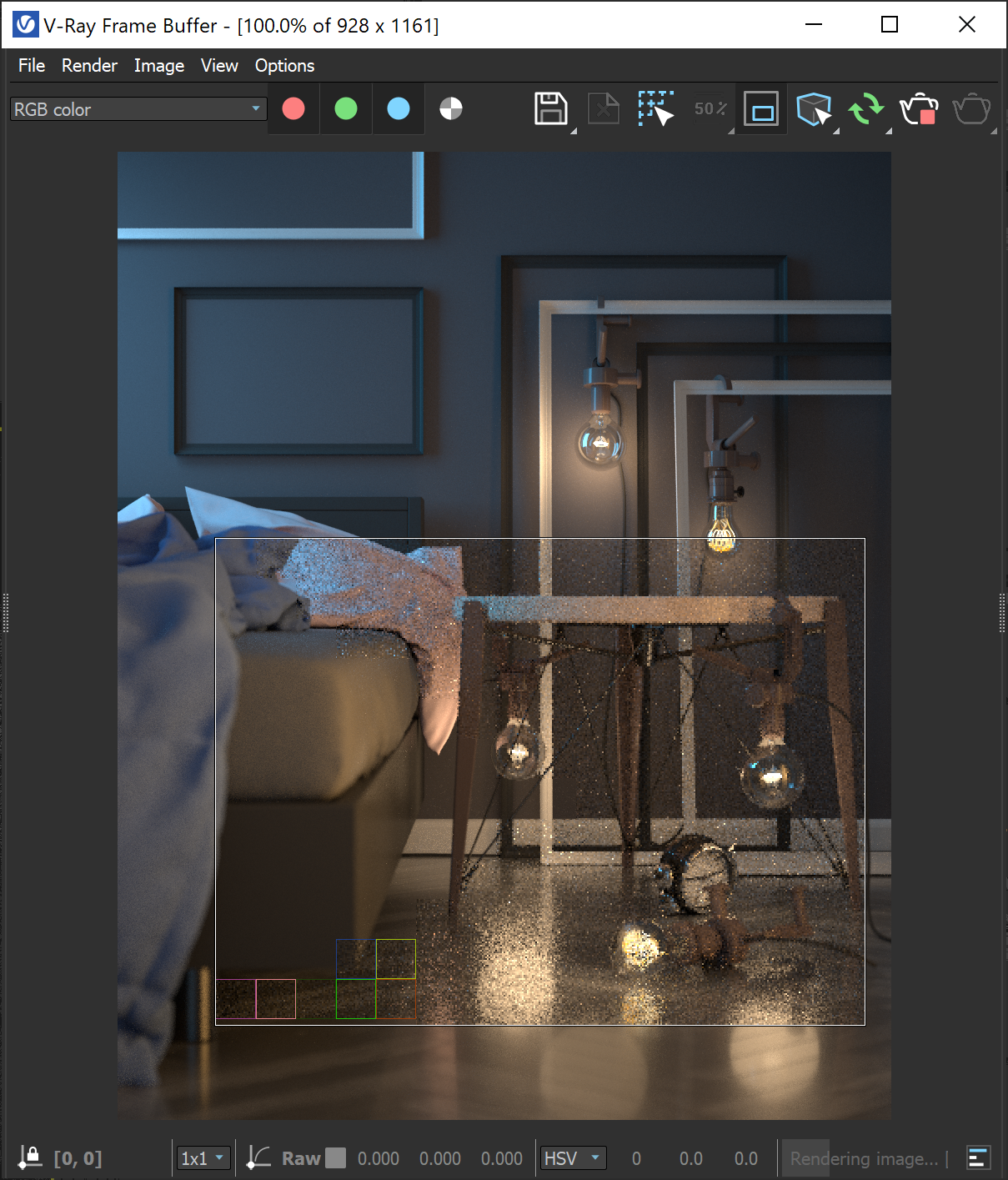

In addition, the IPR rendering refreshes whenever the Region Render area is redrawn.
Original Region Render
 IPR refreshes as the Region Render area is altered.

It is accessible from the ||Viewport menu|| > Shading > V-Ray IPR.
Viewport IPR uses the currently set render engine (V-Ray or V-Ray GPU).
You can stop the interactive rendering from the same menu. It also gives access to the Debug Shading options.
