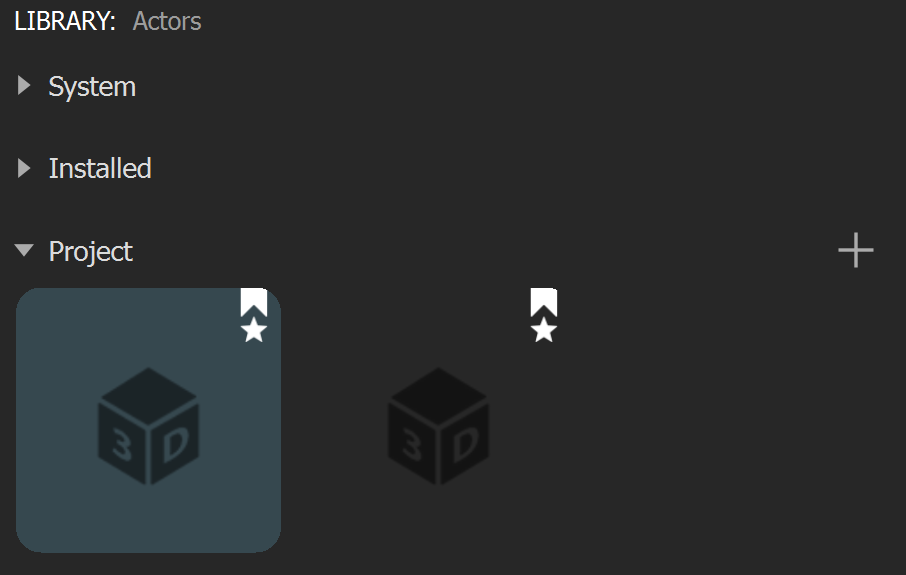

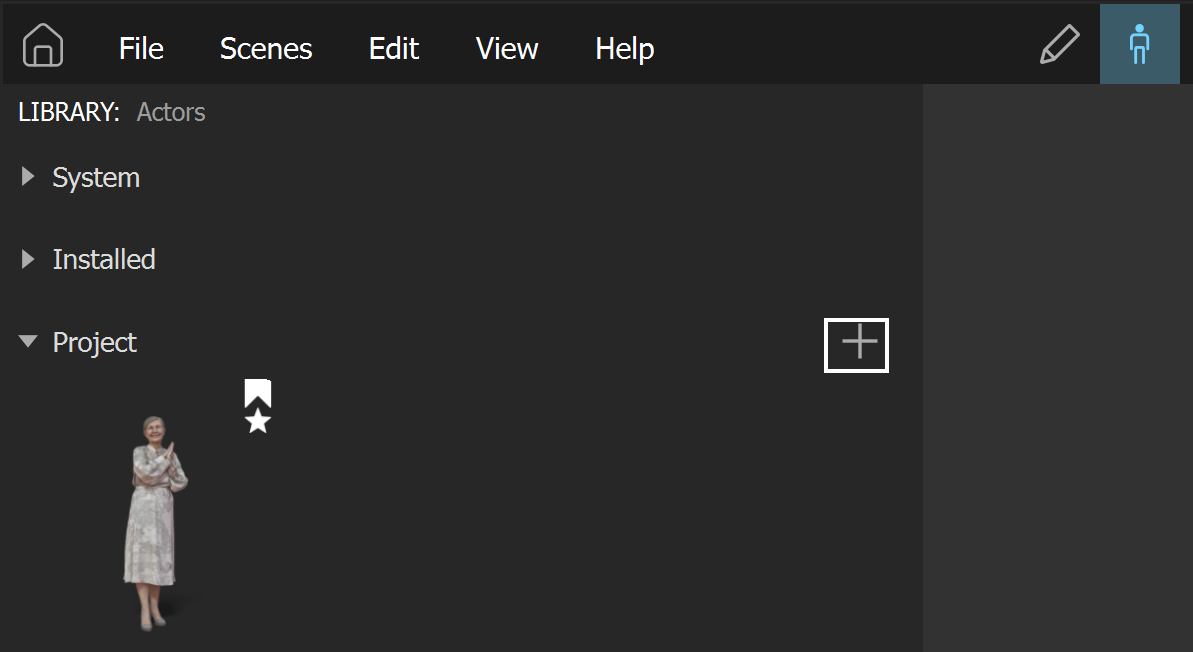

1. Open the Project to which you’d like to add Motion Clips and change the Anima UI Mode to Editing.
2. In the Motion Clips Library click the + button.
3. The Import Clip menu will open. Click on the Input File Picker and select an FBX file containing a motion clip on a correctly rigged skeleton. To import multiple FBX files, select all of them in the picker and click Open to continue.
