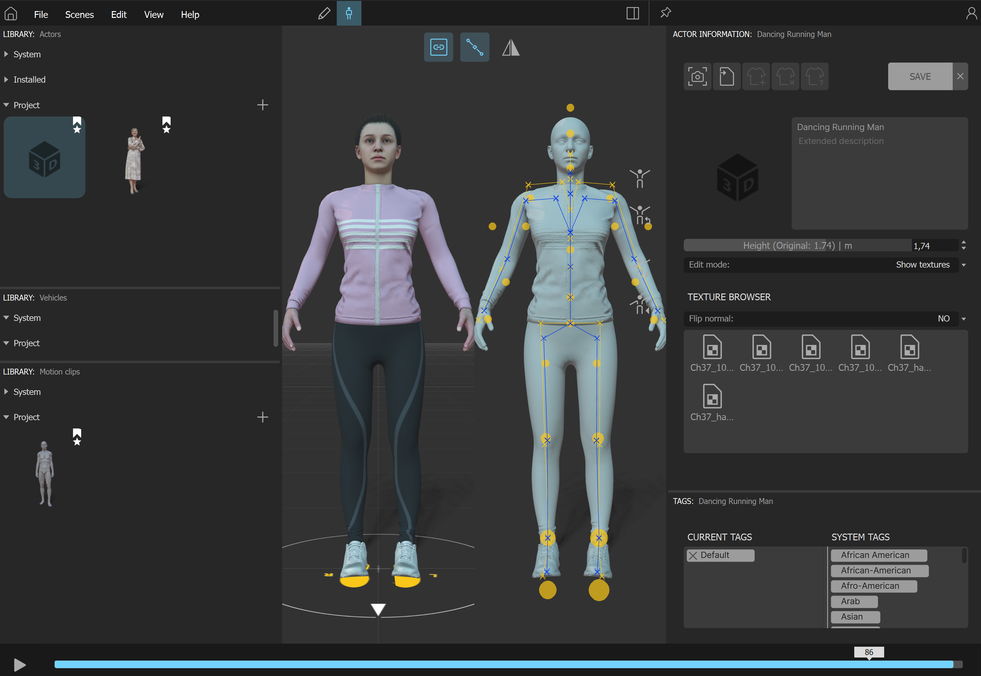

  1. Open the Project for new Characters and change the Anima UI Mode to Editing Mode.

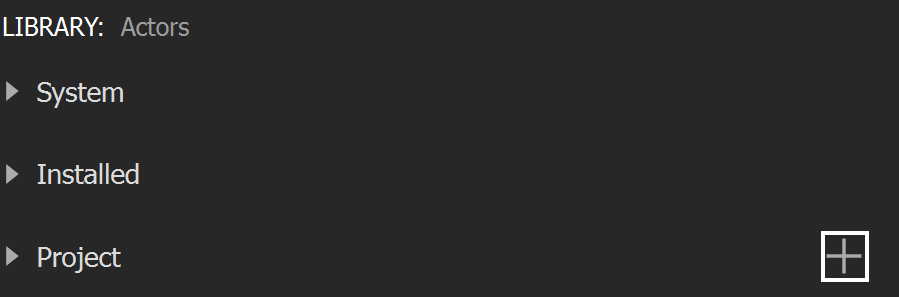

  2. In the Actors Library, at the Project tab click the [+] button on the right side to start the import process.

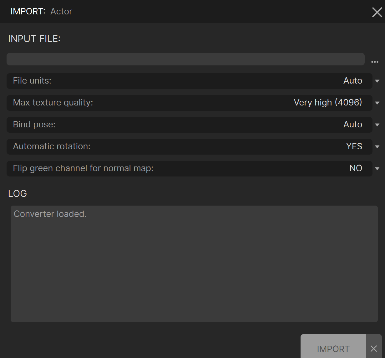

3.The Import Actor dialog will open. Click on the Input File three little dots on the right side of the filename field and browse to the FBX file of your model.
4. Select the file units to match your project units and the maximum texture quality of the model that you want to set.
5. On Static Models, you can ignore Bing pose and Automatic rotation options, those are only for Rigged models.
6. Click IMPORT to finish.

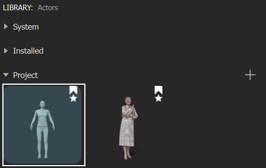

After a few seconds, your new character will now be available in the Actors Library, at the same Projects section.

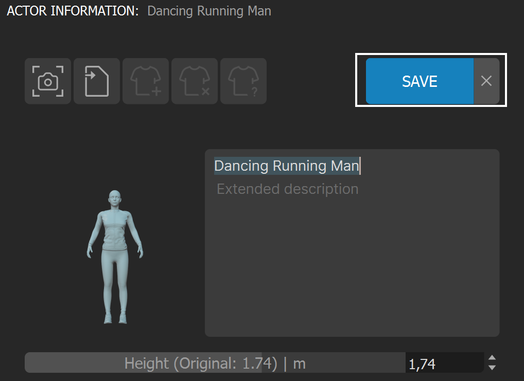

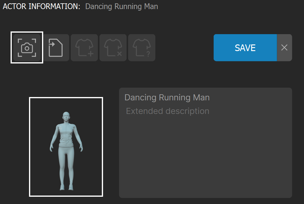

New characters don’t have a thumbnail yet. To generate one, go to the Actor Information panel and click the snapshot button to make it.
You can also add a Description or edit the Name from this panel. Click Save when you’re done to commit your changes.
You can add TAGs to your actor to keep your library organized and easily find it later using the search box of the Actors panel. More info about this on the following article Using Categories and Tags.
Now the thumbnail and the description will appear on the Projects section of the actor library, and your new character will be ready to use for any scene in the project with a simple drag & drop.

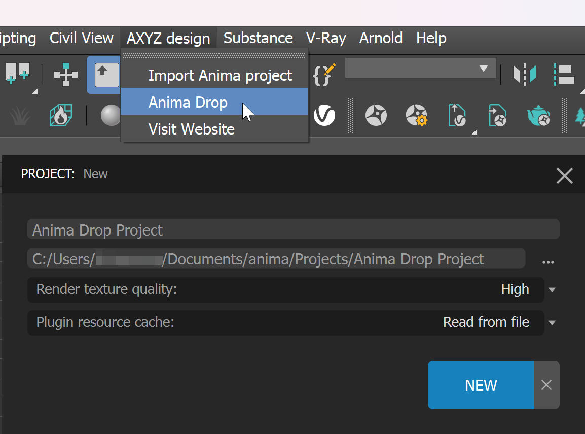

Please note that you can use the static Posed models both inside the Anima standalone application and directly inside 3ds Max, Maya, Cinema 4D, and Unreal Engine using the Drag and Drop gallery panel installed with the Anima plugins.

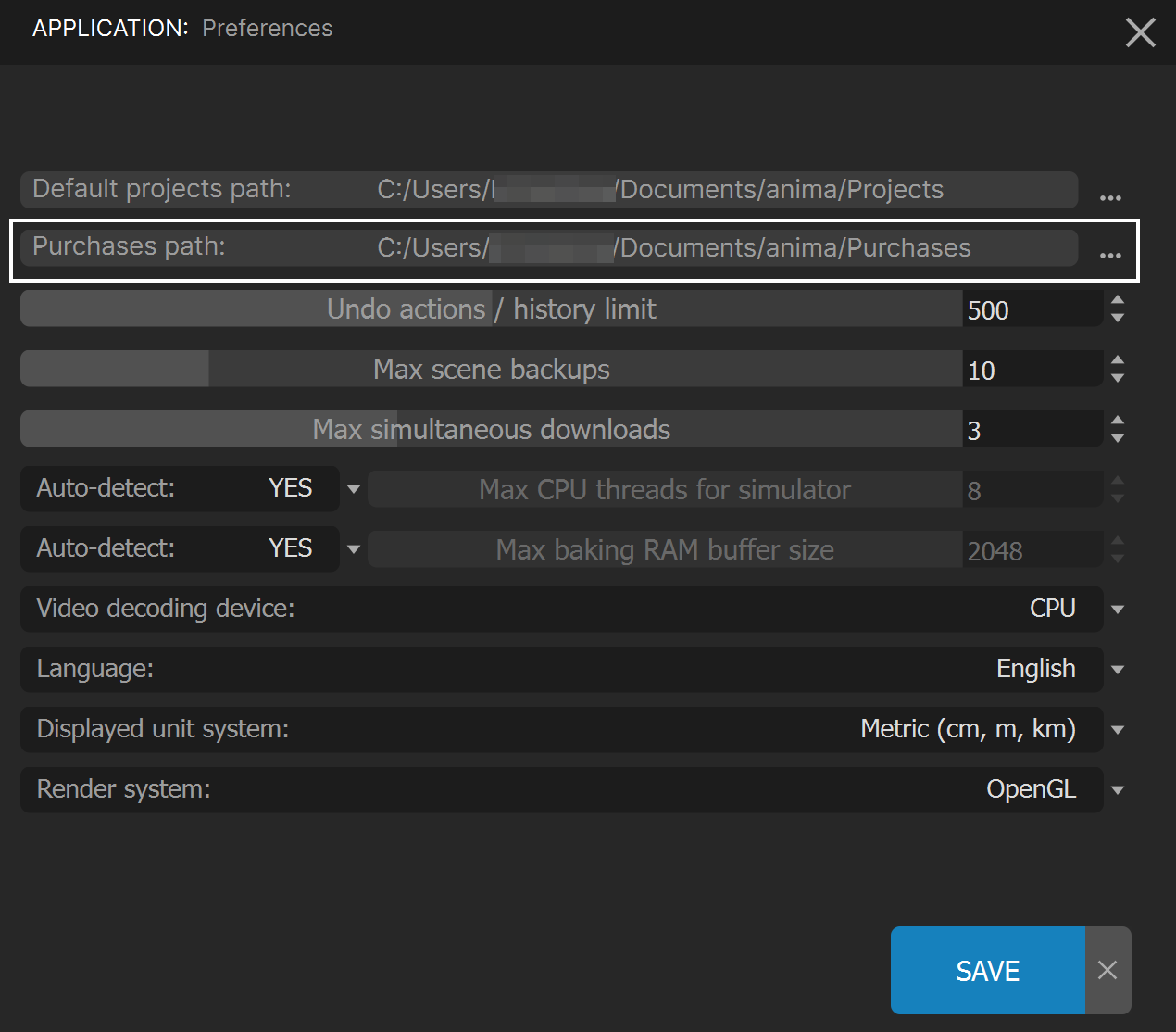

All the imported models are placed inside the library of your current Anima project (in the subfolder “<my_project>/libraries/models”). Once you finish importing this new static model, a new file with that name and the Anima native format extension (*.y) will be created there.
To make this file available to all your projects, copy this Anima file into the “models” subfolder of the “Purchases” folder that you have set up in Anima Preferences.
