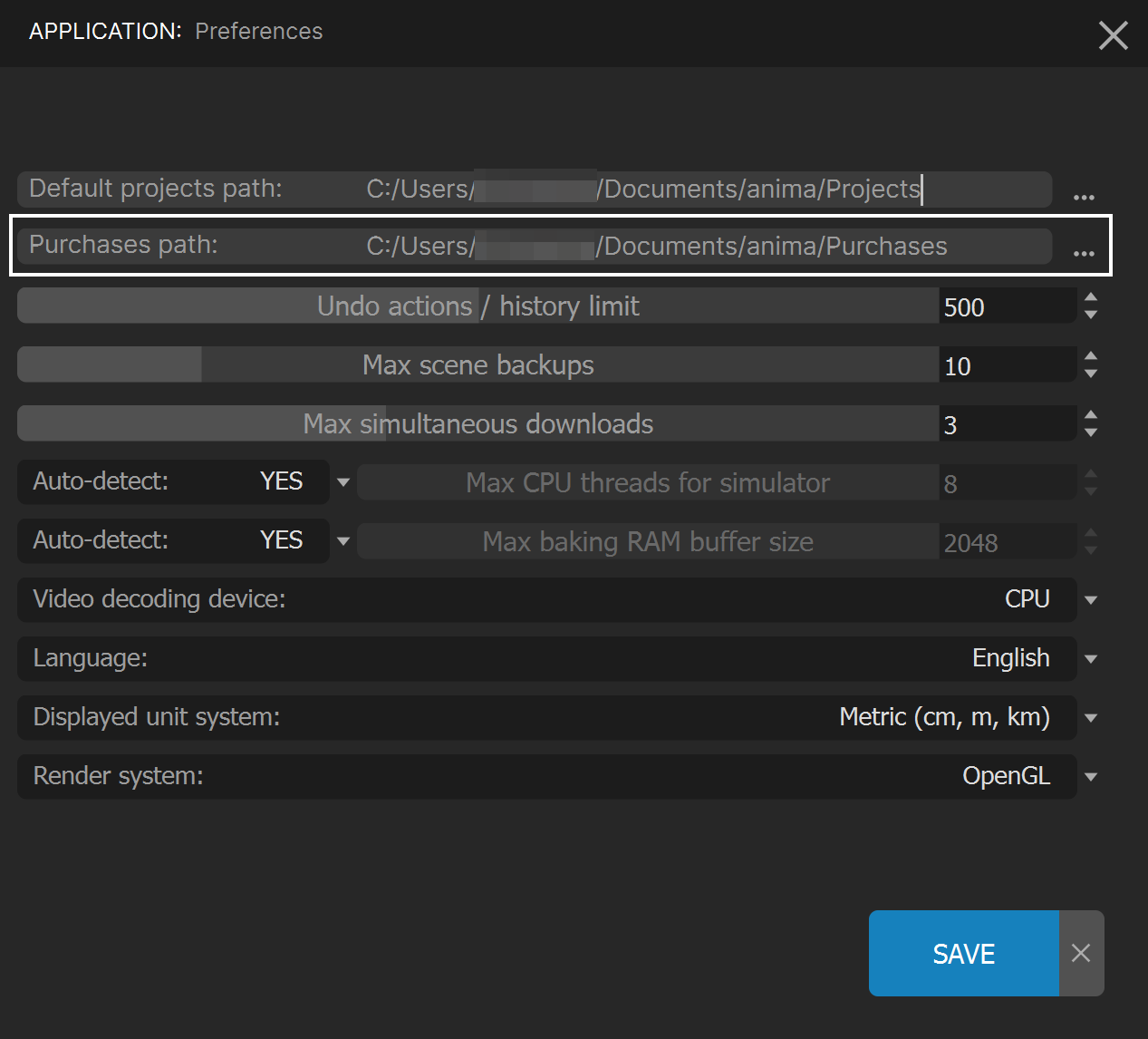

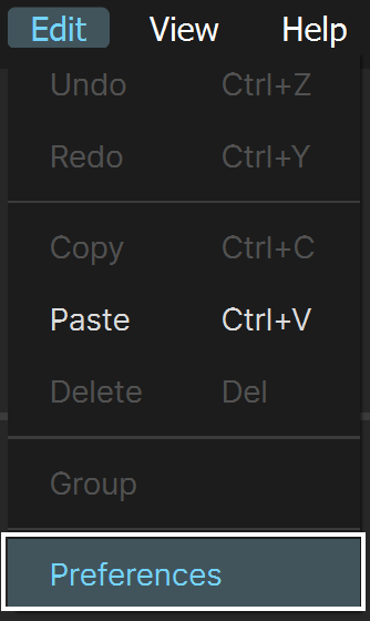

To set up the Purchases folder in the Anima Designer application, go to Anima Menu > Preferences:
Then, change the “Purchases” path to set a shared folder on your network. You can either edit the path field manually or browse to a path location using the […] button on the right side.
After that, all the content present in the folder will be moved to a new location automatically.

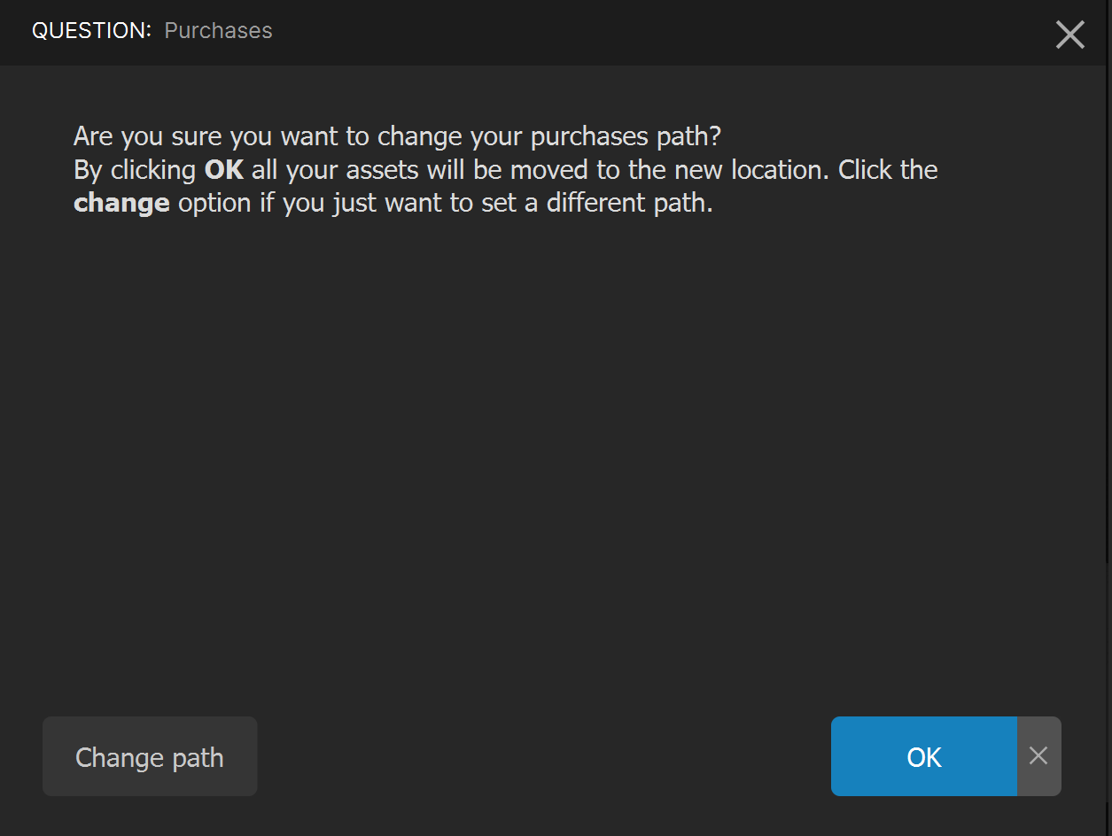

When you change your “Purchases” folder to another location and the current one already has some models, the dialog from the 2nd image below will appear. As you can read there, if you click the “OK” button, all the assets you have in your current “Purchases” folder will be moved to the new location. However, if you click “Change path” the new path will be set and saved in your preferences, but no assets will be moved nor overwritten. This way you can freely choose to let Anima handle the transference of the assets or manage it yourself.

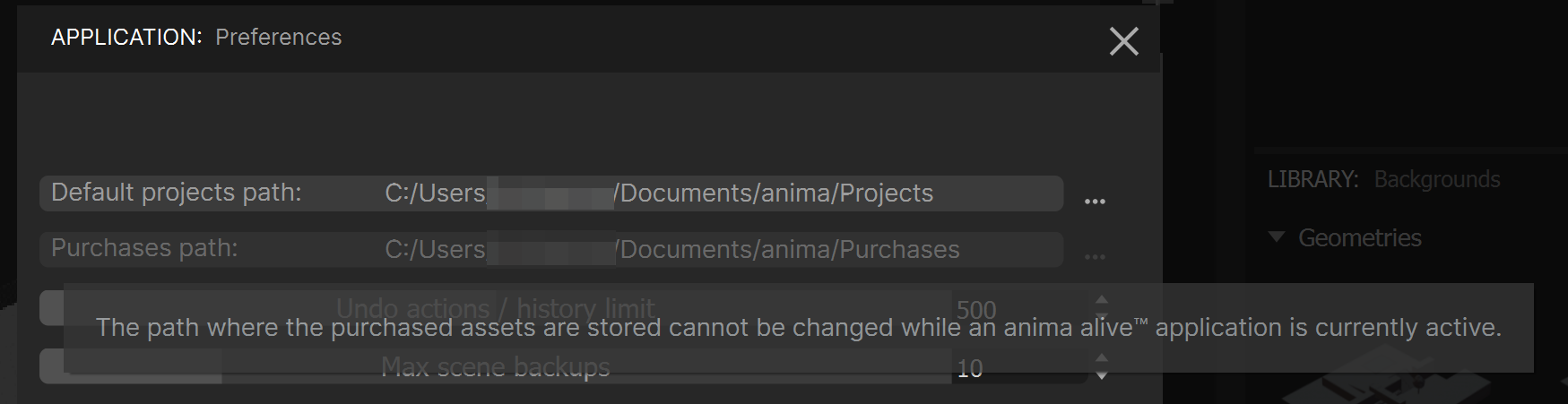

Notice that when the Anima Alive is active, the “Purchases” path is blocked on the preferences dialog. We added this limitation when we introduced Anima Alive to avoid library inconsistencies between the plugins and the core Anima application during the synchronization updates.
You only need to stop the Anima Alive to unlock it that field again by simply closing your 3D application or changing the currently opened scenes in either Anima or the plugin app.
