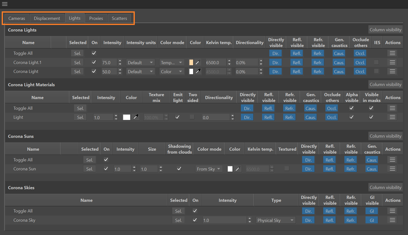

The Interface Tabs
Corona Lister consists of five main tabs:  Cameras,  Displacement,  Lights, Proxies, and Scatters.
Streamlined Control with "Toggle All"
In this row, you find buttons or checkboxes that allow you to make quick changes to all items visible in the lister. Buttons and checkboxes vary depending on the active tab in the Corona Lister. For example, in the Lights tab, there is an additional On checkbox to enable or disable all Corona lights, and in the Proxies tab, there is an additional dropdown Previz type button to change the display for all proxies visible in the Corona lister. Similarly, you can use the button in the Actions column to apply changes to all visible items in the Corona lister.

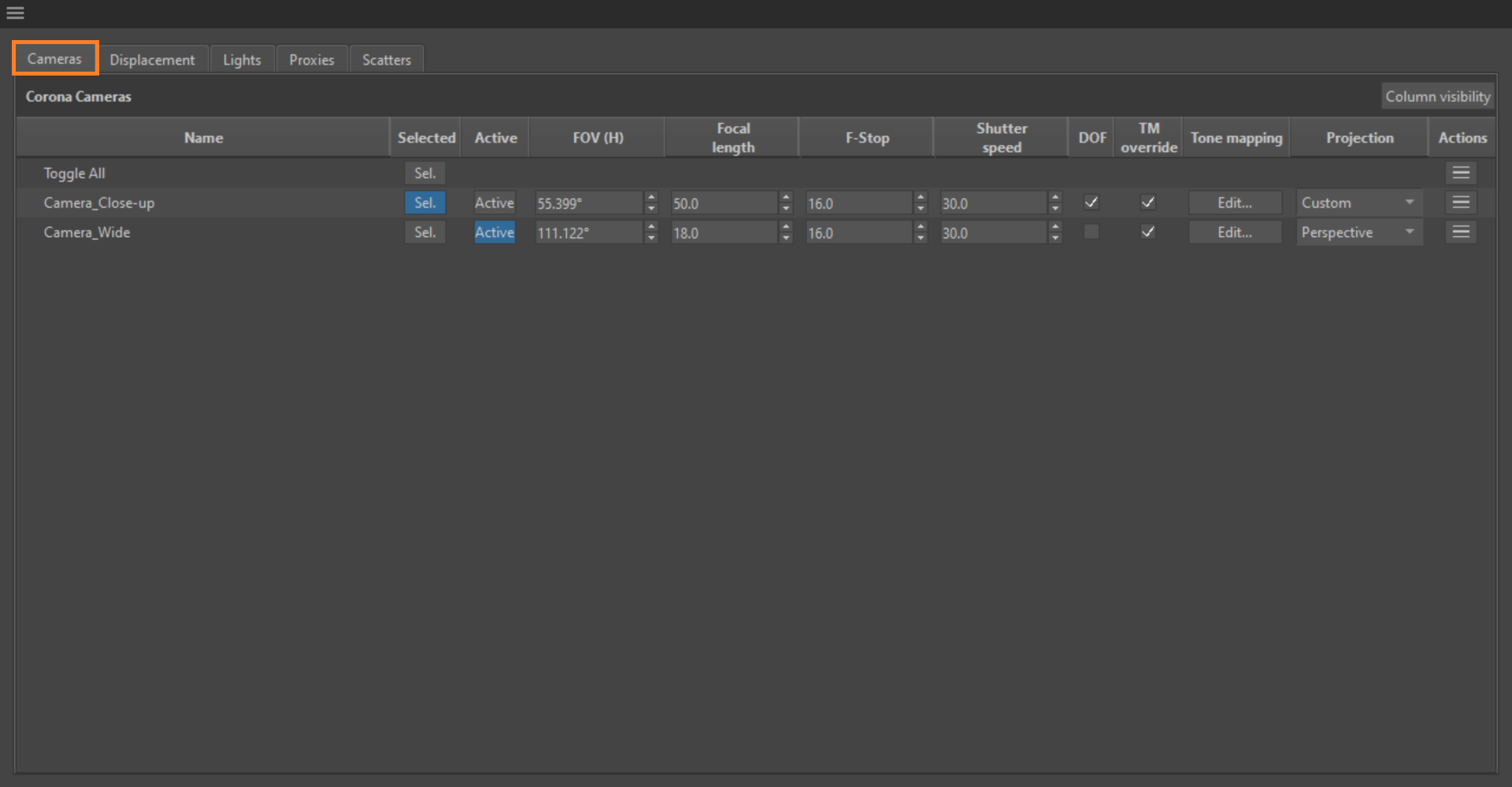

Cameras Tab
Cameras Tab provides a list of all Corona Cameras available in the scene. Here, you can easily access and adjust various camera settings, including tone mapping and projection for each Corona Camera. The Instanced Corona Cameras are organized in a dropdown menu for easy selection. Any modifications made to a specific Corona Camera are automatically applied to all its instances.
Actions
Delete – This removes the selected camera.

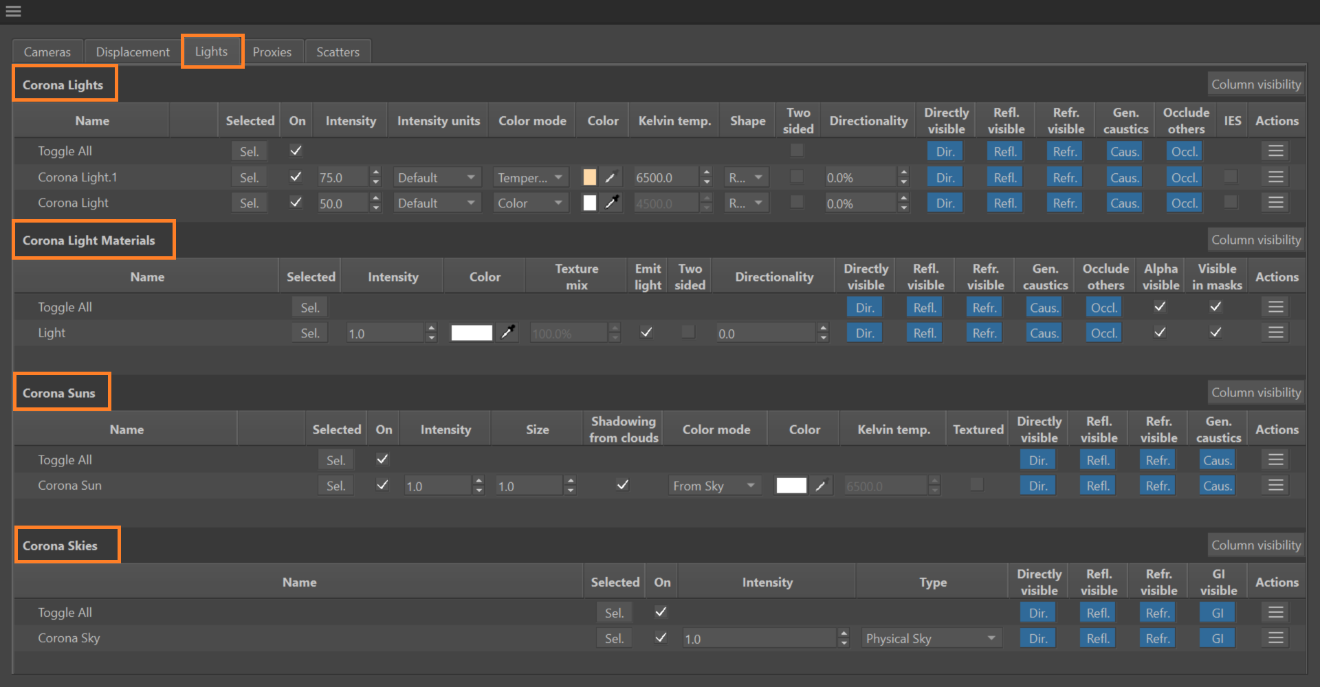

Lights Tab
The lights tab provides a list of all Corona Lights and Corona Light Materials present in the scene. The Instanced Corona Lights are easily organized and can be selected from a dropdown menu. Any modifications made to a specific Corona Light are automatically reflected across all its instances.
Actions
Delete – This removes the selected Corona Sun/Sky or Light/Light material.
Select all assigned (only for Corona Light Materials) – This selects all objects with the selected Corona Light material.

Example Scene
In this example, we use a simple interior scene with several Corona lights. The ceiling lights are instanced and grouped together in the Corona Lister. To change and affect all the values of instanced lights, simply change the parameter of a single light. The side rectangle lights and floor lamp lights are listed separately in the Corona Lister because they are unique and must be adjusted individually to achieve the desired lighting effect. Also, there are multiple Corona Cameras in the scene which are listed in the Corona Lister. All settings can be quickly changed and managed using the Corona Lister.
Scene Setup
A scene with multiple Corona Lights.
Corona Lister - Lights Tab
The Corona Lister can be used to manage multiple Corona Lights in the scene.
Scene Setup
A scene with multiple Corona Cameras.
Corona Lister - Cameras Tab
The Corona Lister can be used to manage multiple Corona Cameras in the scene.
