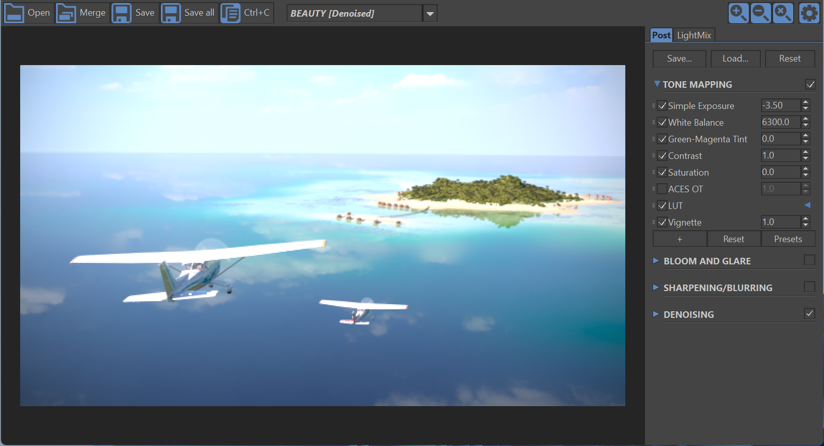

This page provides information on using the Corona Image Editor for 3ds Max.
CIE is a portable, standalone application that allows loading a Corona EXR (.cxr) file and applying all post-processing operations which are available in the Corona VFB to it, including adjusting LightMix, running Denoising, LUTs, bloom and glare, without the need to re-render. All of this is done without running any 3D software. It can be seen as a standalone version of the Corona VFB with extended functionality.

Post Tab
For more information about Post Tab – please check Corona VFB.

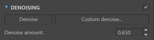

Denoising
Denoise – Immediately denoises all denoisable elements using the most advanced denoising mode that is available for the image.
Denoise Amount – Mixing coefficient between the original (noisy) and processed (non-noisy) image. It allows fine-tuning the effect strength to find the sweetspot between preserving the finest details and removing excessive noise.

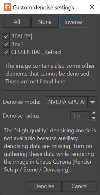

Custom Denoise
All – Selects all items for denoising.
None – Unselects all previously selected items for denoising.
Inverse – Inverts the current selection.
Elements that cannot be denoised are not listed.
Denoise Mode – There are 4 denoising options available. Denoise amount option can be used later to interactively control strength of their effect.
Fireflies Only – Fast filter that just removes very bright pixels from the image (created by any source - noise, caustics, sun reflections, etc).
NVIDIA GPU AI – Very fast GPU-based denoiser. Available only on NVIDIA GPUs when the optional NVIDIA AI Denoiser Corona component has been installed.
Intel CPU AI – (also known as Intel Open Image Denoise) Fast denoising filter applied when render ends. It is a CPU-based denoiser, running on both the Intel and AMD CPUs. It does not have any additional requirements to be executed; if the CPU runs Corona, it can run this denoiser. It is slower than NVIDIA GPU AI denoiser, but can achieve better quality.
High Quantity – A more memory and CPU intensive filter that removes all random noise from the image, creating a noise-free image considerably faster than waiting for the rendering to converge.
NVIDIA GPU AI mode is not suitable for denoising animation.
Denoise Radius – Controls the radius of the denoising blurring.

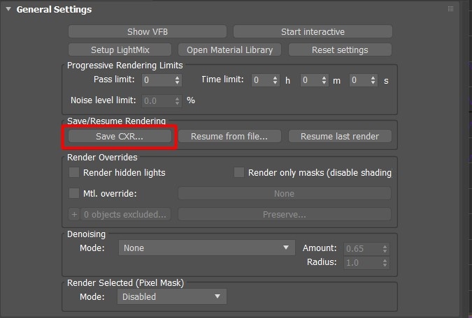

The Corona EXR image format (CXR) is almost identical to the standard EXR format with the one difference being the additional data that is saved within the file. This additional data includes all render elements (also ones which are not exposed to the user, which are used during the denoising process), and rendering statistics such as rays per second, noise level, Corona version, etc. To save an image in Corona EXR format either - press and hold the Save button in the Corona VFB and select Save CXR from the dropdown menu.
If you click the Save button in the upper left corner, this saves only your currently visible render element (render pass in Cinema 4D) in the format of your choice. So if you select the Beauty element and click Save, it saves only the beauty element, without any other elements such as the LightMix, even if you select the CXR format.
If you click and hold on the Save button and select Save all, this saves each render element as a separate file using the format of your choice.
If you click and hold on the Save button and select Save CXR, this stores all the information from the VFB (all render elements, including the LightMix, tone mapping, denoising data, etc...) inside a single CXR file. This file can be used to resume rendering later, post-process in the Corona Image Editor, perform denoising later, and so on.
Alternatively, in 3ds Max you can click Save CXR... in Render Setup > Scene and this has the same effect as clicking Save CXR in the VFB.
