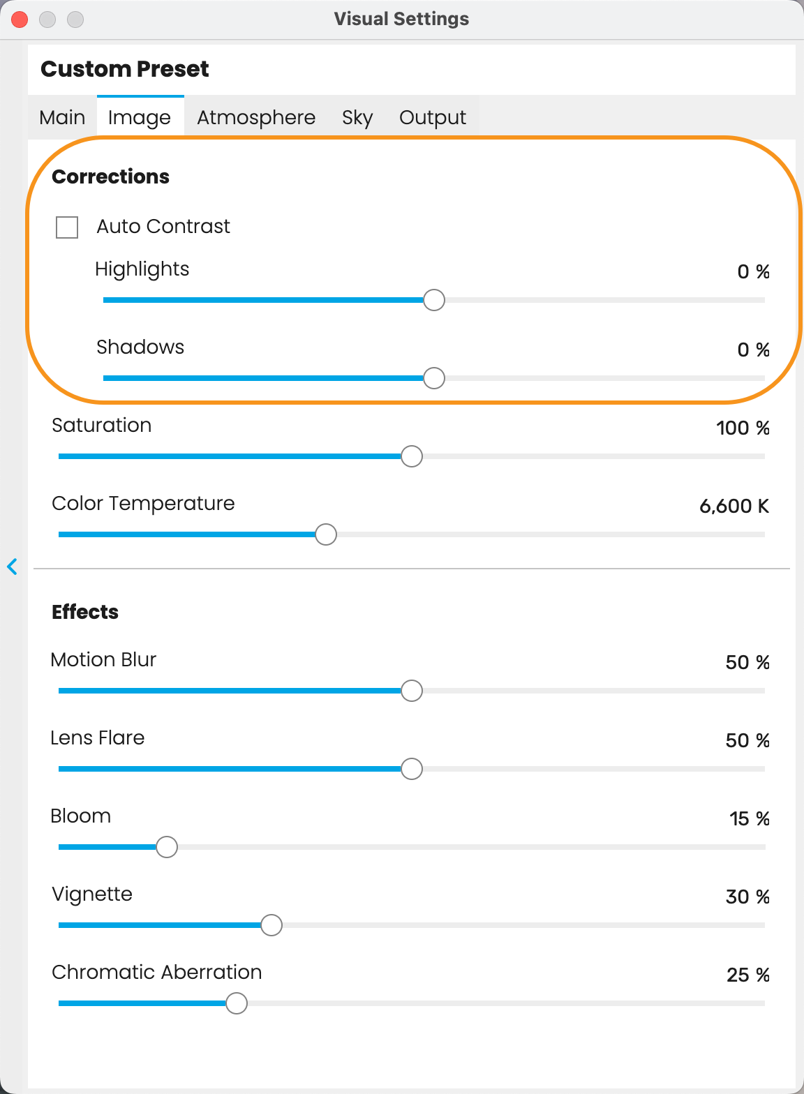

Under the Image tab of the Visual Settings dialog the Auto Contrast setting is disabled by default, allowing you to adjust the strength of the Highlights and Shadows in your render. Enabling Auto Contrast will hide these sliders and apply optimal contrast to the image.
Auto Contrast Settings

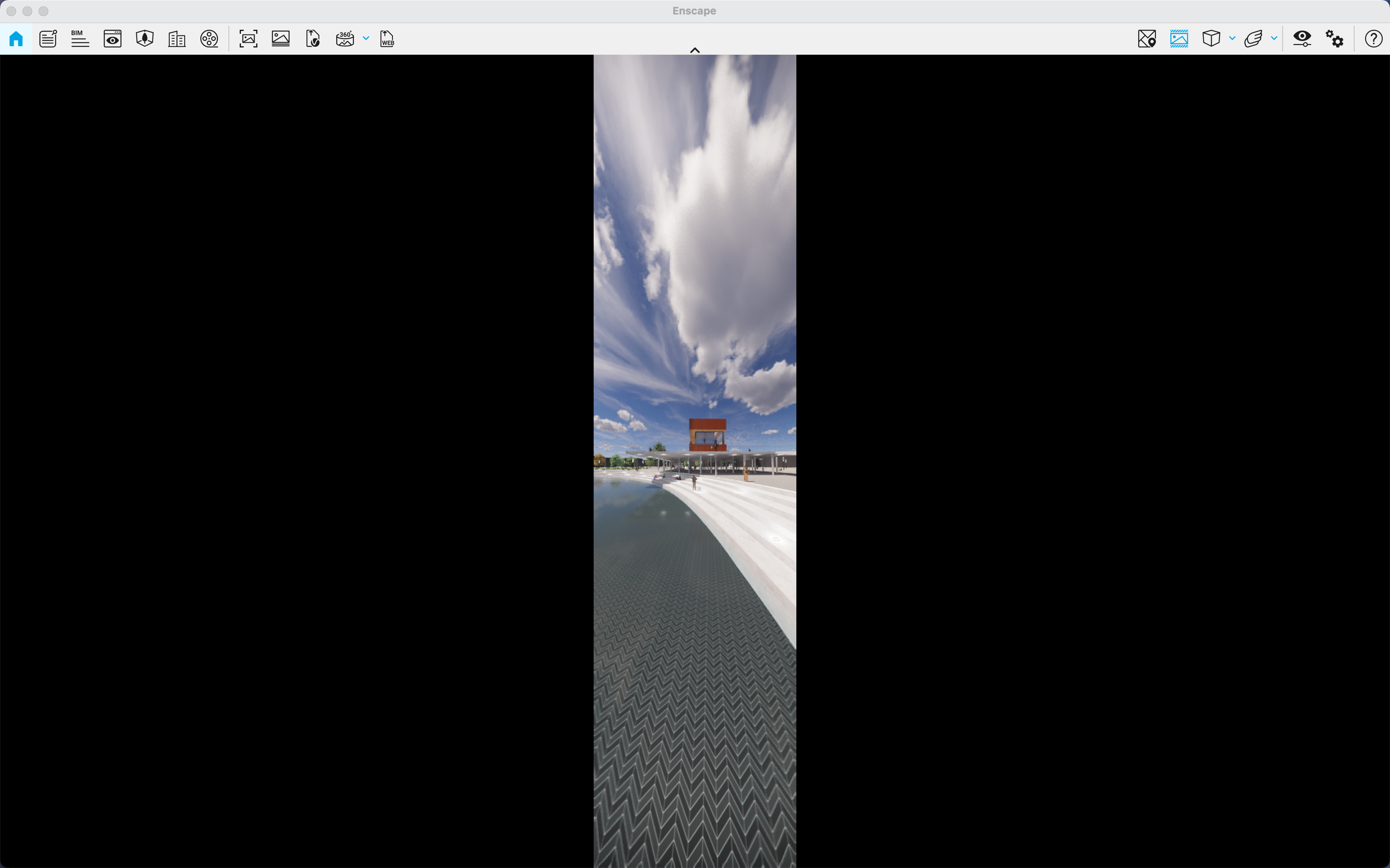

Show Safe Frame
Enscape has a Safe Frame feature, and this can be found in Enscape’s viewport toolbar.
NOTE: If Show Safe Frame is enabled it will be always be visible in the live Enscape viewport.
Safe Frame enabled
So, you will still be able to navigate your project when Show Safe Frame is enabled.
In the following screenshot, as way of an example, the Resolution is set to a Custom: 500×2000.
Preview when Safe Frame is enabled

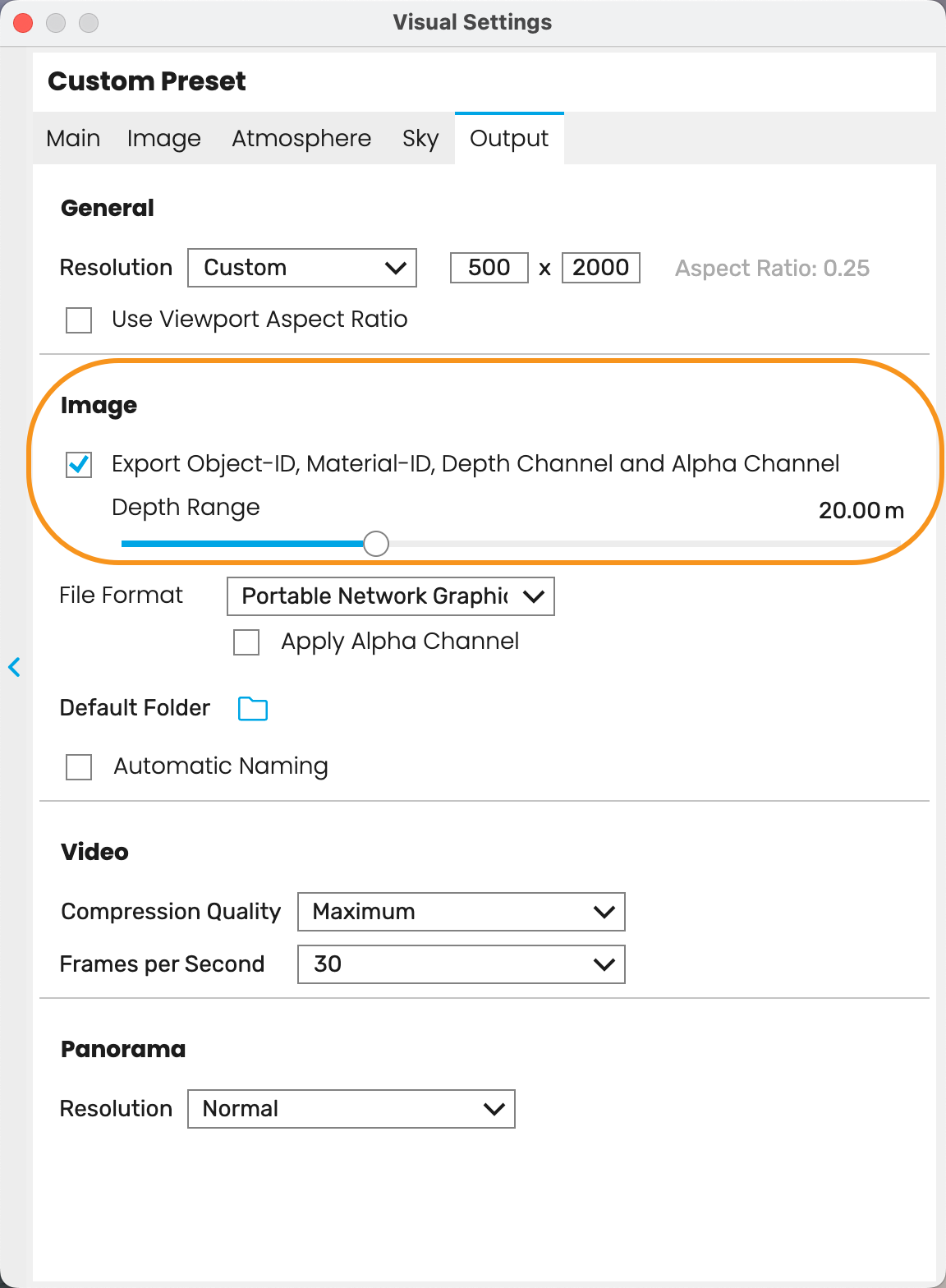

Export Object-ID, Material-ID and Depth Channel
If you’d like to post-process your image in, for example, Photoshop, or incorporate your rendering into a photograph by including a transparent background, a very useful tool is the Export Object-ID, Material-ID and Depth Channel checkbox in the ‘Capture’ settings tab.
Export Object-ID, Material-ID and Depth Channel in Enscape
When active, Enscape will export four images for each image or View – the rendered image as seen in the Enscape window itself, a second image that’s graded from white to black, depending on the distance from the camera (Depth Channel) and third and fourth rendering that assigns a distinctive color to each object (Object-ID), material (Material-ID).

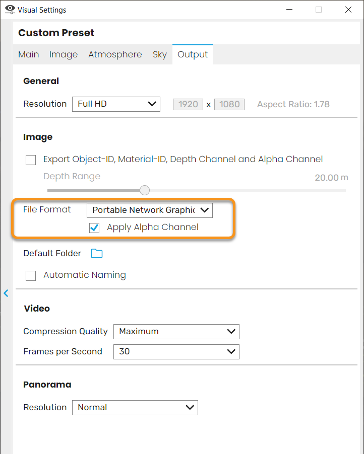

Alpha Channel Export
It is also possible to export images with an embedded alpha channel. This feature is only available when setting the file format to either .png, .exr, .tga.
To enable an image to be exported with an embedded alpha channel, make sure the checkbox for Apply Alpha Channel is checked.
The Alpha Channel export also includes information for transparent and semi-transparent materials. This means that if the sky is visible behind a semi-transparent surface, that background (sky) will be removed, without losing the reflection of the objects located in front of the surface.
Apply Alpha Channel option

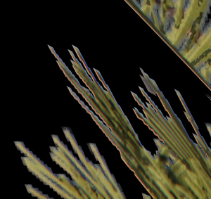

If you find you are not getting crisp clean edges on an exported image (where blue / red artifacts on an edge will be visible when zoomed in on the exported image) when Apply Alpha Channel is enabled, then set the Chromatic Aberration slider in the Enscape Visual Settings -> Image -> Effects section to 0. Here’s a comparison between the Chromatic Aberration slider being set to greater than 0 (enabled) and with the slider set to 0 (disabled).

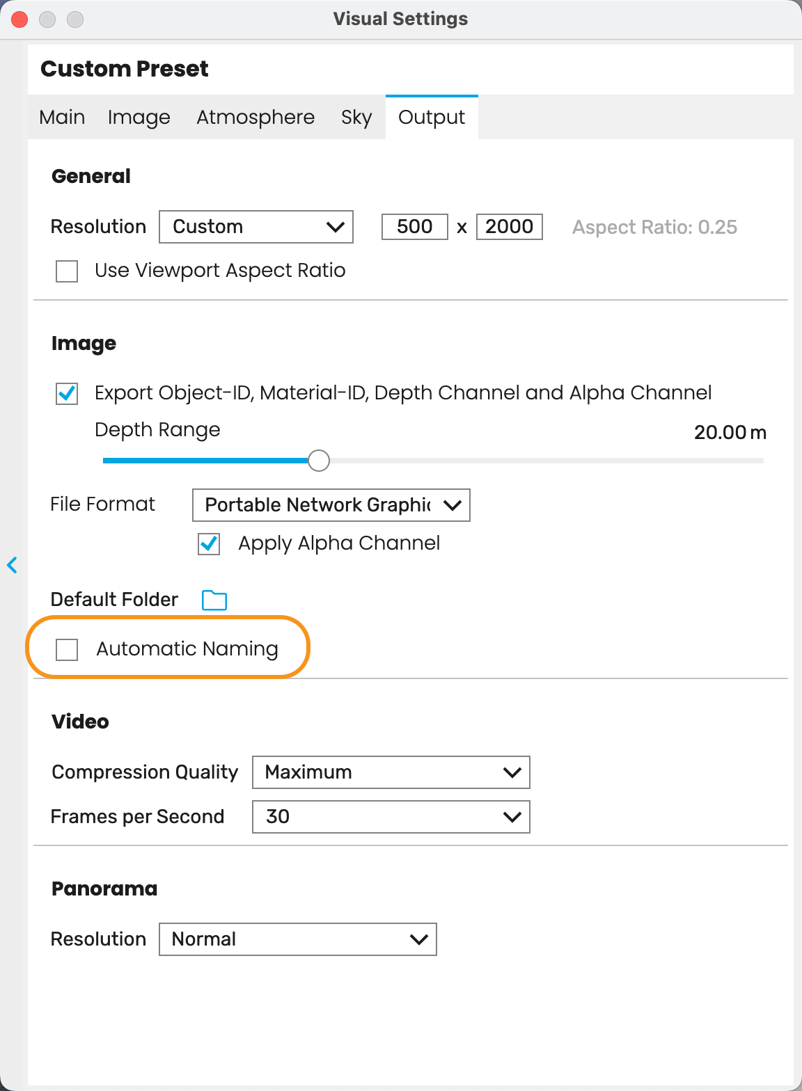

Automatic Naming
Enabling the Automatic Naming in the Enscape Visual Settings’ Output tab will rename the file appending it with the date and time for single images.
When Batch Rendering, the image names will additionally include the name of views, with or without automatic naming applied:
Batch render of multiple views:
filenames include date, time and name of views.
Batch render of a single view with automatic naming:
Batch render of single view without automatic naming:
user is prompted for a filename, the suggested name is however the same as above.
Automatic Naming option
