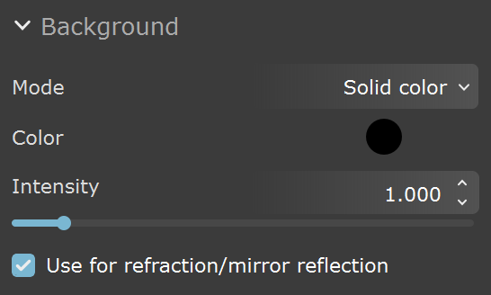

Solid Color Mode
The following parameters are available for Solid Color mode:
Color – Specifies a color as a background.
Intensity – Specifies the intensity for the background image/color. See the Solid Color Intensity example below.
Use for refraction/mirror reflection – When enabled, the background override is used for both refraction and perfect (glossiness=1) reflection rays. See the Use for Refraction/Mirror Reflection example below.

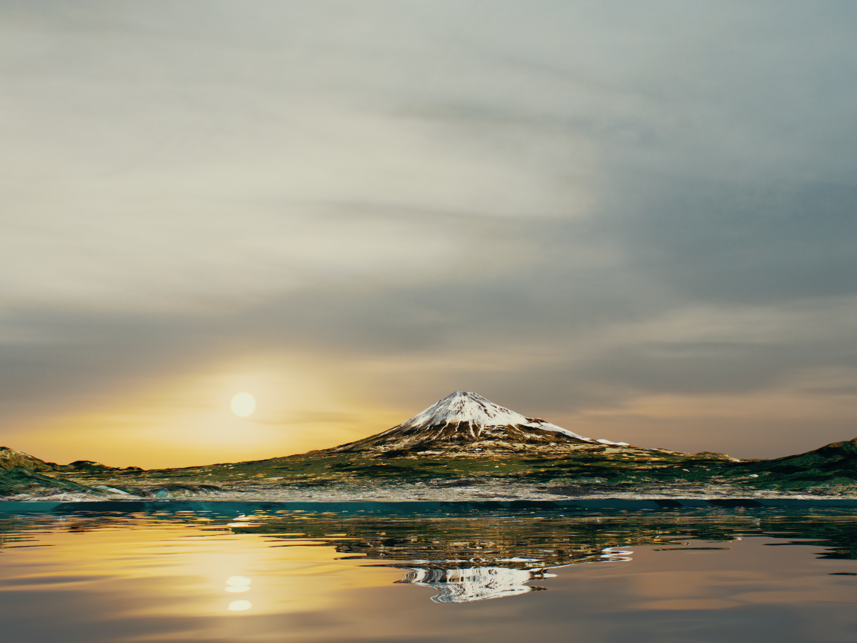

This example shows the difference between all three Background Modes.

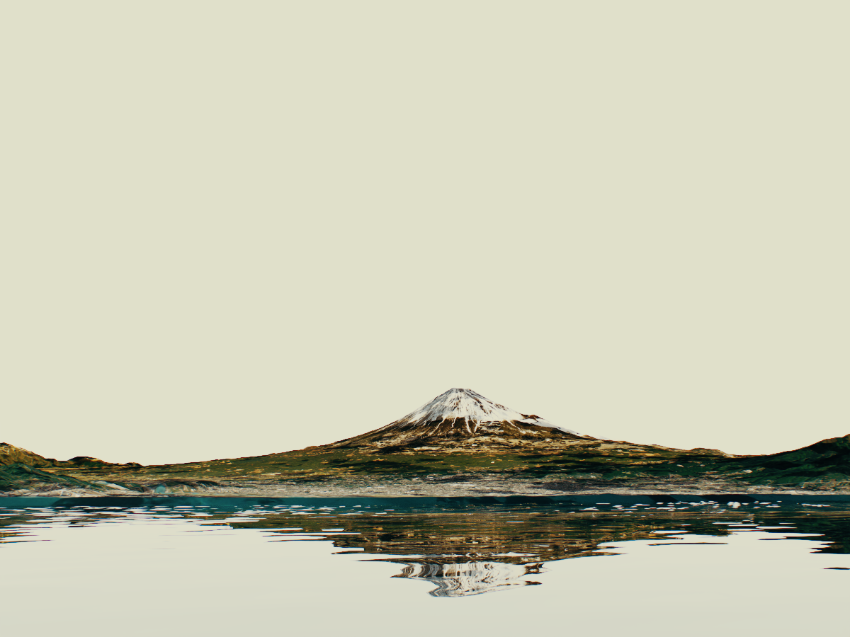

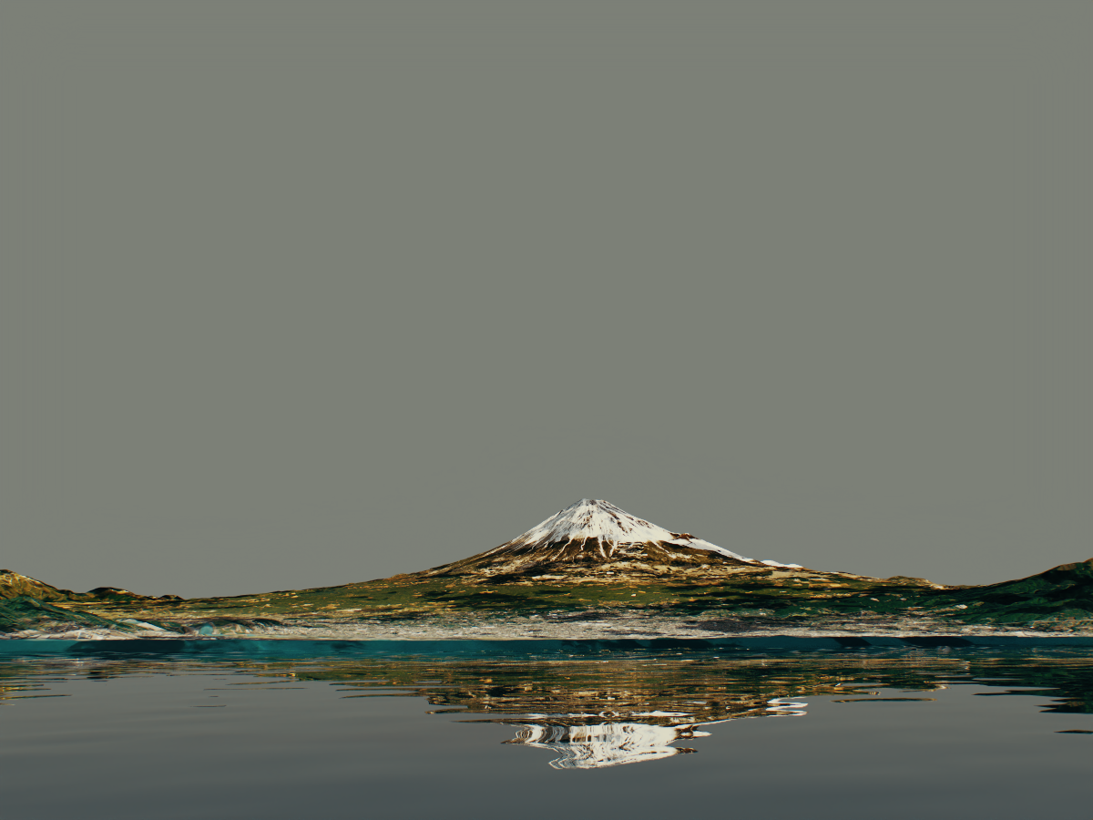

This example shows the effect of the Intensity parameter when Background Mode is Solid color.
Same as Environment
Solid color
Intensity = 0
Intensity = 1

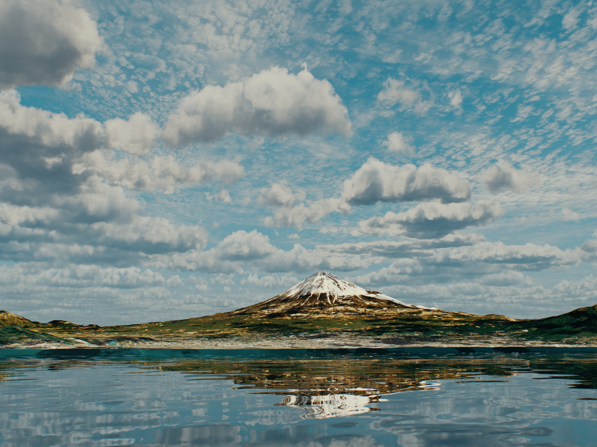

This example shows the effect of the Use for refraction/mirror reflection parameter. The Background mode is set to Image. Note how the reflection changes to reflect the new overwritten background instead of the original physical sky and procedural clouds.
