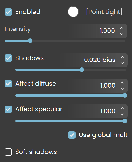

Point Light Parameters
The following parameters are available when importing Point Lights from applications other than 3ds Max.
Enabled – Turns on and off the point light.
Color – Changes the color of the point light. See the Color example below.
Intensity – Specifies the intensity of the point light's brightness. See the Intensity example below.
Shadows – When enabled (the default), the light casts shadows. Turn this option off to disable shadow casting for the light. The value moves the shadow toward or away from the shadow-casting object(s). Higher values move the shadow toward the object(s), while lower values move it away. If this value is too extreme, shadows can "leak" through places they shouldn't or "detach" from an object. Other effects from extreme values include Moire patterns, out-of-place dark areas on surfaces, and shadows not appearing at all in the rendering. See the Shadows example below.
Affect diffuse – Determines whether the light affects the diffuse portion of the materials. The value controls the light's contribution to the diffuse portion of the materials. See the Affect Diffuse example below.
Affect specular – Determines whether the light affects the specular portion of the materials. The value controls the light's contribution to specular reflections. See the Affect Specular example below.
Use global mult. – When enabled, uses the Enable Lights value (Render tab > Advanced mode > Lighting rollout) as a multiplier to Intensity value. When disabled, the light is independent from the global multiplier.
Soft shadows – When enabled, the light shape is considered for illumination and the light is going to generate soft shadows. When disabled, the light is going to generate sharp shadows.
Area speculars – When enabled, the shape of the light is visible in the specular reflections. When disabled, the particular light is rendered as a point light in the specular reflections.

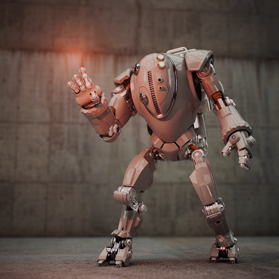

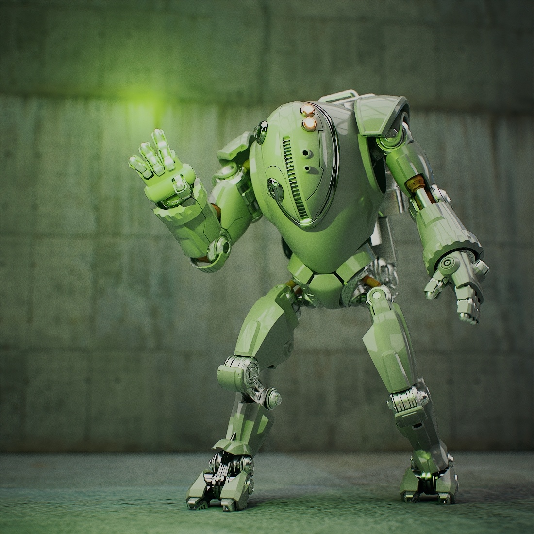

Color
This example shows the effect of the Color parameter.
Color is red
Color is green
Color is blue

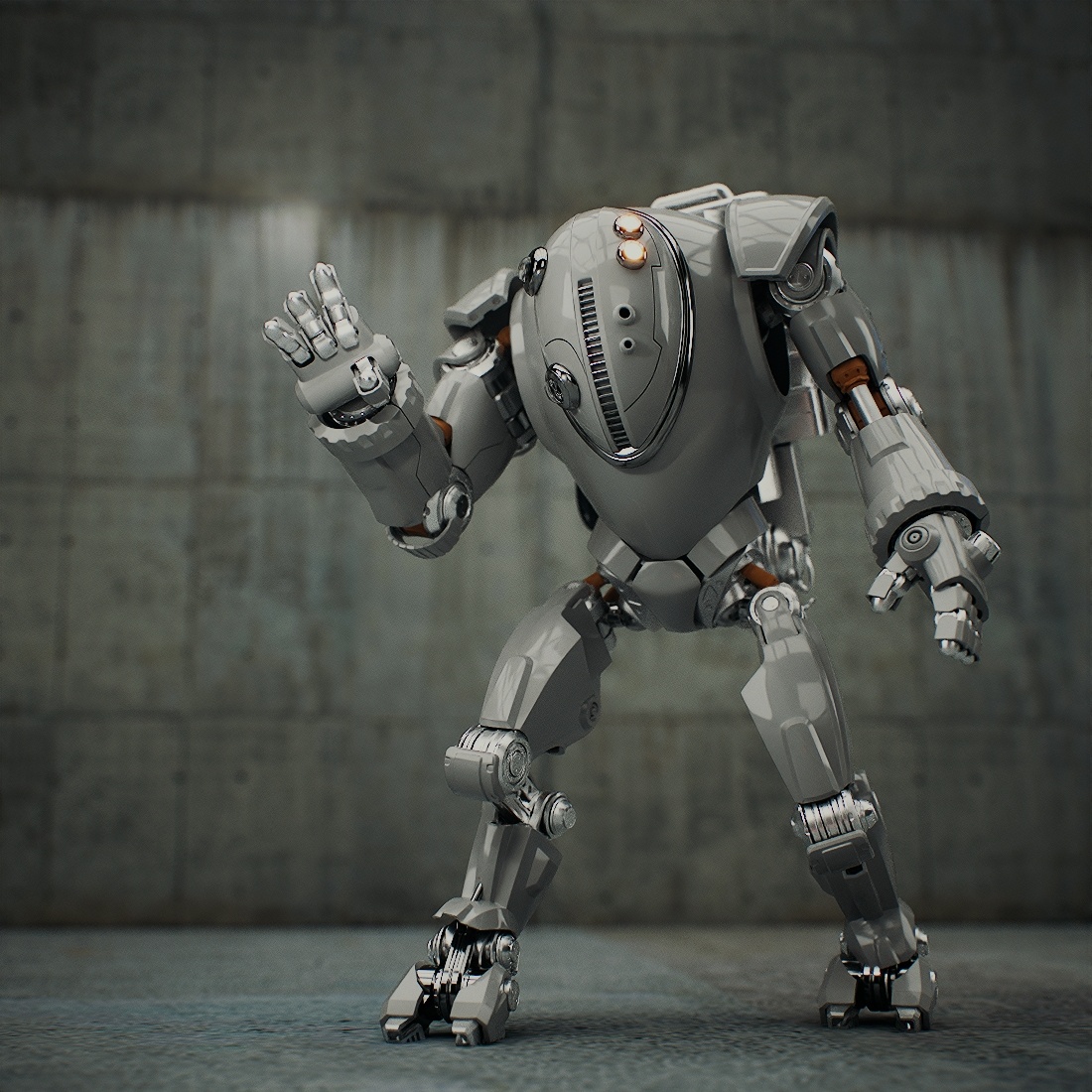

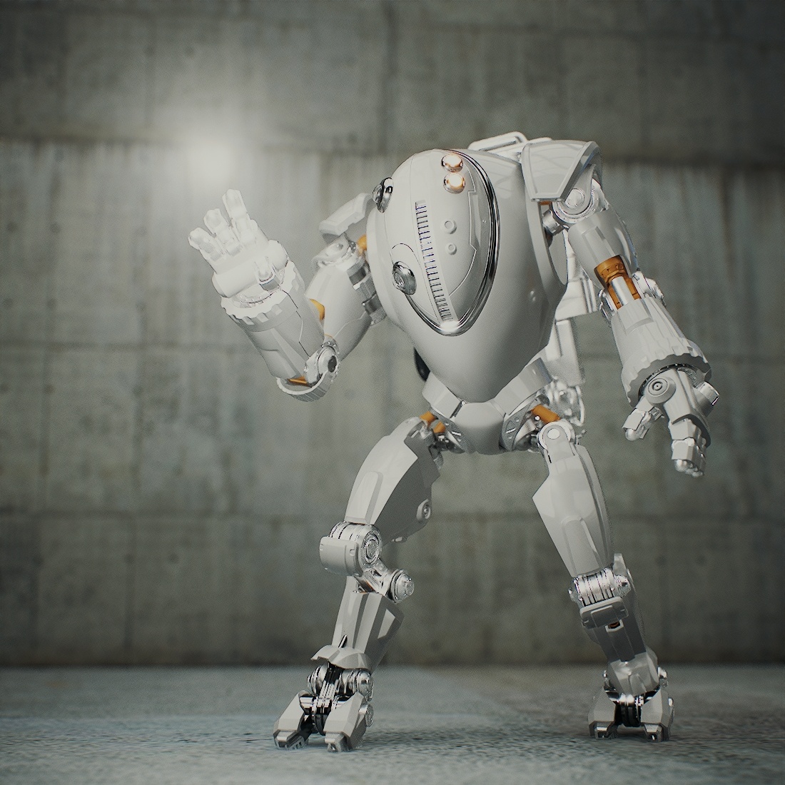

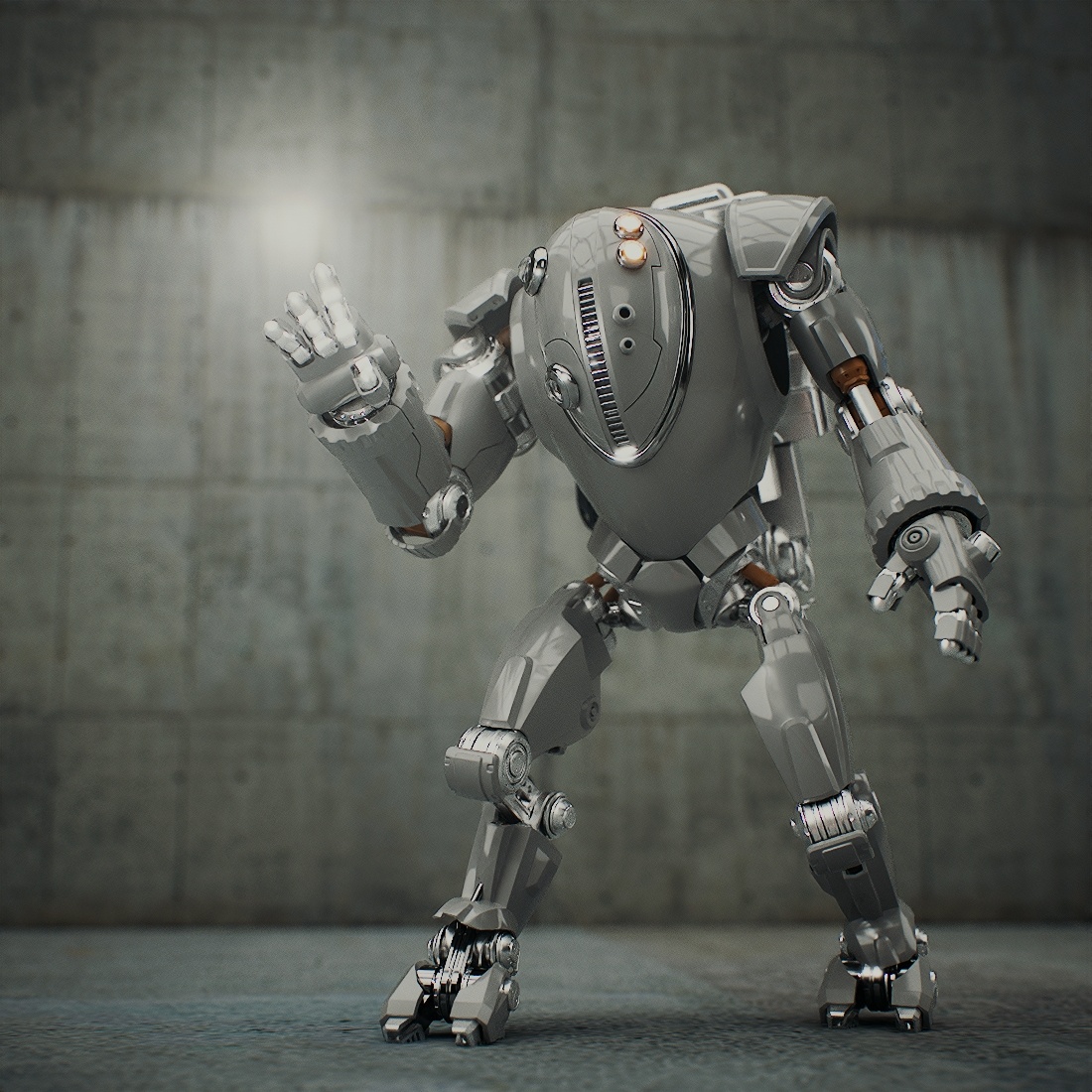

Intensity
This example shows the effect of the Intensity parameter.
Intensity = 50
Intensity = 100
Intensity = 200
Intensity = 300
