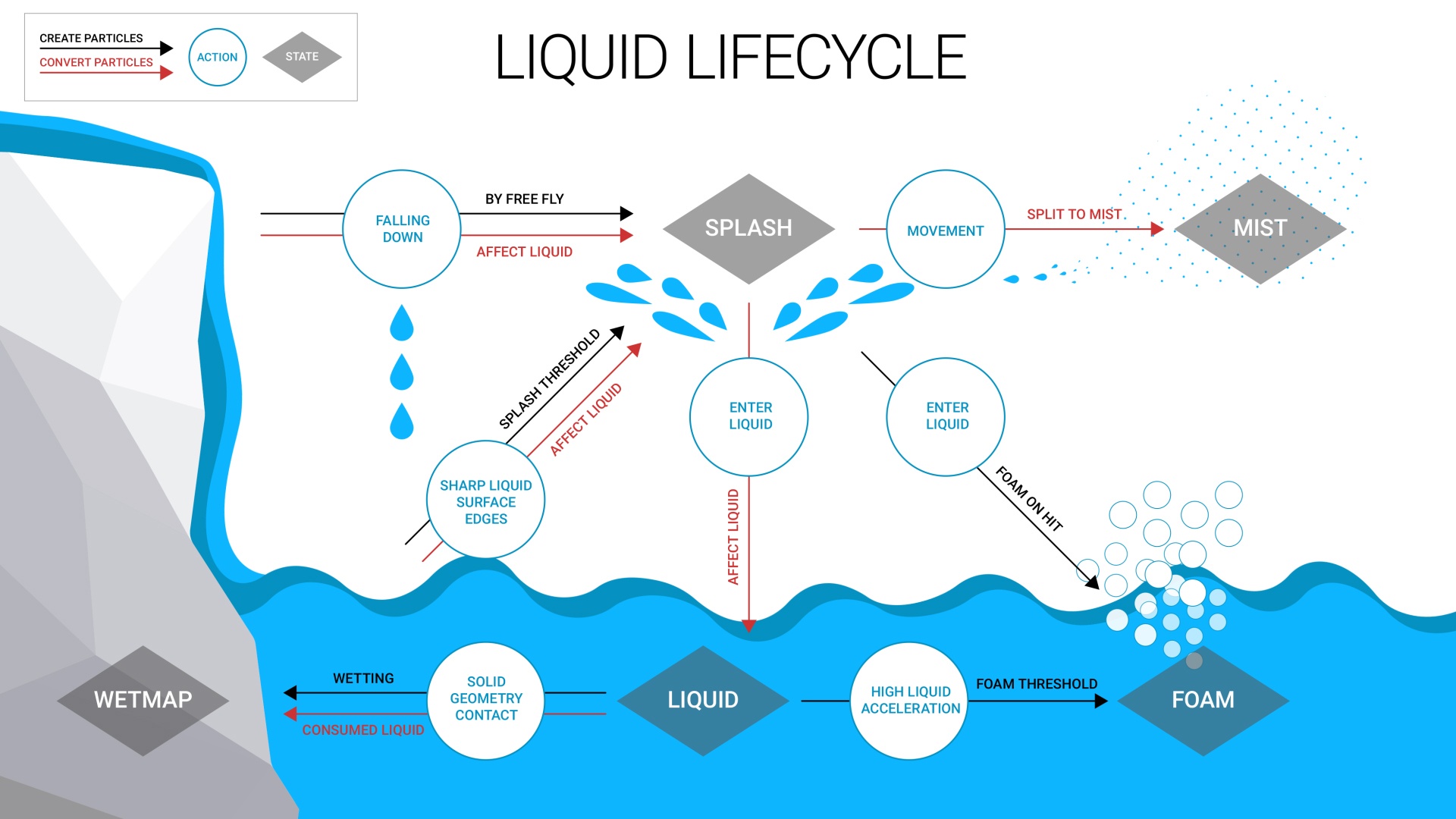

This page lists all processes that create and destroy the different FLIP liquid particle types, including conversions between particle types.
Liquid
Simulated whenLiquid Simulator Output rollout Liquid Grid/Particles enabled.
Birth:
Life:
  • At places where the liquid velocity gradient is high, creates Foam particlesRequiresFoam is simulated.
  • At places where the liquid surface has sharp edges, creates Splash particlesRequiresSplash is simulated.
  • At places where the liquid is in free fall, creates Splash particlesRequiresSplash is simulated + Liquid Simulator Splash rollout By Free Fly > 0.
  • On contact with a Solid geometry, creates WetMap particlesRequiresWetMap is simulated + geometry has Wetting property.
Death:
Foam
Simulated when: Liquid Simulator Output rollout Foam Particles enabled + Liquid Simulator Foam rollout enabled.
Birth:
  • At places where the liquid velocity gradient is highRequiresLiquid is simulated.
  • When Splash particles die on entering the Liquid volumeRequiresSplash is simulated + Liquid Simulator Splash rollout Foam On Hit > 0.
  • From any Source (Source Particles enabled + Source Particle Type = Foam).
Death:
Splash
Simulated whenLiquid Simulator Output rollout Splash Particles enabled + Liquid Simulator Splash rollout enabled.
Birth:
  • At places where the liquid surface has sharp edgesRequiresLiquid is simulated.
  • At places where the liquid is in free fallRequiresLiquid is simulated + Liquid Simulator Splash rollout By Free Fly > 0.
  • From any SourceRequiresSource Particles enabled + Source Particle Type = Splash.
Life:
Death:
Mist
Simulated whenLiquid Simulator Output rollout Mist Particles enabled + Liquid Simulator Splash rollout enabled + Liquid Simulator Splash rollout Splash to Mist > 0.
Birth:
Death:
WetMap
Simulated when: Liquid Simulator Output rollout WetMap Particles enabled + Liquid Simulator Dynamics rollout Wetting enabled.
Birth:
Death:
