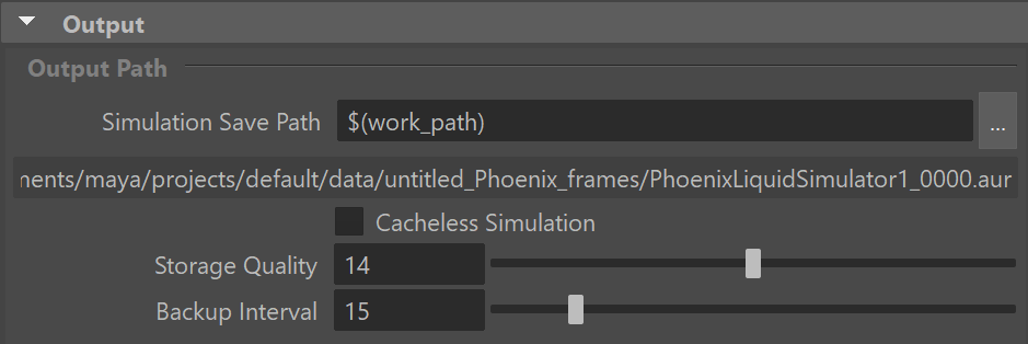

Output Path
Simulation Save Path | outPath, outPathResolved – This is the directory and the name template for the output cache files. It uses the $(scene_path) macro by default, and there are also other available macros as listed below. To set up rendering and simulation cache paths manually, see How to change the default Phoenix paths on the Tips and Tricks page.

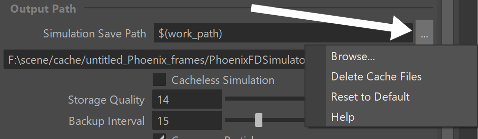

 Clicking the "..." button will open a menu with the following options:
Browse - Opens a dialog where you can select where the simulation caches will be written to. The filename you type in must contain # signs so each simulation frame will be written to a differently numbered file. Also, you can choose between two file formats - AUR and VDB cache files. In order to write the simulation caches to VDB in the default simulation path, you can just edit the Simulation Save Path to $(work_path).vdb.
Delete Cache Files - Clears the cache files matching the provided Simulation Save Path pattern.
Reset to Default - Resets the Simulation Save Path to default.
Help - Opens this Help page.
Cacheless Simulation | cacheless – Only the last simulated frame will remain in RAM and no caches will be written to the storage. This will speed up simulations which are bound by slow reading or writing to the hard disk or by compression and decompression of the grid or particle data. You can use this option when iterating on the simulation settings in order to speed up your iterations. It can also be combined with the Render On Each Sim Frame option under the Simulation rollout, or the Save Images During Simulation option of the GPU Preview, so you will get a ready image sequence if you leave the simulation unattended and then return to check it.
Storage Quality | storageQuality – The output grid and particle channels are compressed by default in order to increase the performance (faster cache loading) and to avoid excessive memory consumption. This parameter can range from 8 to 20 - 8 is the smallest size, while 20 is the best quality and is uncompressed. If this value is set too low, different artifacts may start appearing depending on the type of scene. For grid channels, artifacts shaped like horizontal slices may appear in preview and rendering, such as in the following image:
Backup Interval | backupInterval – The frame interval between two backups of the full simulation state. You can later continue a stopped simulation from such frames (see the Restore button in the Simulation rollout). To make a Restore possible at every frame, set this parameter to 1. A value of 0 means no backup frames will be exported.

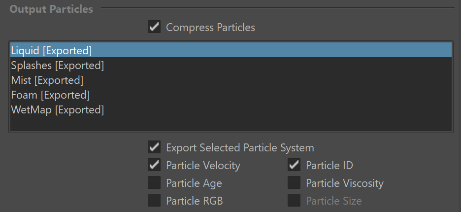

Output Particles
Phoenix particle systems contain Particle Channels for each particle, which represent the properties of the fluid simulation. Each Particle Channel has its own range of possible values that is most efficient for that specific channel type (see the Particle Channel Ranges).
Here in the Output rollout, you can choose which Particle Channels will be exported to the cache files.
The particle export parameters share a User Interface to keep the user interface compact. Each particle system can be selected individually from the Output Particles list, and the output settings can be selected for that particle system. When a particle system is selected again, the same settings are retained.
Compress Particles | prtcompress – Enables compression of the simulated particle systems when they are written to AUR cache files. VDB cache files exported from Phoenix do not support particle compression. Simulations with very high particle counts, such as 50 million or more, will produce large caches, so particle compression will help reduce the cache sizes significantly. If you are writing or reading the cache files over the network or to a disk drive, this could significantly speed up simulation and rendering. However, if you are writing the simulation caches to an SSD drive or other fast storage, and you can afford to have large cache files, then disabling the compression could actually speed up the simulation.
Export Selected Particle System – When enabled, the selected system will be exported.
Note that writing more channels to the cache files takes more time and will add up to the simulation time, so if you know in advance that you will not be needing a certain channel for rendering, then it would help the simulation times if you turn it off.
Particle Velocity – The particle velocity channel will be exported. Use this option when you need motion blur for the particle systems such as Foam, Splash, etc.
Particle ID – When enabled, the particle ID channel will be exported. This channel is used during rendering to identify each particle. Use it when render time size variation is needed, if you would use the Particle Shader's Count Multiplier, or when frame blending will be involved (animated frame index or non-integer play speed).
Particle Age – When enabled, the particle age channel will be exported. The particle age channel will be exported. This channel can be used for animation effect based on the particle age, which can be needed by the Phoenix Particle Texture, Phoenix Source, Particle Shader, or Particle Tuner.
 The Age channel is affected by the Time Scale option under the Liquid Dynamics rollout which acts a multiplier for the Age.
Particle Viscosity - The particle Viscosity channel will be exported. Enable this if your Liquid Resimulation requires the calculation of viscosity.
Particle RGB – When enabled, the particle RGB channel will be exported. You can use this for simulations where you are mixing different particle colors or you shade the particles by the particle RGB channel through a Phoenix Particle Texture. Also, enable this if you want to be able to preview the RGB channel as a particle color in the viewport.
Particle Size – You would need this channel to be exported if you would like to use the simulated particle sizes when rendering. Note that the WetMap particle system does not export the Age channel and its Size channel decreases with time.

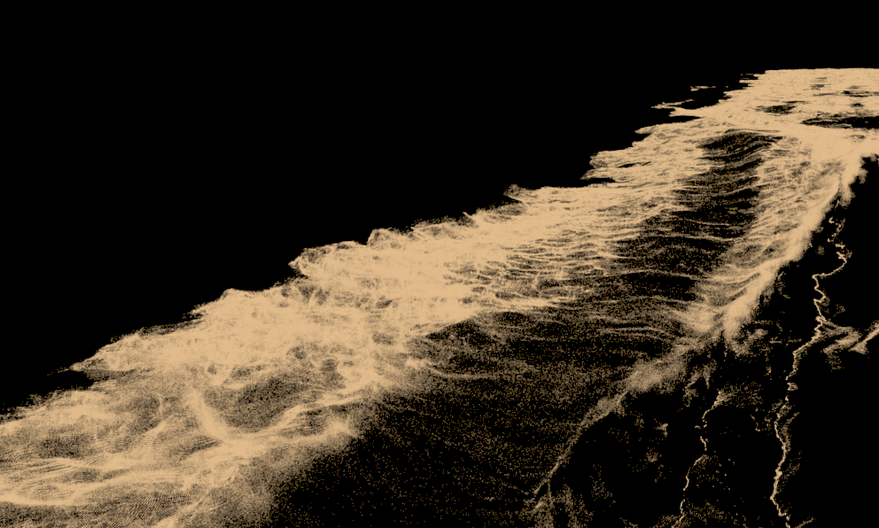

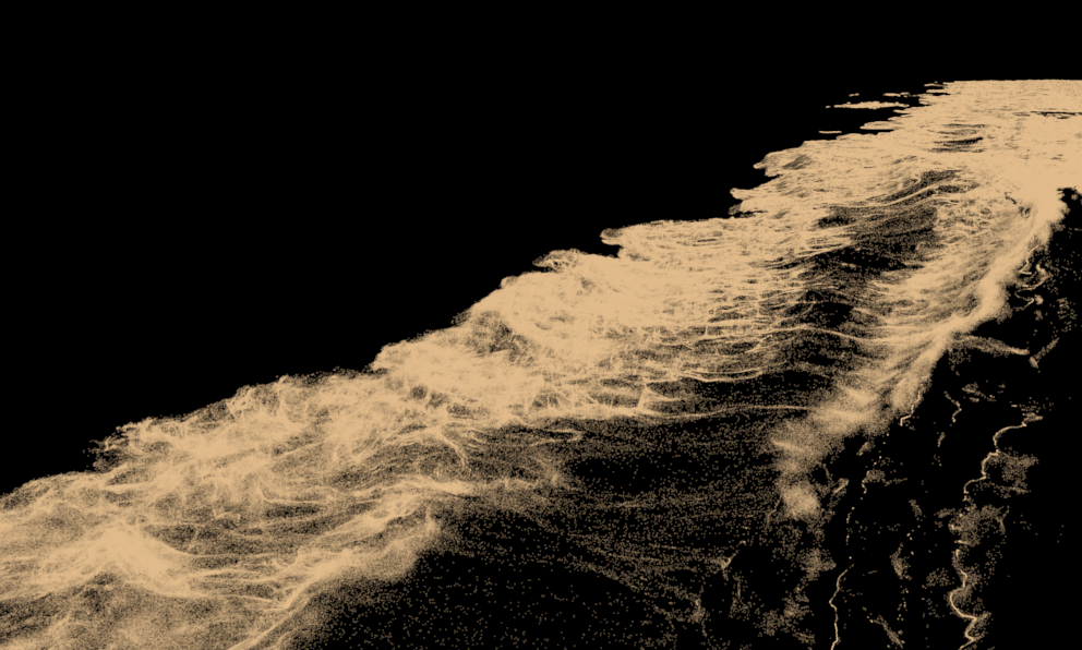

Example: Particle compression artifacts
For particle systems such as Liquid or Foam, the artifacts would look like ordered lines of particles, as in the following comparison (click to zoom in):
Storage quality = 19
Storage quality = 14
(artifacts in the lower left corner)
Storage quality = 8

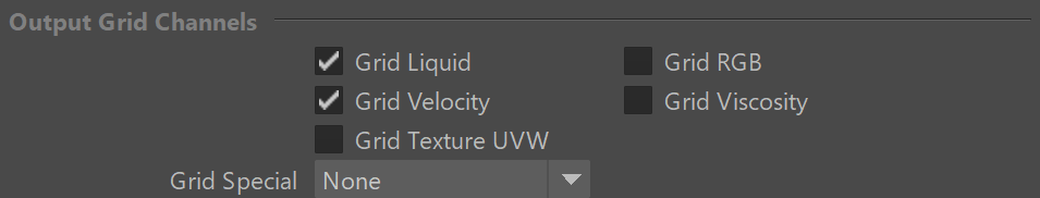

Output Grid Channels
Fluid properties are written inside Grid Channels. Here you can choose which Grid Channels will be exported to the cache files when running a simulation.
Each channel stores a type of value, such as Temperature/Liquid, Smoke, RGB, Velocity and so forth, with its own range of possible values that is most efficient for that specific channel type (see the Grid Channel Ranges). Phoenix determines the fluid’s behavior at a given time, based on the content of these Grid Channels.
Note that the more channels are used, the slower the simulation runs and the larger the output files are. While scrolling the timeline, you can check which channels are present in the loaded cache file for the current frame, from the Cache File Content section in the Simulation rollout.
Also note that in the case of FLIP / Liquid simulations, currently only Liquid particles can be automatically converted to a grid during export, while all the other systems (e.g. Foam, Splash, etc.) are exported only as particles.
Grid Liquid | outTemp – Exports the liquid amount which is needed so that you can render the Liquid as a mesh and also preview it as a mesh in the viewport.
Grid RGB | outUVW – Export the RGB color. You can use this for simulations where you are mixing different liquid colors or materials through a Phoenix Grid Texture.
Grid Velocity | outVel – Export the velocity of the simulation. The difference between the Speed and Velocity channels is that Velocity is a vector and takes 3 times more space in the cache file than the Speed channel. However, Velocity has direction and is needed for Liquid Resimulation and motion blur of the fire/smoke simulation or the liquid mesh. Because Speed can be calculated from the Velocity, it is not exported separately when Velocity is exported.
Grid Viscosity | outVisc - Export the Viscosity channel. Required for variable Viscosity simulations  You may also choose to enable this if, for instance, your setup requires that you use the Viscosity channel as a mask through a Phoenix Grid Texture.
Grid Texture UVW  | outTexUVW – Export the Texture UVW channel. Enable this to generate texture mapping coordinates that follow the movement of the fluid. This way you can change the textures you want mapped over your fluid even after the simulation has ended, without the need to simulate again. For more information on TexUVW, please check the Texture mapping, moving textures with fire/smoke/liquid, and TexUVW page.
Grid Special | outSpecial – Export internal or special channels into the Special channel (alias to the Smoke channel) so they can be visualized using one of the volumetric shaders of the Simulator (with Mode set to VolumetricVolumetric Geometry, or Volumetric Heat Haze). Such channels can also be read by the Grid Texture and used for rendering.
