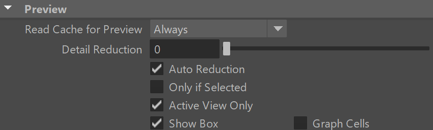

UI Path: ||Select PhoenixFDSim|| > Attribute Editor > Preview rollout
Read Cache for Preview prvReadCache – Allows to completely disable reading of cache files in order to speed up the viewport and the simulation. When cache files are not read, neither voxels and particles, nor the grid bounding box or the Cache File Content under the Simulation rollout will be shown. This way scrolling the timeline would be quick as there will be no access to hard disk or the network. If you still need to see the grid bounding box and the Cache File Content info, you could leave this option to Always, and instead disable all voxel preview options, the Mesh PreviewGPU Preview and all particle previews. The intended use for this parameter is as a last step performance optimization - once you're done tweaking your setup and you're ready to commit to a high-resolution, overnight simulation, disable the preview of cache files.
Always – Cache files are always read by the preview.
Disable During Sim
 – Cache files are read only when the simulation is stopped. This would speed up the simulation and is good for overnight simulations where you don't need to watch the simulation constantly.
Don't Preview Caches
 – Cache files are never read for the preview. They will only be read during rendering, or in case any of the Phoenix tools requires them - e.g. the Particle Shader, the Grid Texture, etc.
Detail Reduction | detailReduction – Decreases the grid and particle detail in the preview. A value of 0 means no reduction. Increase this value if the interface starts to lag due to the simulation being very large. Note that this parameter does not affect the Mesh preview.
Auto Reduction | viewAutoReduction – Enables automatic adjustment of the Detail Reduction parameter to improve display performance. The preview detail will be reduced up to a point where the preview will display fast without blocking the interface. Note that the detail will only decrease automatically, but will not increase. This option works only for the Voxel and Particle previews.
Only if Selected | onlyIfSelected – When enabled, the content in the viewports is only shown for the selected Simulators.
Active View Only | activeViewOnly – When enabled, only the selected viewport shows the content of the Simulator.
Show Box | showGrid – When enabled, displays the Simulator's box in the viewport. The Simulator box settings can be modified from the Grid rollout.
Graph Cells | showGridCells – Shows a lattice with the cell sizes on the sides of the Simulator's box or the Slice Preview.

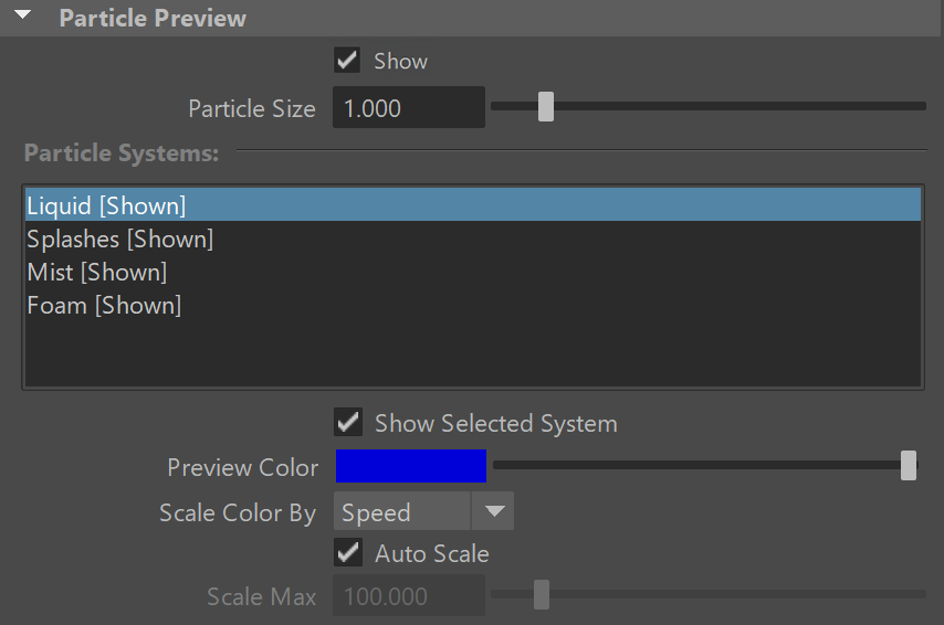

Particle Preview
The parameters here control the visualization of Particle Types generated by the Simulator. Phoenix can only preview the Particle Types present in the cache file for the current frame.
You can specify a Particle Channel to use as a basis for adjusting the particle preview color, using the Scale Color By option. For example, you could set the Scale Color By option to the Speed particle channel, so that the faster the particles move, the whiter they appear in the preview.
You can find more info on Particle Channels from the Particle Channel Ranges page.
Show prv_particles – Enables the preview of particles. The controls below affect the visualization of the currently selected particle group.
Particle Size | viewPartSize – Sets the size of the particles in the Viewport. Note that all particles are drawn with the same size.
Particle Systems | viewPrtSysNames – Displays a list of particle systems generated by the Simulator. Selecting a particle system allows you to edit its preview settings.
Show Selected System | viewPrtSysShowUI – When enabled, the particle system will be visible in the Simulator preview. You can choose the Particle System to edit from the particle Systems menu.
Preview Color | viewPrtSysColorUI – Specifies the default color of the particles. Moving particles are displayed as a blend between their default color and white, based on the selected Scale Color By channel. Note that if the particle system has an RGB channel exported, it will be used in place of the Preview Color.
Scale Color By | viewPrtSysColScaleChanUI – Specifies the particle channel used for adjusting the particle preview color.
  • No Scaling – All particles will be the same color - the one specified by Preview Color.
  • Speed – The faster the particles move, the whiter they will appear.  The preview is only affected by the Scale Max option if the particle system has the Velocity channel export enabled.
  • Size – The larger the particles are, the whiter they will appear.  The preview is only affected by the Scale Max option if the particle system has the Size channel export enabled.
  • Age – The older the particles are, the whiter they will appear.  The preview is only affected by the Scale Max option if the particle system has the Age channel export enabled.
  • Viscosity – The higher the viscosity the particles, the whiter they will appear.  The preview is only affected by the Scale Max option if the particle system has the Viscosity channel export enabled.
Auto Scale | viewPrtSysAutoWSpeedUI – When enabled, automatically calculates Scale Max based on the Min/Max range of the selected Scale Color By particle channel, assuming the respective channel export has been enabled in the Liquid Output rollout for the selected particle system.
Scale Max | viewPrtSysWSpeedUI – When Auto Scale is disabled, allows you to specify a constant value at which the particle preview color becomes pure white. Particles with a Scale Color By channel value higher than the specified Scale Max are also pure white. You can also find more info about the usual particle channel maximum values on the Particle Channel Ranges page.

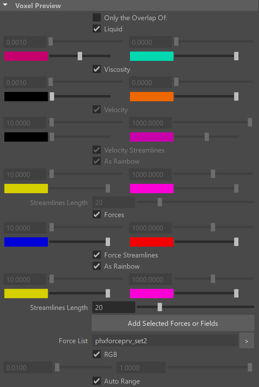

Voxel Preview
The Voxel Preview displays the Grid Channel content of each cell. Phoenix can only preview the channels present in the cache file for the current frame. All enabled channels are drawn if their content is between the corresponding thresholds.
To see the list of available channels and their ranges for an input sim cache, go to the Cache File Content section of the Liquid Simulation rollout. You can also find more info on the Grid Channel Ranges page.
Note that you can also specify the Voxel Preview value range for any Grid Channel, if you disable the Auto Range option.
For example, you could enable only Visosity, and specify the range to be between 0.7 and 1.0, so that you can see where the liquid is getting more viscous. Grid Viscosity Channel values that are below 0.7, or above 1.0, would not appear in the preview at all.
Only the Overlap Of: | andReduction – When enabled, all of the enabled channels below in a cell must meet the selected threshold conditions to visualize the cell.
Liquid | viewTemp, viewTempColor, viewTempColor2, viewTempThreshold, viewTempThreshold2 – Enables the representation of the liquid.
Viscosity | viewVisc, viewViscColor1, viewViscColor2, viewViscThreshold1, viewViscThreshold2 - Enables the representation of the viscosity.
Velocity | viewVel, viewVelColor, viewVelColor2, viewVelThreshold, viewVelThreshold2 – Enables the representation of the velocity.
Velocity Streamlines | viewVelStreamlines, viewVelStreamlinesThreshold, viewVelStreamlinesThreshold2, viewVelStreamlinesColor, viewVelStreamlinesColor2 – Traces the velocity field of the cache files to generate a streamline preview.
As Rainbow | viewVelStreamlinesColorCurve – Represents the Velocity Streamlines in rainbow colors, where red is the fastest, green is medium speed and blue is the slowest.
Streamlines Length | viewVelStreamlinesMaxIterations – Signifies the maximum length of each streamline in the preview. Adjusting the value will provide you with a guide/preview of the velocity field's motion. The Streamline's length is measured in voxels and at the lowest setting, the Streamlines will be no larger than a voxel.
The Velocity Preview is inactive when the Forces Preview is enabled, and vice versa. Similarly, the Velocity Streamlines Preview is inactive when the Force Streamlines Preview is enabled, or the other way around.
Forces | viewForce, viewForceColor, viewForceColor2, viewForceThreshold, viewForceThreshold2 – Enables preview of how Phoenix forces and standard Maya fields will affect the simulation. This preview can be shown even without any loaded simulation.
Add Selected Forces or Fields - When a native Maya or Phoenix force and a Phoenix Simulator are selected, the selected force will be added to the Forces preview of the Simulator. This button is a shortcut for adding the selected force to the Force List phxforceprv_set1 which is automatically created with the Phoenix Simulator. You could do this manually by Middle-Mouse-Button drag&drop of the force into the Force List set in the Outliner.
Force Streamlines | viewForceStreamlines, viewForceStreamlinesThreshold, viewForceStreamlinesThreshold2, viewForceStreamlinesColor, viewForceStreamlinesColor2 – Enables a streamline preview of how Phoenix forces or standard Maya fields will affect the simulation. This preview can be shown even without any loaded simulation.
As Rainbow | viewForceStreamlinesColorCurve – Represents the Force Streamlines in rainbow colors, where red is the fastest, green is medium speed and blue is the slowest.
Streamlines Length | viewForceStreamlinesMaxIterations – Signifies the maximum length of each streamline in the preview. Adjusting the value will provide you with a guide/preview of the force field's motion. The Streamline's length is measured in voxels and at the lowest setting, the Streamlines will be no larger than a voxel.
Unlike other voxel preview channels which use the size of the loaded cache, the Forces preview can also work without a loaded cache and will use the grid size of the Simulator.
Additionally, some Phoenix forces and standard Maya fields such as the Drag force are not supported yet, are shown as if their velocity is always 0 and will not be visible. In addition, forces that act differently depending on the quantity of content in the grid (e.g. amount of liquid, smoke, or no content) are not yet supported by the preview.
RGB | viewUVW, viewUVWThreshold, viewUVWThreshold2 – Enables the representation of the RGB channel or the Wavelet channel, depending on which one is being used.
Auto Range | viewAutoRange – When enabled, automatically adjusts the preview ranges of visible channels for the current frame so that important data is always visible and the preview is always quick.

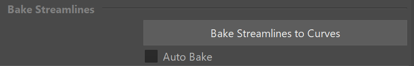

Bake Streamlines
Bake Streamlines to Curves  Button for converting the currently shown Streamline preview (either Velocity Streamlines or Force Streamlines) into native Maya curves. The baked curves can be rendered like any regular Maya curve by using the V-Ray Renderable Curves node.
Auto Bake | autoBakeStreamlineCurvesOnPreviewChange – Enables automatic Streamlines to Curves baking on any change in the Streamlines Preview. While the Auto Bake option is enabled you don't have to press the Bake Streamlines button in order for scene changes to be applied to the curves and changing the timeline frame will update the baked curves.

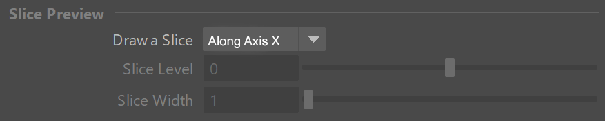

Slice Preview
The Slice preview displays only a single slice of voxels which can be convenient for debugging and fine-tuning a simulation.
Draw a Slice | viewSliceAxis – When enabled, only a voxel-thick cross-section of the grid is visible. This works for voxels, particles, and velocity streamlines, but not for the GPU Preview or the Mesh Preview. It allows for a better view of occluded details and can help when previewing very rich data such as velocity fields, or in order to see underwater cavities.
Along Axis X, Y, Z – Slices the grid along the specified axis.
Disabled
 – Turns the Draw Just a Slice feature off.
Slice Level | viewSliceLevel – Specifies the offset of the slice from the bottom center of the grid in voxels.
Slice Width | viewSliceWidth – Specifies the width of the slice in voxels.
