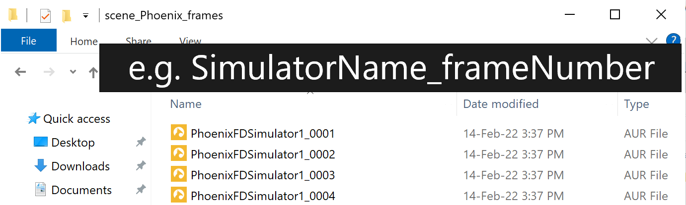

When running a new simulation, Phoenix saves each simulated frame in a cache file with a .aur or .vdb extension, numbered using the frame index. By default, the cache files are stored under the data folder of the Maya project folder. They are put in a folder with the same name as the scene and with "_Phoenix_frames" appended:
Inside the cache folder, the default names use the simulator's name. For example, a simulator named "PhoenixFDSimulator1" outputs these cache files:
You can manually change the output path from the Output rollout. After Phoenix has created the .aur frame cache files, you can preview them in the viewport and render them using V-Ray or another renderer.

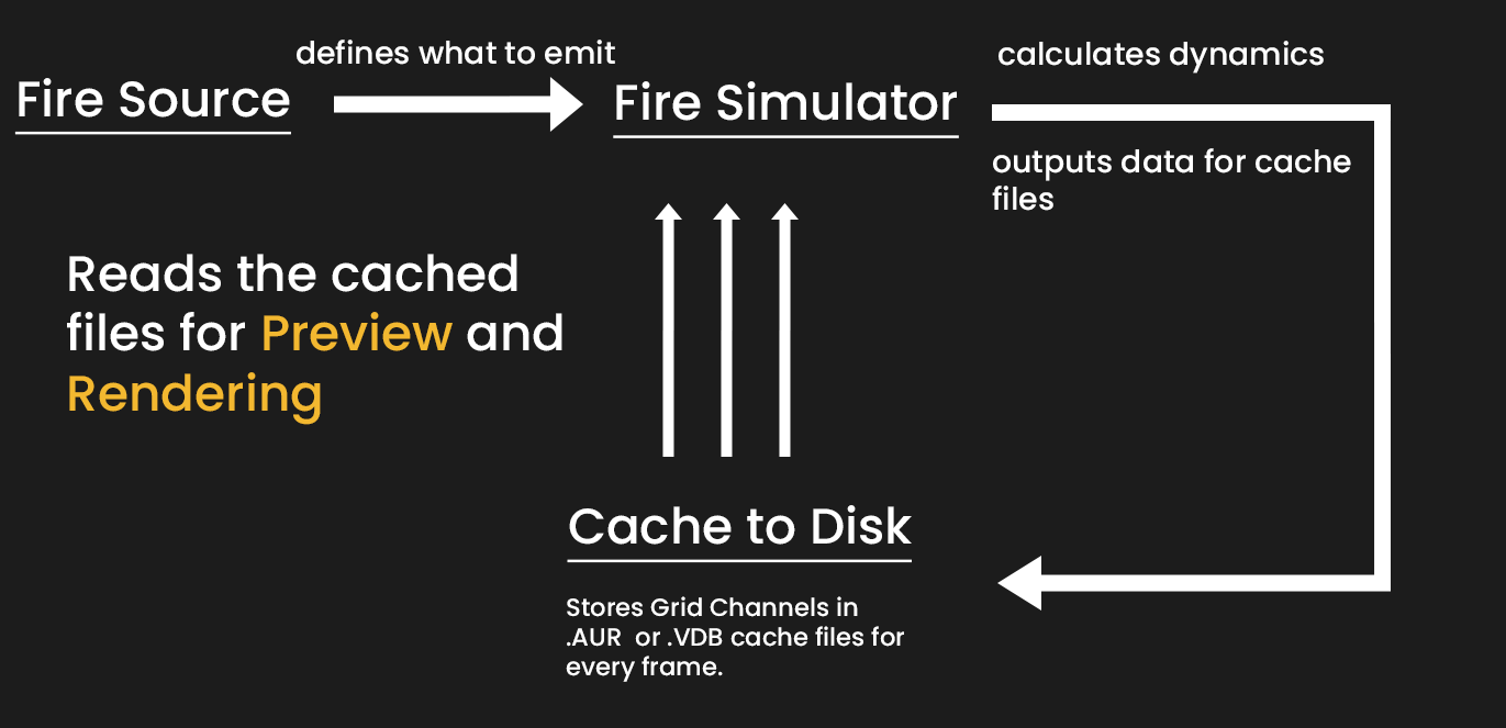

The diagram illustrates the basic simulation workflow.

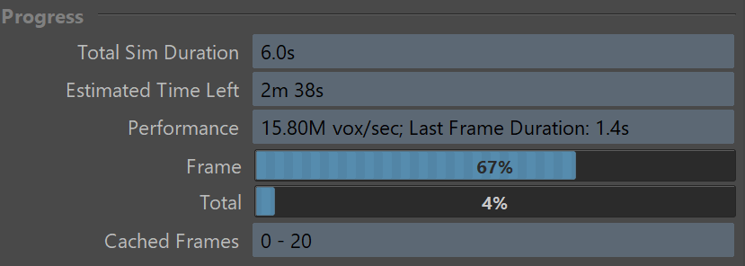

Progress
This section of the UI displays information on the current simulation.
Total Sim Duration – The amount of time the simulation has run.
Estimated Time Left – Estimated time until the simulation reaches the set Stop frame.
Performance – How much time since the last frame was calculated and the frame calculated per second.
Frame – Percentage of the current frame calculated.
Total – Percentage of total simulation complete.
Cached Frames – Shows the frame range which contains simulated caches.

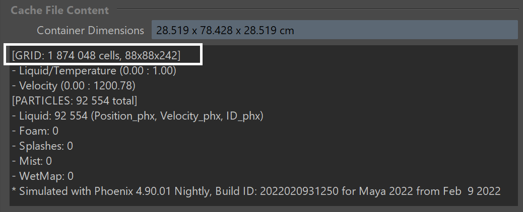

Cache File Content
This area displays information on the current simulation. Any data from channels that have been loaded into the simulator are shown. This includes the minimum and maximum ranges for each channel. Check the Grid Channel Ranges and Particle Channel Ranges pages for more information.
Note that the Container Dimensions show the loaded cache size as seen in the scene, in the currently selected units. This size is not multiplied by the Scene Scale parameter from the Grid rollout. If you want to see how big the container is as seen by the Phoenix simulator when the Scene Scale parameter is used, check the Total Cells info in the Grid rollout.

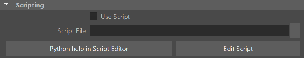

Scripting
For more information and examples, please see the Scripting documentation.
Use Script | useScript – Enables using Mel or Python script during the simulation.
Script File | scriptFile – Specifies the Mel or Python script file to use during the simulation.
Python help in Script Editor – Shows quick usage information about the phxfd Python module inside the Script Editor.
Edit Script – Opens the script file in the default external editor.

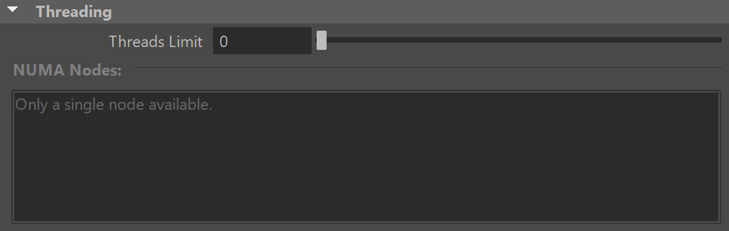

Threading
Threads Limit | threadsLimit – Specifies an upper limit on the number of threads used for the simulation. When the value is set to 0, the maximum number of threads (cores) will be used.
NUMA Node Start | NUMANode0 – If the value of Threads Limit is 0, this parameter specifies the starting index of the NUMA nodes that will be used for simulation.
NUMA Node End | NUMANode1 – If the value of Threads Limit is 0, this parameter specifies the end index of the NUMA nodes that will be used for simulation.
Note: NUMA stands for Non-Uniform Memory Access and currently is available only on Windows. NUMA can be used to restrict the threads used for simulation based on the physical CPUs available on the system (in multiprocessor systems). In this way, better memory access can be achieved when multiple simulations are run on the same machine.
