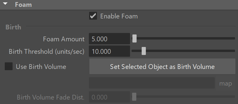

Enable Foam | foamEnbl – Enables the birth and simulation of Foam particles.
Birth
Foam Amount | foamBirthRate – How many foam particles are born in the places where the Birth Threshold condition is met, in particles per cubic centimeter, per second. This parameter does not affect the foam born by splashes.
Birth ThresholdfoamBirthTresh – Foam is born where the liquid movement is turbulent. If the difference in velocity between two neighbor voxels is higher that this threshold, foam particles should be born. This means that the lower this option is, the more foam will be born and also the more places in the simulator would allow foam to be born. The scale of the option is in units/sec.  For more information, see the Birth Threshold example below.
Use Birth VolumeuseFoamBirthVolume – When enabled, allows the foam to be born naturally by the simulation only inside a specified geometry object. This includes foam born according to the conditions set by the Foam Amount and Birth Threshold parameters of the Foam, as well as the Foam on Hit parameters of the Splash. The foam born inside the Birth Volume can travel outside the volume without a problem. The difference between this approach and spawning foam inside a volume manually from a Source object is that using a Birth Volume, the foam birth will follow the simulation criteria of the simulation and will look and behave more naturally.
Set Selected Object as Birth Volume - When a polygon mesh and a Phoenix Simulator are selected, the selected object will be used as the Birth Volume for the generation of Foam particles in this simulator.
Birth Volume | foamBirthVolume – Specifies a geometry object to confine foam particles. To do this, select the simulator and the confine geometry, and hit the Set Selected Object as Birth Volume button.
By default, the birth volume geometry is not automatically converted to a non-solid and it will behave as a rigid body in your simulation. In this case, you can still use the Birth Volume Fade Dist to expand an area around the object where Foam/Splash births are possible. You can convert the geometry to a non-solid from its Phoenix FD Extra Attributes in order to allow liquid to exist inside it as well.
Also note that birth volumes will interact with the simulation even if they are hidden. If you wish, you can exclude the Birth Volume from the Scene Interaction rollout.
Birth Volume Fade Dist | foamBirthVolumeFade – Controls how far the foam particles will spawn around the specified Birth Volume geometry object, in world units.

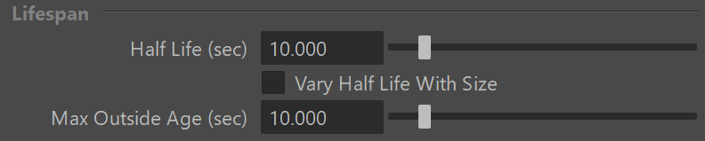

Half Life (secs) | foamHalflife – The time required for the particles to reduce to half of their initial count, in seconds. Affects only the foam bubbles above the liquid surface; those inside the volume will not burst until they reach the surface. You can force this process by increasing the Rising Speed.
Vary Half Life With Size | foamHalfLifeVary – In nature, not all the bubbles have the same half life. Larger bubbles burst quicker than smaller ones, and bubbles inside foam live longer. When this option is enabled, the Half life of each bubble is modified taking into account its size and its surroundings.
Max Outside Age (secs) | foamOutsideLife – If a particle is outside the grid, and its age (in seconds) exceeds this parameter, the particle will be killed instantly. Note that this is not the time since the particle exited the grid, but the time since the particle was born.

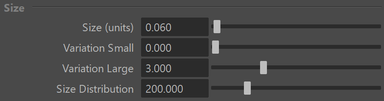

Size (units) | foamSize – Specifies the size of the bubbles.
Larger bubbles rise faster while they are underwater, while smaller ones rise more slowly.
Variation Small | foamDownVary – Specifies how much smaller the bubbles can be, relative to the Size parameter. 0 means that all bubbles are always at least as big as Size. 1 means that the smallest bubbles are two times smaller than Size. 10 means that the smallest bubbles are 11 times smaller than Size. For more information, see the Variation Small example below.
Variation Large | foamSizeVar – Specifies how much larger the bubbles can be, relative to the Size parameter. 0 means that all bubbles are never larger than Size. 1 means that the largest bubbles are two times larger than Size. 10 means that the largest bubbles are 11 times larger than Size. You can also use the Size Distribution parameter to control the balance between the number of small and large bubbles. For more information, see the Variation Large example below.
Size Distribution | foamSizeDistr – Specifies how many times the amount of bubbles with radius Size exceeds the amount of the largest bubbles. This option has no effect if Variation Large is 0. Setting Distribution to 0 means that all sizes will be equally distributed. 100 means that there will be 100 times more bubbles with radius of Size than the largest ones. For more information, see the Size Distribution example below.

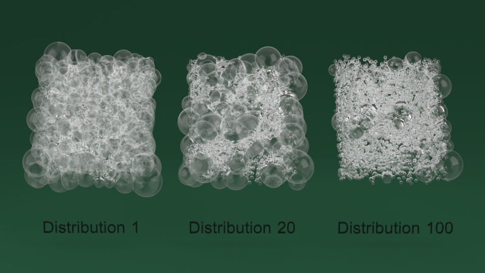

Example: Size Distribution
The image below provides more details on the differences between Size Distribution values of 1, 20, and 100.

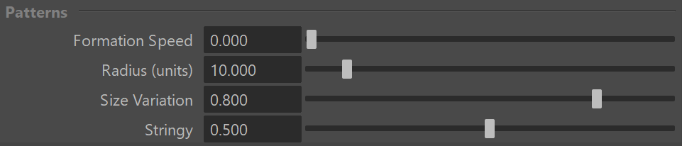

Formation Speed | fptrn – Controls the rate of formation of foam patterns. In nature, these are caused by liquid flows rising to the surface and pushing the foam aside. For more information, see the Formation Speed example below.
Radius (units) | foamPatternSize – The average radius in scene units of a single circular pattern core.
Size Variation | fptrnszvar – Creates several larger patterns and many smaller ones. If set to 0, all patterns will have equal sizes.
Stringy  | fptrnstringy – Higher values will cause the formation of thin, long strings between the patterns.
