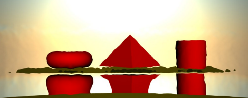

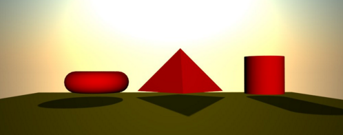

Heat Haze | rendHeatHaze – Traces the ray changing direction according to the gradient of the Surface channel. A value of 1 corresponds approximately to the normal heat haze in the air caused by the temperature. If smoke or another channel is selected as the source, a larger value might be necessary to achieve a visible result. A value of 0 produces no heat haze. This parameter is available only when Mode is set to Volumetric Heat HazeSee the Heat Haze example below.
Example: Heat Haze
Heat haze adds refraction at each ray-marching step through the volume. This only affects the camera's view. Heat haze will not affect shadows cast through a volume.
Heat haze: 0
Heat haze: 1
