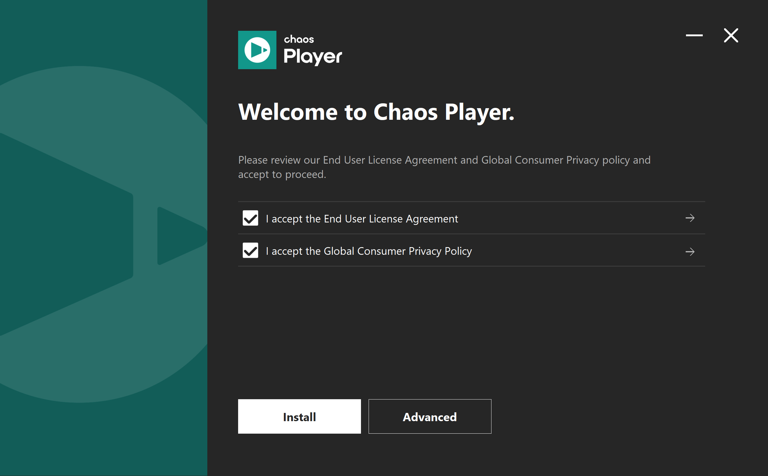

Run the installer.
  1. Carefully read the End User License Agreement and the Global Consumer Privacy Policy. Enable the checkboxes if you agree to the terms. Click on the Install button to proceed with a standard installation.
If you need to customize your installation, press the Advanced button.

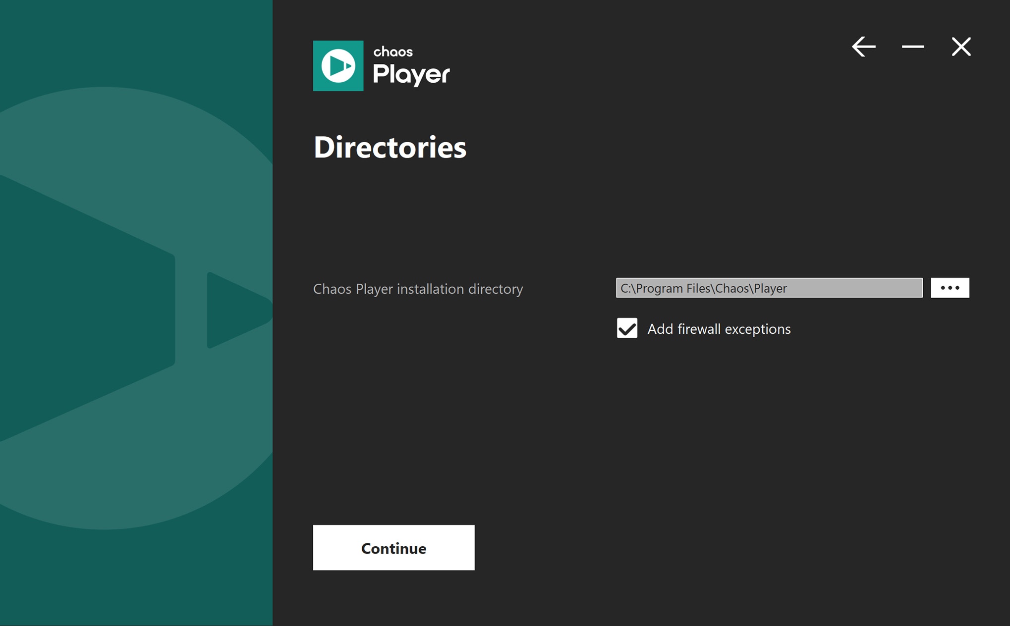

Directories
Here you can specify the installation path.
The image shows the default path for Windows. Player will install in /usr/Chaos/Player on Linux, and /Applications/Chaos/Player on macOS by default.
Add firewall exceptions – Automatically adds firewall exceptions so Chaos Player can run uninterrupted.

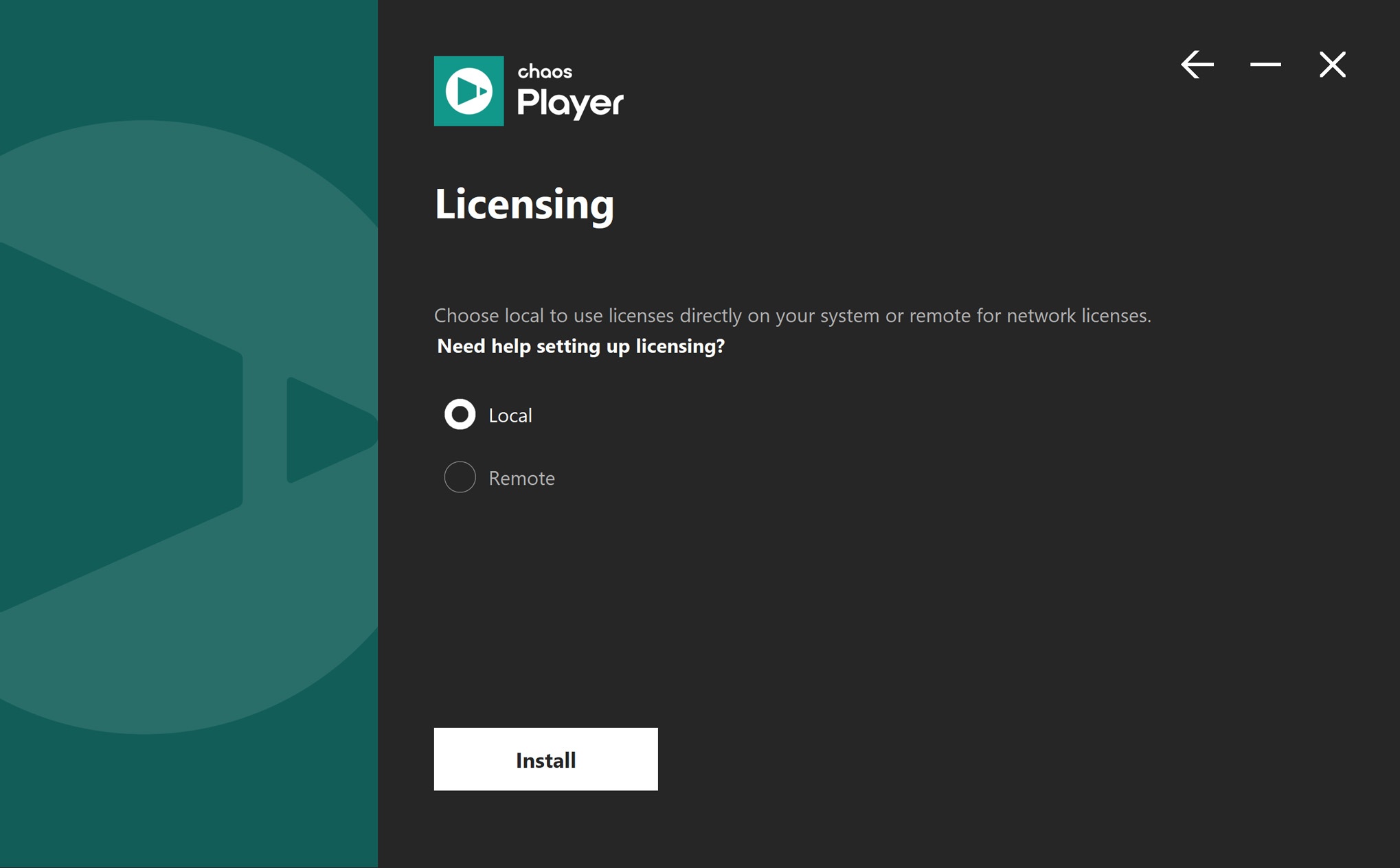

Licensing
In this step, you can specify whether the Chaos License Server runs locally or on another machine.
Local – This option installs the License Server on your machine. For a walkthrough, see the Chaos License Quick Start Guide.
Remote – This option allows you to configure your Chaos product for floating licenses in a local network. Fill in the IP address of the Chaos License Server in your network in the Primary License Server field. Please leave the port 30304 unchanged. For more details on this setup, see the License Server Deployment page.

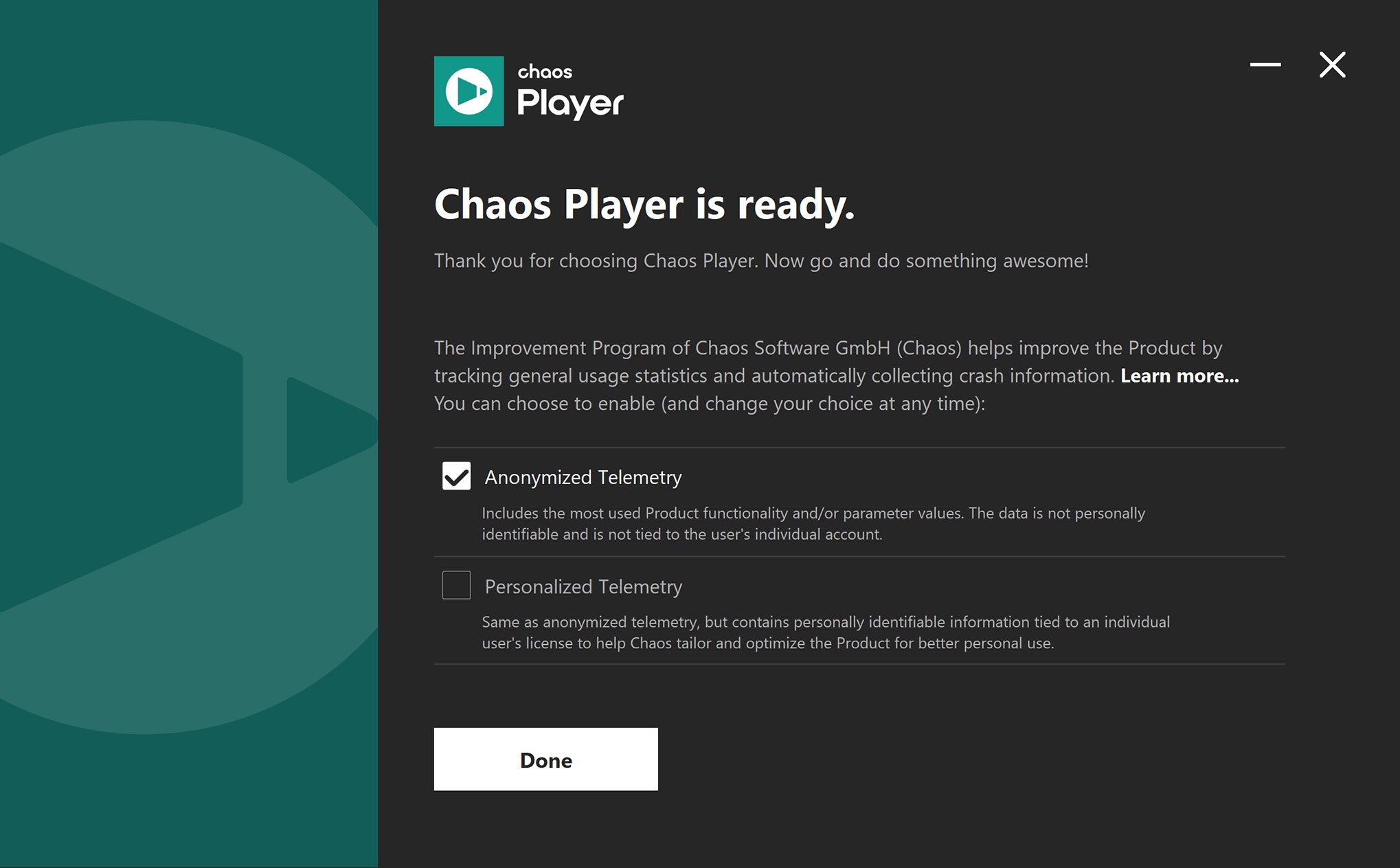

2. After you click the Install button, the wizard uninstalls any previous versions and installs Chaos Player on your machine.
At the end of the installation you can choose to participate in the Chaos feedback program. No intelligence property is violated when agreeing to participate in the feedback program. Chaos does not gather scenes, assets, materials, etc. This preference can be changed anytime by running the installer again. See the Chaos Telemetry page for more details.
Anonymized Telemetry – Includes the most used product functionality and/or parameter values. The data is not personally identifiable and is not tied to the user's individual account.
Personalized Telemetry – Includes the most used product functionality, parameter values, but also contains personally identifiable information tied to an individual user's license. This helps Chaos tailor and optimize the product for better personal use.
