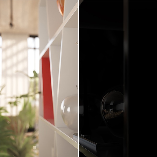

beauty render Before image

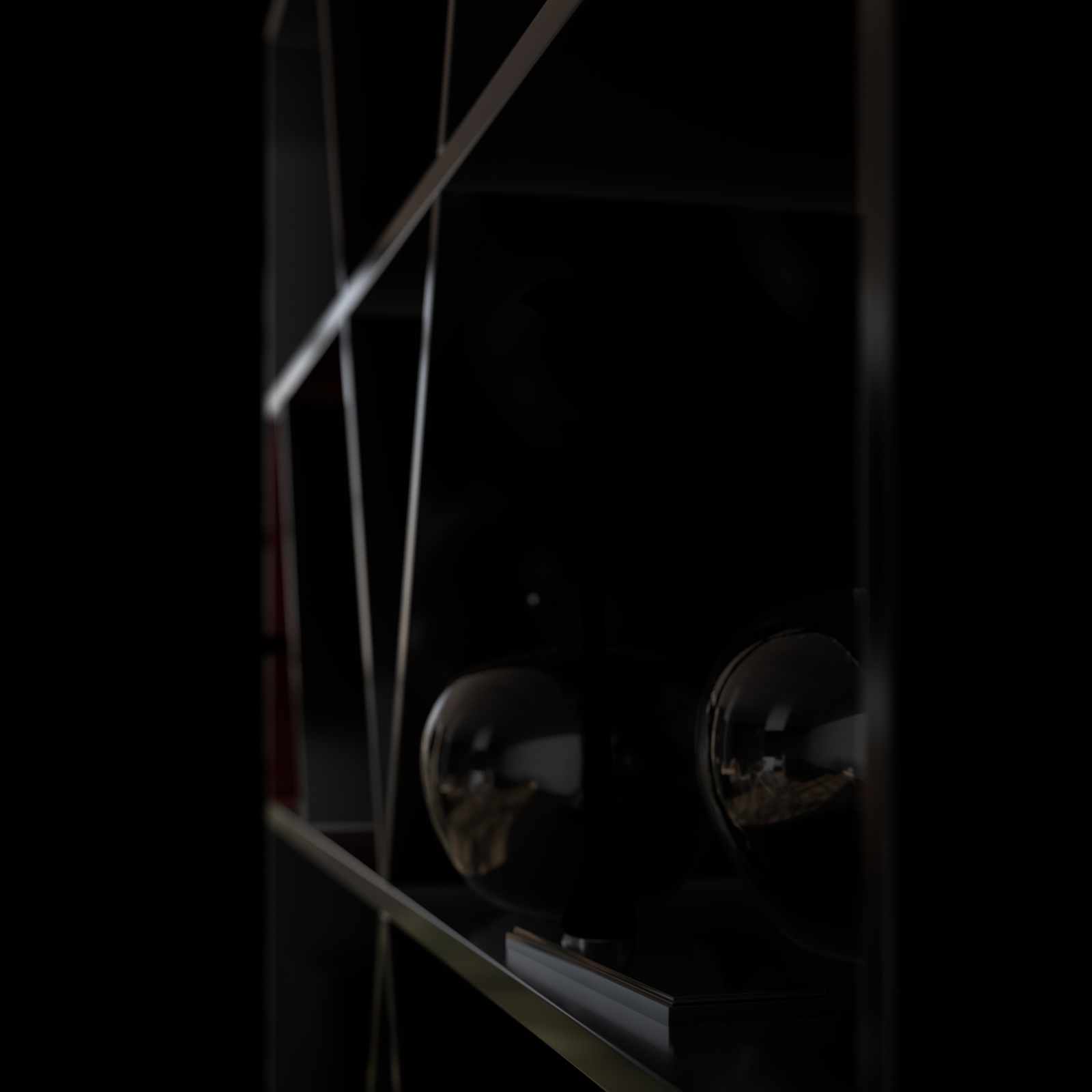

coat reflection channel After image

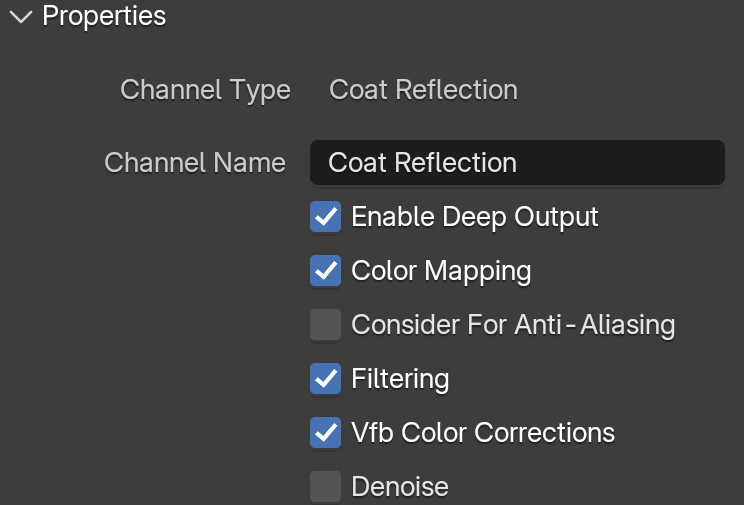

Properties
Enable Deep Output Specifies whether to include this render channel in deep images.
