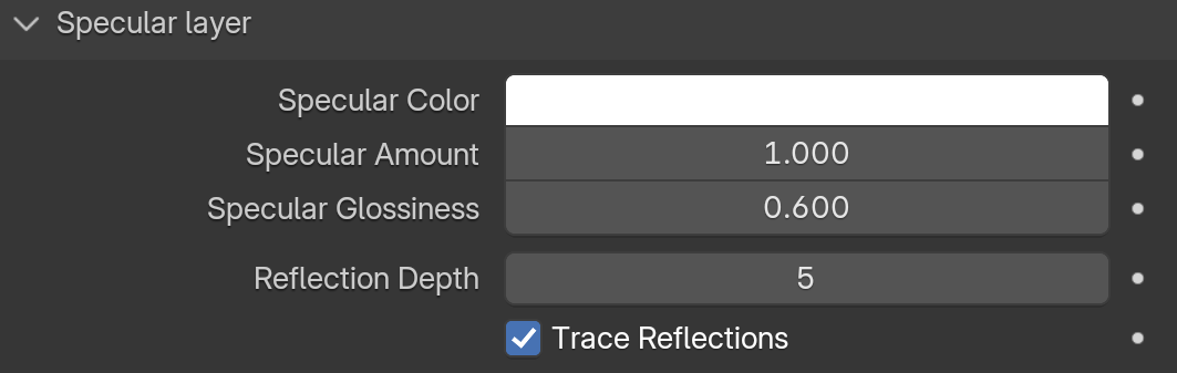

Specular layer
Specular Color – Specifies the specular color for the material. A node can be connected to the input socket of this parameter to control it.
Specular Amount – Specifies the strength of the specular component for the material. Note that there is an automatic Fresnel falloff applied to the specular component, based on the Index of refraction of the material. A node can be connected to the input socket of this parameter to control it.
Specular Glossiness –  Determines the glossiness (highlights shape). A value of 1.0 produces sharp reflections, while lower values produce more blurred reflections and highlights. A node can be connected to the input socket of this parameter to control it.
Reflection Depth – Specifies the number of reflection bounces for the material.
Trace Reflections – Enables the calculations of glossy reflections. When disabled, only highlights are calculated.

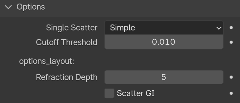

Options
Single Scatter – Controls how the single scattering component is calculated.
None – No single scattering is applied.
Simple
– Approximates the single scattering component from the surface lighting. This option is fast and useful for relatively opaque materials like skin, where light penetration is normally limited.
Raytraced (solid) – Accurately calculates the single scattering component by sampling the volume inside the object. Only the volume is raytraced; no refraction rays on the other side of the object are traced. This is useful for materials with a more pronounced sub-surface scattering effect, like marble or milk, which at the same time are relatively opaque.
Raytraced (refractive) – Similar to the Raytraced (solid) mode, but in addition refraction rays are traced. This option is useful for transparent materials like water or glass. In this mode, the material also produces transparent shadows.
Cutoff Threshold – Specifies a threshold below which reflections are not traced. V-Ray tries to estimate the contribution of reflections to the image, and if it is below this threshold, these effects are not computed. Do not set this to 0.0, as it may cause excessively long render times in some cases. This parameter is not available when the render engine is set to CUDA.
Refraction Depth – Determines the depth of refraction rays when the Single Scatter parameter is set to Raytraced (refractive) mode.
Scatter GI – Determines whether the material accurately scatters global illumination. When disabled, global illumination is calculated using a simple diffuse approximation on top of the sub-surface scattering. When enabled, global illumination is included as part of the surface illumination map for multiple scattering. Enabling this option creates more accurate renders, especially for highly translucent materials, but it may slow down the rendering quite a bit.
