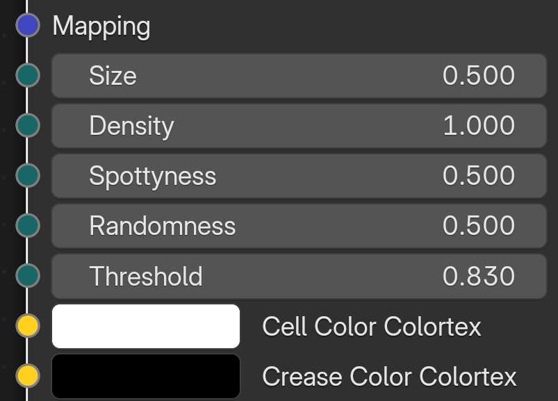

MappingAllows a UVW Mapping, or a UVW Randomizer node to be connected to determine the ramp's mapping.
Size (input socket) – Allows an integer-outputting node to be connected as the Size parameter.
Density (input socket) – Allows an integer-outputting node to be connected as the Density parameter.
Spottyness (input socket) – Allows an integer-outputting node to be connected as the Spottyness parameter.
Randomness (input socket) – Allows an integer-outputting node to be connected as the Randomness parameter.
Threshold (input socket) – Allows an integer-outputting node to be connected as the Threshold parameter.
Cell Color Colortex – Allows a color node to be connected as the Cell Color parameter.
Crease Color Colortex – Allows a color node to be connected as the Crease Color parameter.

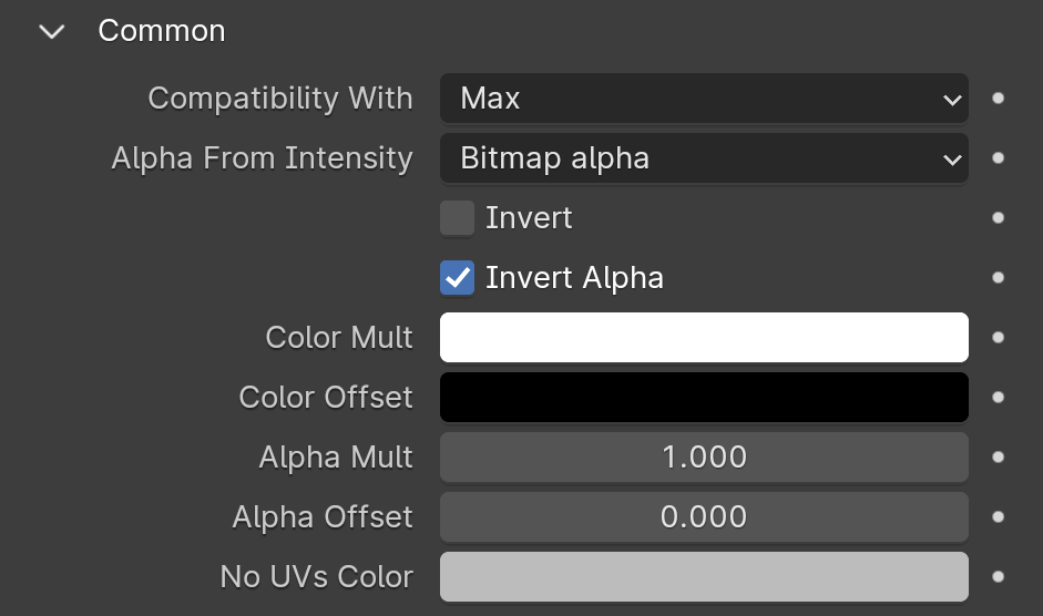

Compatibility With – Select the compatibility type of the exported map from Max or Maya.
Alpha From Intensity – Specifies where to take the alpha from.
Bitmap alpha – This is the default setting. With this option selected, V-Ray renders the material the same on both sides.
Color intensity/luminance – Renders the back side of polygons as invisible for the camera.
Force opaque – Renders the back side of polygons as invisible to all rays, except shadow rays.
Invert – Enable to invert the color of the texture.
Invert Alpha – Enable to invert the texture alpha. Please note that the Invert option has to be enabled, otherwise only the color is inverted.
Color Mult–  Corrects the color of the texture by multiplying the RGB color values in the texture with the RGB color values specified here.
Color Offset  Corrects the color of the texture by adding the RGB color values specified here to the RGB color values of the texture.
Alpha Mult – Specifies a multiplier for the texture alpha.
Alpha Offset – Specifies an additional offset for the texture alpha.
No UVs Color  Specifies a default color used for polygons with no valid UVs. In case the map is not tiled, specifies a default color that is used outside the texture square.  When a texture is selected, it overrides the color as long as the texture checkbox is enabled.

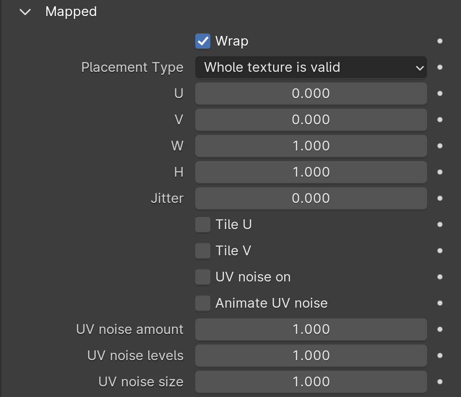

Wrap – When enabled, wraps the texture back when it goes outside of the placement area.
Placement Type – Select how to place the texture.
Whole texture is valid
Crop
Place
U – U coordinate of the texture sector.
V – V coordinate of the texture sector.
W – W coordinate of the texture sector.
H – Specifies the height of the texture sector.
Jitter – Specifies a randomization value for the UV placement.
Tile U/ Tile V – Enable to choose between horizontal or vertical tiling.
UV noise on – Enables the noise.
Animate UV noise – If enabled, the noise is animated. Use the UV noise phase to animate the noise.
UV noise amount – Specifies the UV noise amount.
UV noise levels – Specifies the UV noise iterations.
UV noise size – Specifies the UV noise size.

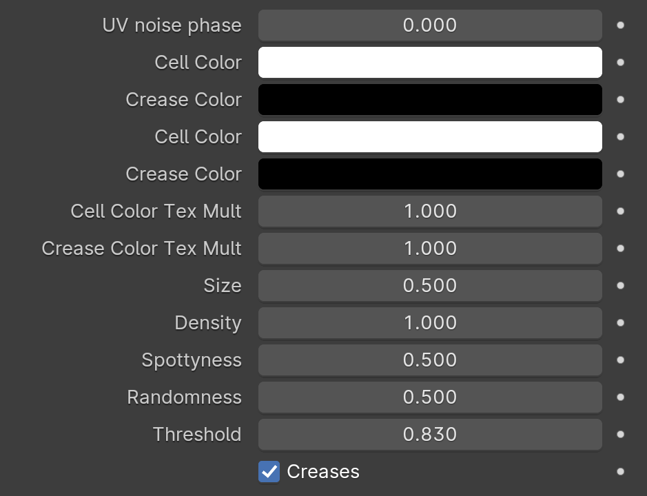

Cell Color – Controls the color of the cells.
Crease Color – Controls the color of the creases.
Cell Color Tex Mult – Blends between the color and a texture, if specified.
Crease Color Tex Mult – Blends between the color and a texture, if specified.
Size – Controls the size of the procedural texture.
Density – Controls how close the cells are placed next to each other.
Spottiness – Controls how circular the cells appear.
Randomness – Controls how randomly the cells look in relation to each other.
Threshold – Controls the transition between the Cell Color and Crease Color.
Creases – Enables and disables creases.
