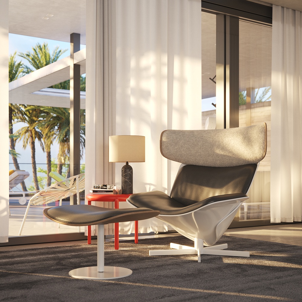

The Mtl 2 Sided Material is a utility material provided with the V-Ray renderer. The material allows the light to be seen on the backside of objects.
Use this material to simulate thin translucent surfaces like paper, cloth curtains, tree leaves, etc.
