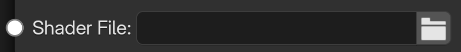

Shader File (input socket) – Specifies the .glsl, .frag, or .pfrag file that contains the shader code. The file can either be connected directly (using a Selector node) or chosen from the button.

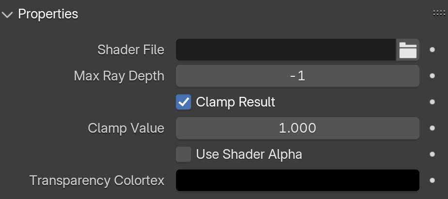

Shader File – Specifies the .glsl, .frag, or .pfrag file that contains the shader code. The file can be chosen from the button.
Max Ray Depth – Specifies the maximum reflection/refraction depth for the shader.
Clamp Result – Determines whether to force the result in the [0, Clamp Value] range or not.
Clamp Value – Specifies the upper clamp limit if Clamp Result is enabled.
Use Shader Alpha – Uses the alpha calculated in the shader.
Transparency Colortex – Overrides the alpha if Use Shader Alpha is disabled.
