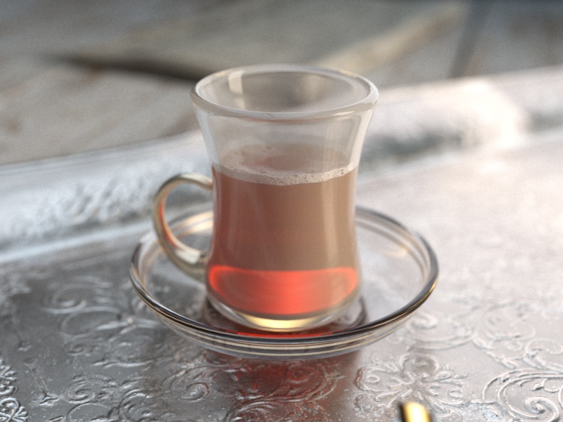

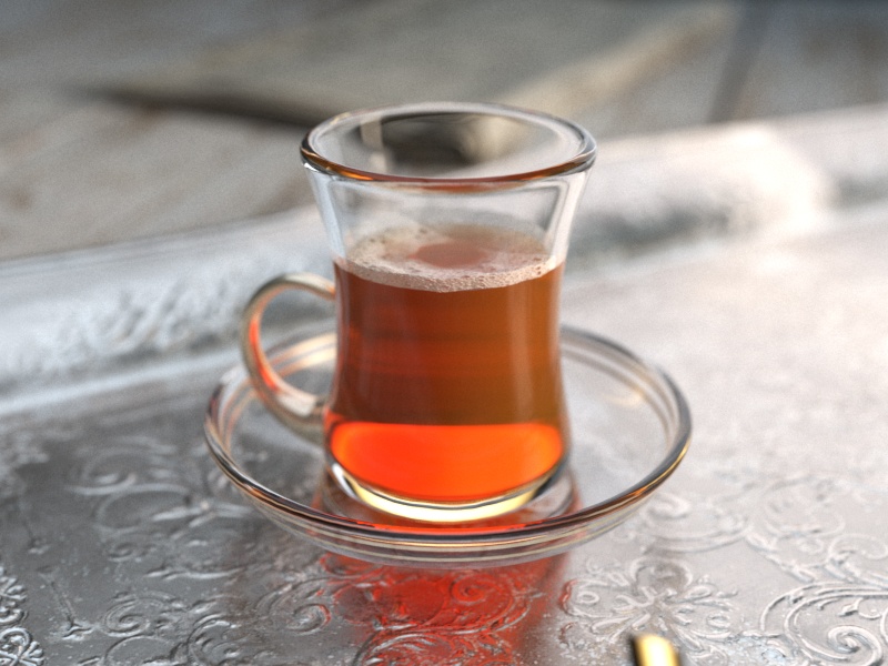

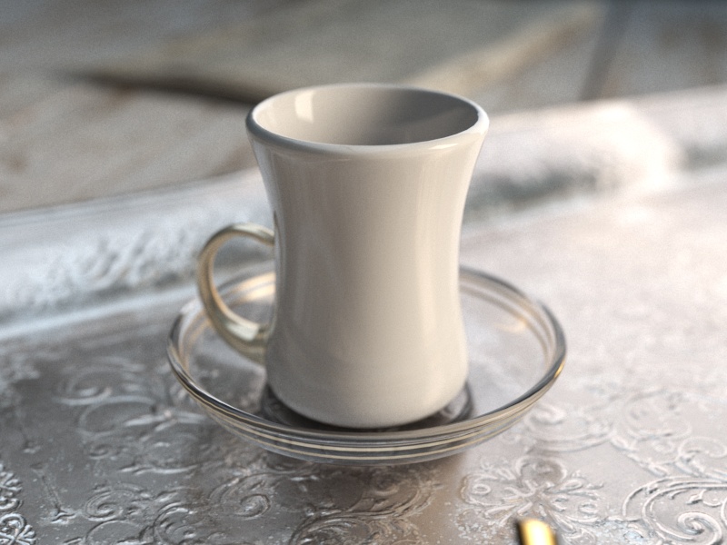

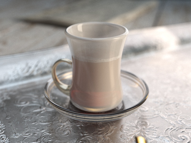

Refraction Color = 0.0, 0.0, 0.0

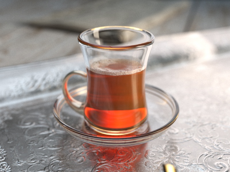

Refraction Color = 0.4, 0.4, 0.4

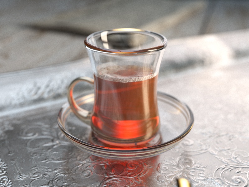

Refraction Color = 0.7, 0.7, 0.7

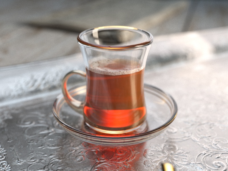

Refraction Color = 1.0, 1.0, 1.0
Black (0.0, 0.0, 0.0)
White (1.0, 1.0, 1.0)

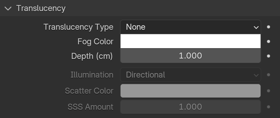

Translucency
Translucency Type – Selects the algorithm for calculating translucency (also called sub-surface scattering). Note that Refraction must be enabled for this effect to be visible. See the example.
None – When selected, the only available parameters are the Fog Color and Fog Depth. Together with the Refraction Color, they determine the attenuation of light as it passes through the material. In this mode, there is no subsurface scattering.
Volumetric  – Works together with the Refraction Color to scatter light inside the object. This type is useful for liquids and other highly transparent materials. The Refraction Color and Refraction Glossiness determine, respectively, how much of the interior of the object is visible and how rays interact with the object’s surface.
SSS  – Works independently of the Refraction Color/Glossiness and is useful for skin, wax, marble, and other relatively opaque materials.
Fog Color / Scatter RadiusControls the absorption of the material. A node can also be used to control this property.
Depth (cm) / Scale (cm) –  Controls the strength of the fog effect. Higher values reduce the effect of the fog, making the material more transparent. Smaller values increase the fog effect, making the material more opaque.
Illumination – Determines how direct illumination is computed for sub-surface scattering.
Directional – The directional method tends to propagate more light in the direction from which the surface is lit.
Uniform – The uniform method spreads light more uniformly inside the material. Note that it is not supported on V-Ray GPU.
Scatter Color / SSS ColorControls the scattering. A node can also be used to control this property.
SSS Amount – Blends between full scattering and pure refraction. A node can also be used to control this property.

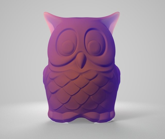

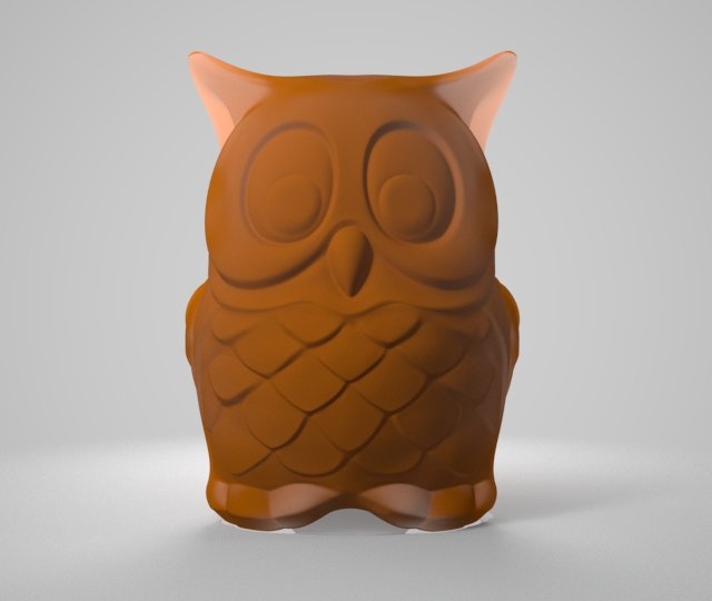

This example demonstrates the effect of the Translucency Type parameter. Note that refraction must be enabled for this effect to be visible. The Diffuse Color is red (0.9;0.225;0), and the Scatter Color is blue(0; 0; 0.9); Refraction Color (0.822; 0.822; 0.822) and Fog Color (0.697; 0.697; 0.697) are set to light gray.
None
Volumetric model
SSS model

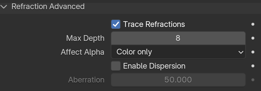

Refraction Advanced
Trace RefractionsEnables refractions for the current material.
Max DepthThe number of times a ray can be refracted. Scenes with lots of refractive and reflective surfaces may require higher values to look correct.
Affect Alpha – Allows the user to specify which channels are going to be affected by the transparency of the material.
Color only – The transparency affects only the RGB channel of the final render. This is the default value.
Color+alpha – This mode causes the material to transmit the alpha of the refracted objects instead of displaying an opaque alpha.
All channels – All channels and render elements are affected by the transparency of the material.
Enable DispersionEnables the calculation of true light wavelength dispersion.
Aberration – Allows the user to increase or decrease the dispersion effect. Lowering it widens the dispersion and vice versa.
