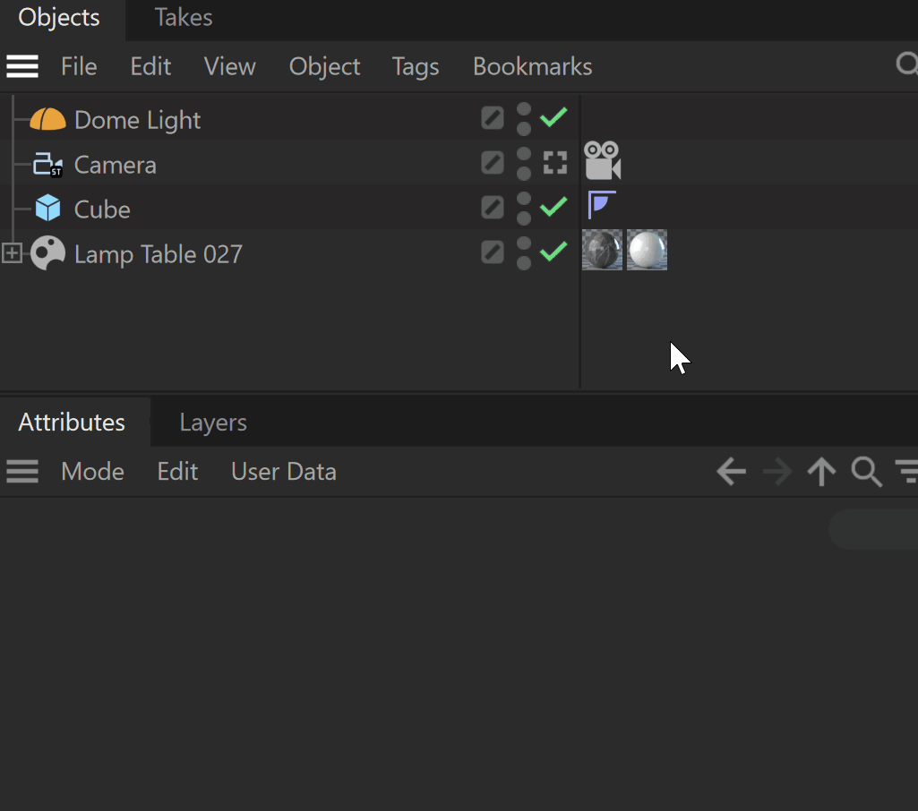

You can access the Luminaire Light's parameters by expanding the Cosmos asset containing the light and selecting the Luminaire Light Source .

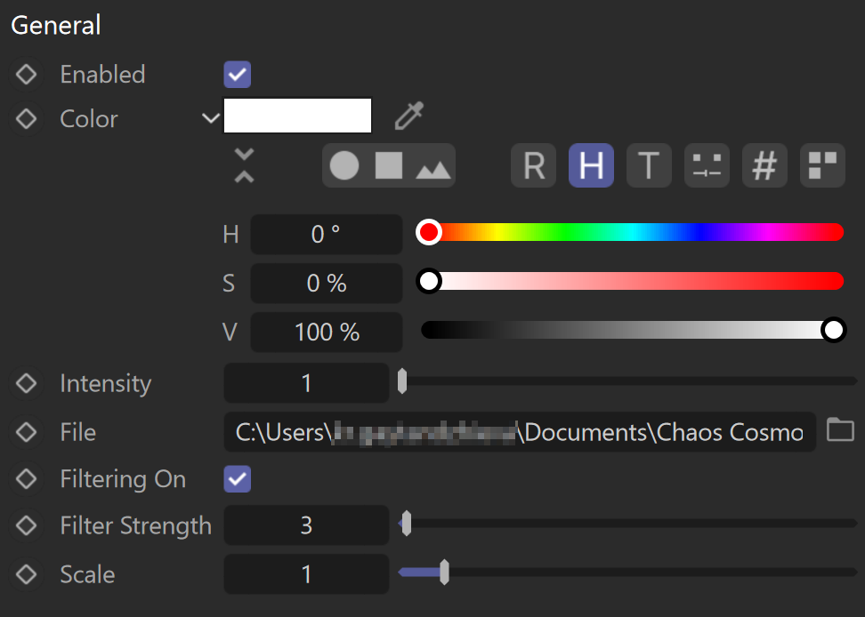

Enabled – Turns the VRayLuminaire light on and off.
Color – Specifies the tint color of the Luminaire Light.
Intensity – Sets an intensity multiplier.
File – Specifies the .vlw file that holds the baked lighting.
Filtering On – Enables stochastic filtering of the light field to reduce aliasing.
Filter Strength – Specifies the strength of the stochastic filtering of the light field.
Lo D On –
Scale – Allows the loaded asset to be scaled up or down.

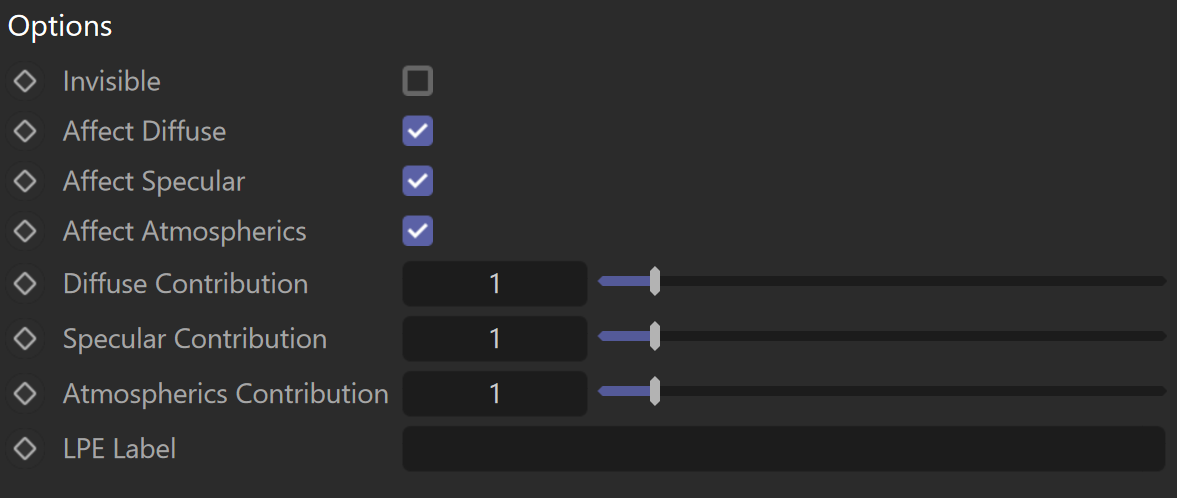

Options
Invisible – Controls whether the shape of the light source is visible in the render result. When this option is enabled, the light source is not visible in the rendering. When this option is disabled, if the light source is seen directly by the camera or through refractions, it appears in renderings in the current light color.
Affect Diffuse – Determines whether the light affects the diffuse properties of the materials.
Affect Specular – Determines whether the light affects the specular properties of the materials. This means glossy reflections.
Affect Atmospherics – When enabled, the light influences the atmospheric effects in the scene. This option is not available with V-Ray GPU.
Diffuse Contribution – A multiplier for the effect of the light on the diffuse component.
Specular Contribution – A multiplier for the effect of the light on the specular component.
Atmospherics Contribution – Determines the amount of influence the light has on the atmospheric effects.
LPE Label – Allows a label to be assigned, which can be used to reference the light in a Light Path Expression. This is especially useful when working with the Light Select render element to evaluate custom light contributions in the scene.

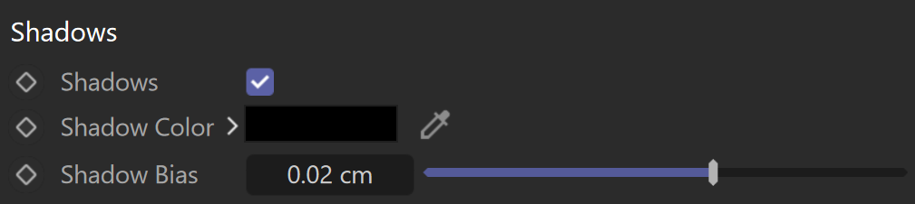

Shadows
Shadows – When enabled (the default), the light casts shadows. Disable this option to turn off shadows for the light.
Shadow Color – Controls the color of shadows for this light. Note that anything different from black is not physically correct.
Shadow Bias – Moves the shadow toward or away from the shadow-casting object (or objects). Higher values move the shadow toward the object(s), while lower values move it away. If this value is too extreme, shadows can "leak" through places they shouldn't or "detach" from an object. Other effects from extreme values include Moire patterns, out-of-place dark areas on surfaces, and shadows not appearing at all in the rendering.

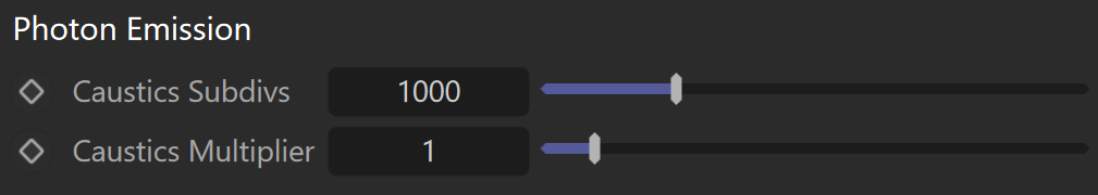

Photon Emission
Caustics Subdivs – Only used when calculating Caustics. Lower values mean more noisy results but render faster. Higher values produce smoother results but take more time.
Caustics Multiplier – This value is a multiplier for the generated caustics by the selected object. Note that this multiplier is cumulative - it does not override the multiplier in the Caustics render settings rollout section.

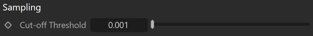

Sampling
Cut-off Threshold – Specifies a threshold for the light intensity below which the light is not computed. This can be useful in scenes with many lights, where you want to limit the effect of the lights to some distance around them. Larger values cut away more of the light; lower values make the light range larger. When this value is 0.0, the light is calculated for all surfaces.

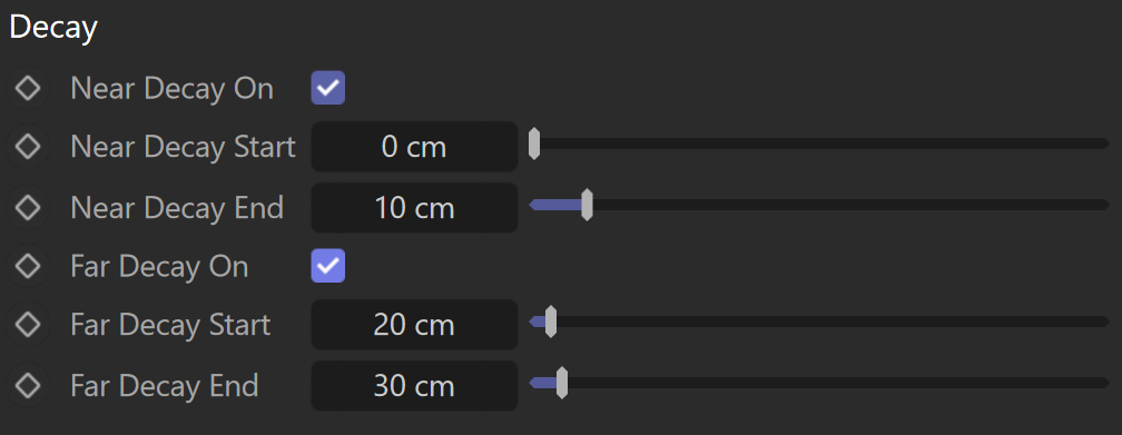

Decay

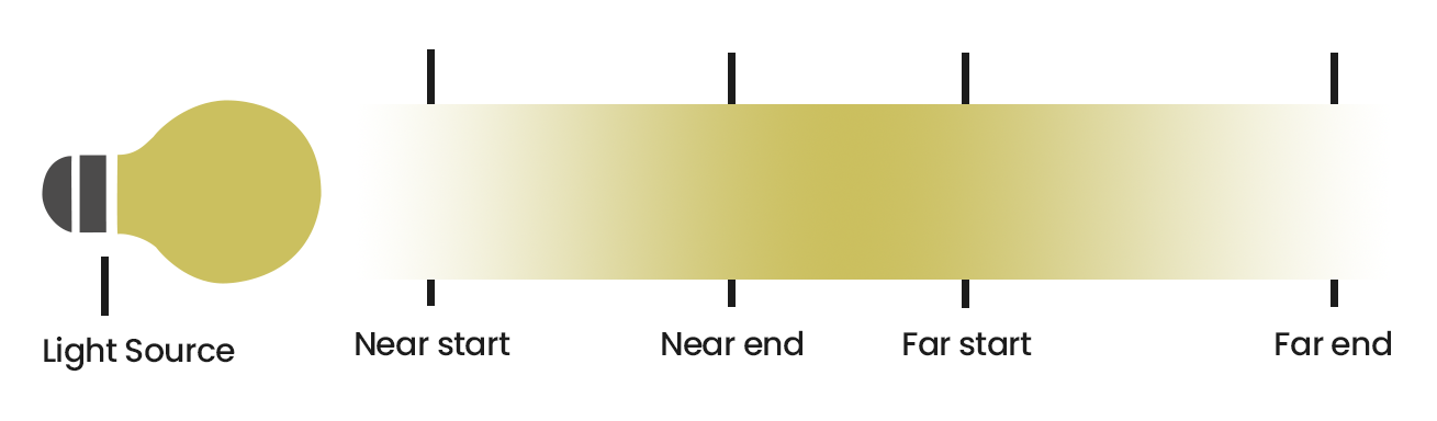

The Decay parameters determine how the light fades in and out. The Near Decay determines how light fades in. The light isn't at its maximum value at its source, but instead gradually increases until it reaches the Near end. The Far Decay determines how light fades out. The light isn't at its maximum value at its end, but instead gradually decreases after the Far start.
The Decay options are useful for creating hotspots or controlling the length of a "God Rays" effect created with Environment Fog.
Near Decay On – Toggles near decay on and off.
Near Decay Start – Determines where the fade in starts. Anything before this point is rendered dark.
Near Decay End – Determines where the fade in ends. After this threshold, the light is at its full value.
Far Decay On – Toggles far decay on and off.
Far Decay Start – Determines where the fade off starts.
Far Decay End – Determines where the light reaches a value of 0, i.e. completely fades off. See the Far Decay End example for more.

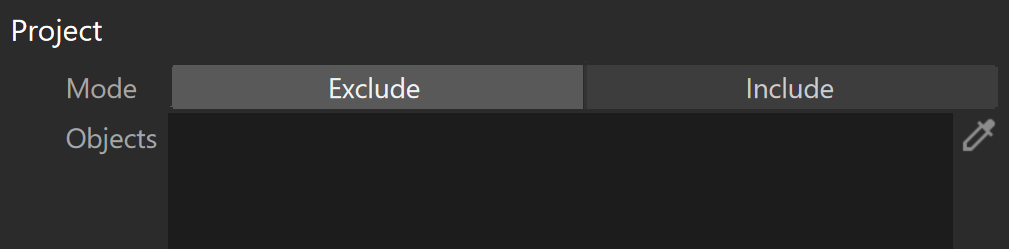

Project
Project is used to create a list of objects that can be excluded (or included) from the light's effects, such as illumination or shadow casting.
Mode – Specifies whether the objects in the list are considered Included or Excluded from the light's effects.
Objects – Creates a list of objects to be excluded or included. When an object is added to the list, the  icons appear, which determine how the light affects the object. The  icon controls whether the emitted light affects the object. The  icon controls whether the shadows caused by the light affect the object. The  determines whether the object's children are affected.

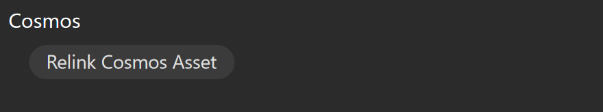

Cosmos
Relink Cosmos Asset – If the asset is misplaced or missing from the scene, it will appear in the Objects tab with this icon . Clicking on this option will automatically relink the asset to the scene.
Alternatively, you can relink assets using the Download Cosmos Assets tool.
