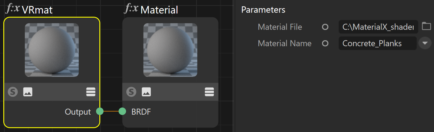

The VRmat node material is useful for working across multiple platforms; the VRmat loads a V-Ray shader from a file (.vrmat, .vismat, .vrscene, .mtlx) and makes the materials in these files available for use in the scene. These files can be exported from Maya or 3ds Max and used on any platform.
To share materials cross-platform, an existing V-Ray material is converted through the VRMat Converter, the output of which can then be read into a scene using the VRmat node in the material editor or the node editor of the destination platform. This allows you to use a material originally created in 3ds Max or Maya in a Cinema 4D scene.
Note: If you load a shader from a .vrscene file, you can only use it directly; you cannot edit it.
If you want to edit the scale of the VRmat's UVs, you can do so using the VRayObjectProperties tag, which adds additional UV scaling. See the VRayObjectProperties page for more information.
If you wish to disable the material preview or adjust its quality to save processing power, you can do so from the Material Node.

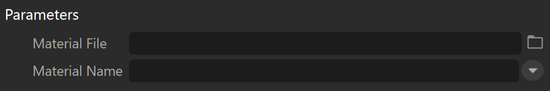

Material File – Loads a .vrmat, .vrscene, or .vismat containing one or more V-Ray materials or a .mtlx file.
Material Name – A list of all V-Ray materials saved inside the loaded .vrmat, .vismat, or .vrscene file or material loaded inside the .mtlx file.
