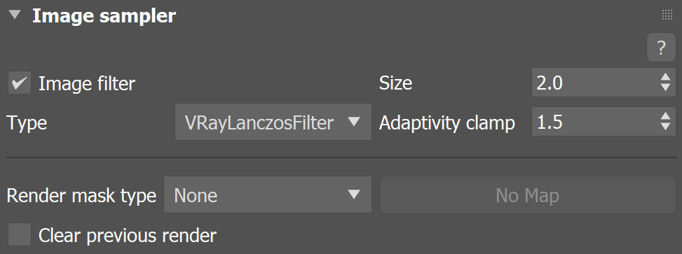

Image filter – Enables sub-pixel filtering. When this option is disabled, an internal 1x1 pixel box filter is used. Using image filters may slightly increase rendering times. Select between Area, Blend, VRayLanczosFilter and VRayBoxFilter.
Size – Specifies the size of the image filter.
Adaptivity clamp – Specifies an intensity limit for the adaptive bucket and progressive samplers to avoid excessive sampling of overexposed areas. Lower values mean a lower limit and potentially noisy overexposed areas. Higher values produce more samples in overexposed areas.
Render mask – Enables the use of a render mask to determine which pixels of the image are calculated. The rest of the pixels are left intact.
None – A render mask is not used.
Texture – Render mask is a texture. Black values in the map define pixels which are not rendered. Pixels with any other values are rendered. The texture should use the screen mapping type.
Selected
 – Only pixels that belong to the currently selected object(s) are rendered. V-Ray still calculates the entire image, but only renders parts that belong to the selected object(s). This mode is useful if you want to isolate or re-render just some objects from the scene.
Include/Exclude list
 – Same as Selected, but objects are selected by list.
Layers
– Renders only objects that belong to the currently selected layer.
Object
IDs – Renders only objects with specified Object IDs. Separate Object IDs with a comma (,).
Clear previous render – Removes the previous frame for the VFB.
For more information on how to use the Render mask feature, see the Render Mask tutorial.
Include – (available for Include/Exclude list mask) Opens the 3ds Max Exclude/Include window for selection of objects to be excluded or included.
+ – (available for Include/Exclude list mask) Adds objects to the Exclude/Include list by picking them in the viewport.
- – (available for Include/Exclude list mask) Removes objects from the Exclude/Include list by picking them in the viewport.
Include Layers  (available for Layers mask) Opens the Include/Exclude layers window for selection of layers to be excluded or included.
