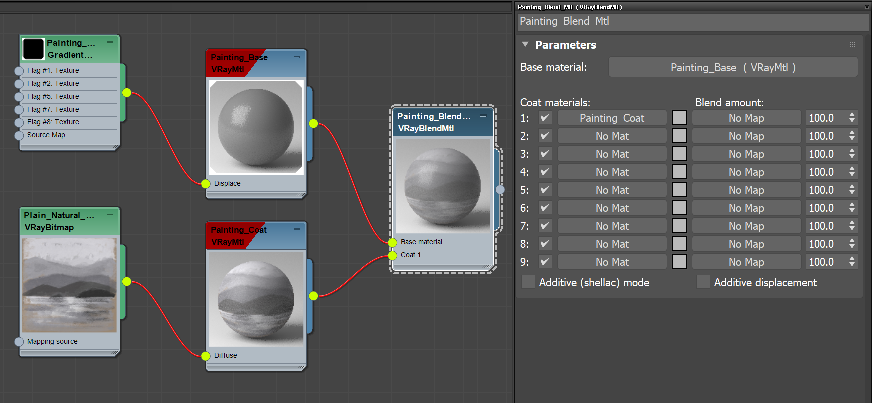

Let’s separate the frame and the canvas of the painting by using different materials. For this purpose, use a VRayBlendMtl.
  • Create a VRayBlendMtl and name it Painting_Blend_Mtl.
For the painting frame material:
  • Create a new VRayMtl with a color of your liking. In this case, we use gray with a Value of 50 for the Diffuse color.
  • Set the Value of the Reflection color to 200.
  • Set the Reflection Glossiness to 0.75.
  • Make a copy of the existing Painting_Displacement Gradient Ramp map (see Tutorial Part I) and name it Painting_Base_Displacement. Plug it to the Displace slot of the VRayMtl.
  • Name the new material Painting_Base and then plug it to the Base material slot of the Painting_Blend_Mtl.
For the canvas:
  • Create a new VRayMtl and load a VRayBitmap with the Painting_Coat_Diffuse.jpg file, which is available in the Assets folder (check the downloadable scene files).
  • Set the Value of the Reflection color to 100.
  • Set the Reflection Glossiness to 0.6.
  • Name the material Painting_Coat and then plug it to the Coat 1 slot of the Painting_Blend_Mtl.
Now create a black and white Gradient Ramp mask to separate the two materials. Use the parameters shown in the screenshot for the mask.
Plug the Painting_Blend map to the Blend 1 slot of the Painting_Blend_Mtl.
