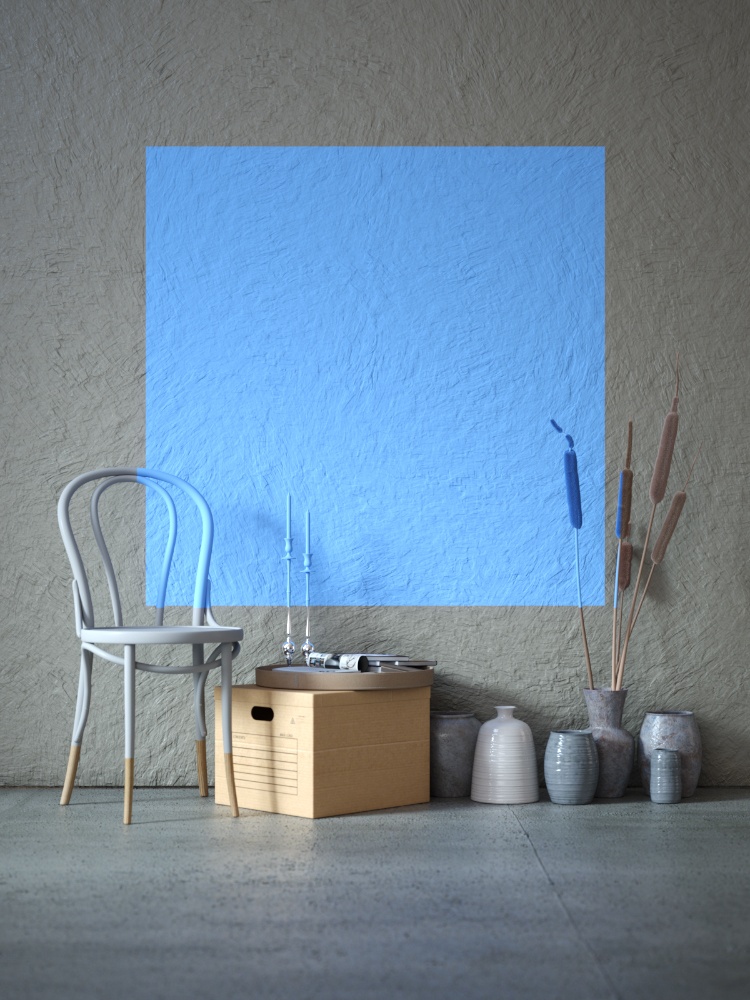

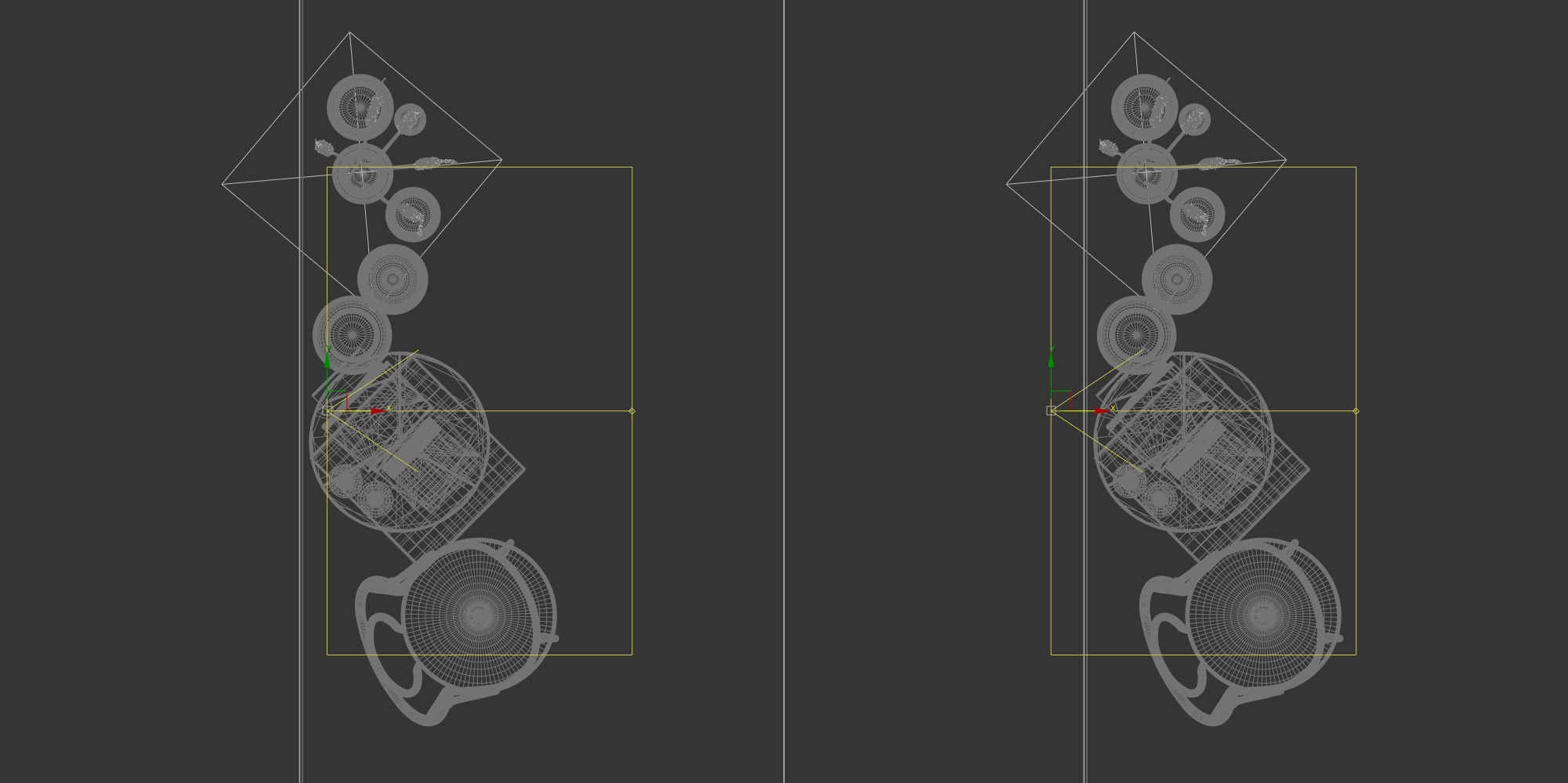

  • Make sure the Projection depth is large enough to give the V-Ray Decal an intersection with the wall geometry. Otherwise, it won’t project itself. In this particular case, let’s set it to 75 and move the V-Ray Decal by the X axis in front of all objects while it intersects the wall a bit.
Let’s render two example images for comparison - one with intersection and one without intersection.
Note that the V-Ray Decal projection uses the underlying wall displacement.
As the V-Ray Decal has no material assigned yet, it renders with a default material whose Diffuse color is set by the V-Ray Decal wireframe color.

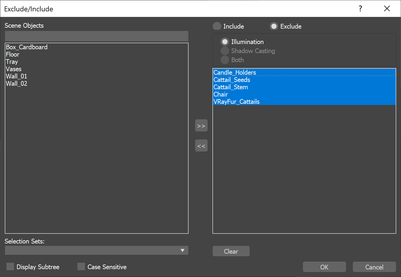

Now let’s see how to exclude the objects in front of the wall from the decal’s projection.
There are two approaches: either by moving the decal behind the objects (between them and the wall), or by using the Exclude option in the V-Ray Decal parameters.
Let’s try the second approach.
  • Open the Exclude/Include dialog from the Exclude button, and select all the objects in the scene that you don’t want to be affected by the decal, i.e. the Chair, the Candle_Holders, and the Cattails.
Let’s render to see the result.

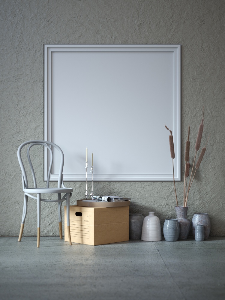

Now let's remove the displacement detail from the painting and make it smooth.
  • Select the V-Ray Decal in the viewport.
  • In the decal’s parameters, enable the Use only decal displacement option.
Thus, the V-Ray Decal renders only with the displacement assigned to its material, making the painting surface smooth, while the frame is displaced.
Render the scene to see the result.
Notice the thin gap around the painting frame. It's a design decision and it's intentionally produced by the last black strip in the Painting_Frame’s Gradient Ramp map.
There is no value for the displacement (since the color is black) which combined with the wall displacement creates this gap detail.
