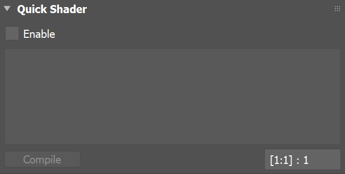

Quick Shader
The Quick Shader rollout allows fast shader sketching inside the plug-in without the use of external files.
Enable – Activates the built-in text editor. Once enabled, place the original code inside the text area. Alternatively, start writing in the blank area your own code. If you have already loaded a shader in the material parameters, right-click on it and select the Open in Quick Shader option. Another way to do this is to activate the text area and drag and drop the .glsl (.frag) file in there. It loads the code instantly.
Compile – Compiles the written shader, keeping the current shader parameters. To compile the shader and reset its parameters to default, hold the Shift button and then click Compile.
Right-click the Quick Shader panel to open a context menu, containing basic text editing functions. Through the menu options, you can also Compile the code after doing changes or Compile and Reset Parameters, which affects the values of the parameters in the shader as well.
