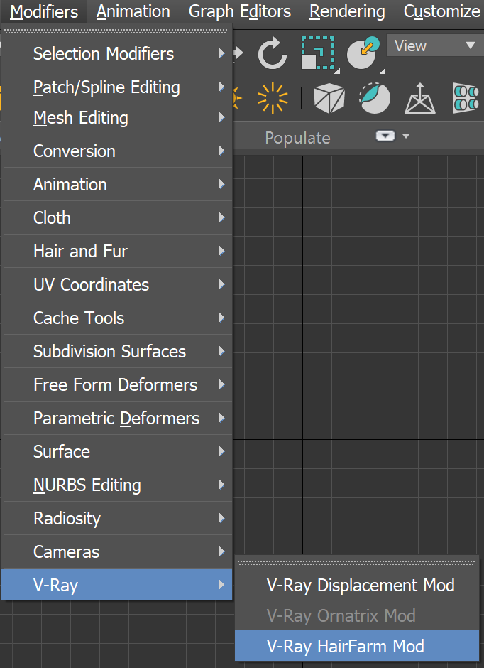

||Select geometry|| > V-Ray menu > Create > Modifiers > V-Ray HairFarm Mod
||Select geometry|| > Modifiers menu > V-Ray VRayHairFarmMod
||Select geometry|| > Command panel > Modify tab > Modifier list > VRayHairFarmMod
