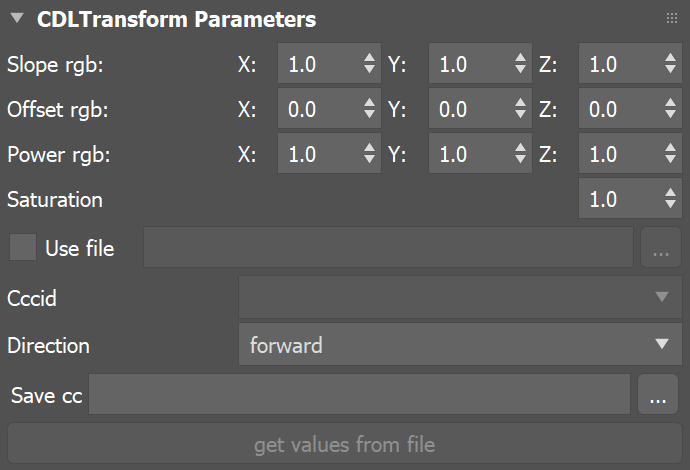

CDLTransform Parameters
These parameters are available when the Mode is set to CDLTransform.
Slope rgb – Multipliers for the red/green/blue color components.
Offset rgb – Offset values for the red/green/blue color components.
Power rgb – Gamma values for the red/green/blue color components.
Saturation – The saturation value; 0.0 makes the image grayscale.
Use file – When enabled, the CDL parameters are read from a .cc or a .ccc file instead of specified directly.
File – Specifies a .cc or .ccc file to read.
Cccid – Color correction id as specified in the color correction file.
Direction – Specifies whether the forward or the inverse CDL transformation is applied.
Save cc – Allows the CDL parameters to be saved in a .cc file.
get values from file – When Use file is enabled, this button copies the parameters from the file into the texture parameters so that they can be adjusted if needed.

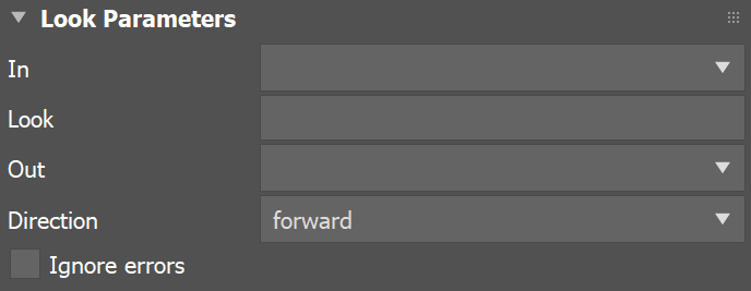

Look Parameters
These parameters are available when the Mode is set to Look.
In – The color space of the base texture.
Look – The name of the look if the OCIO configuration defines looks.
Out – The output color space.
Direction – Specifies whether to apply forward or inverse transformation.
Ignore errors – When enabled, attempts to perform color corrections even if there are errors.
