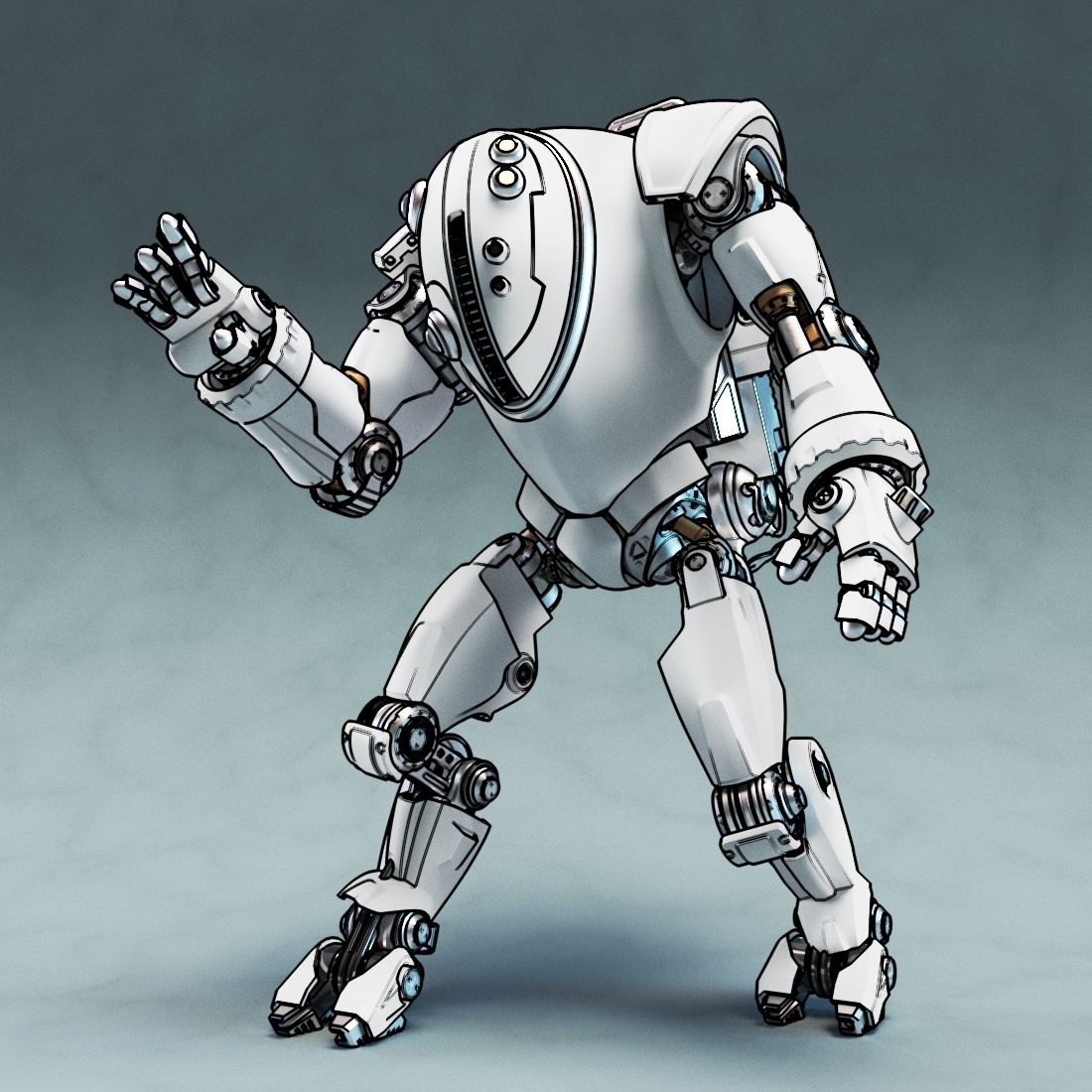

VRayToon is a very simple atmospheric plugin that produces cartoon-style outlines on objects in the scene. The settings for a single VRayToon atmospheric are applied to all objects selected for inclusion. Multiple toon styles can be represented in a scene by creating several VRayToon atmospherics and including/excluding different sets of objects.

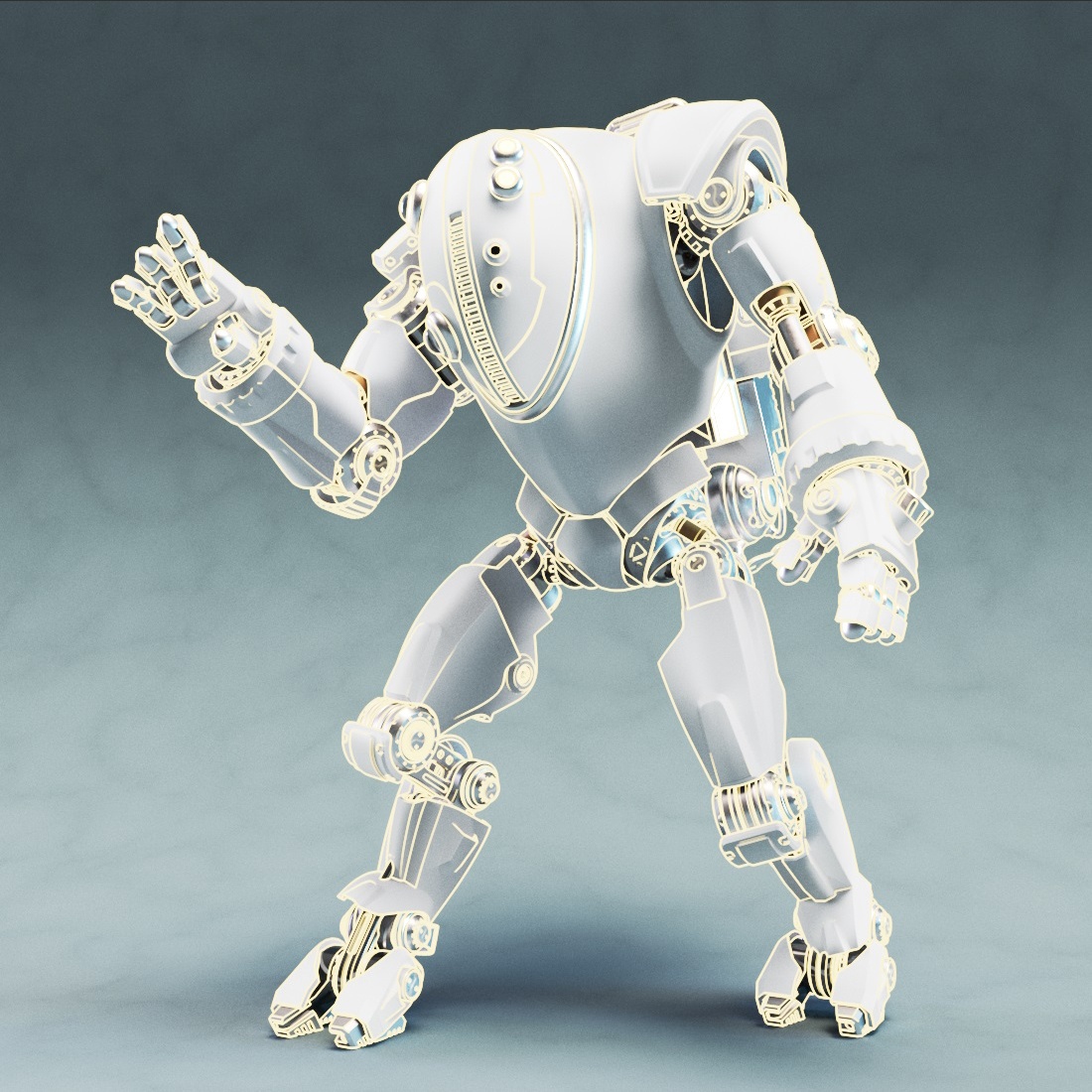

Line Color
Line color = black rgb(0,0,0)
Line color = white rgb(255, 255, 255)
Line color = yellow rgb(215, 161, 68)

Hide Inner Edges
off
on
