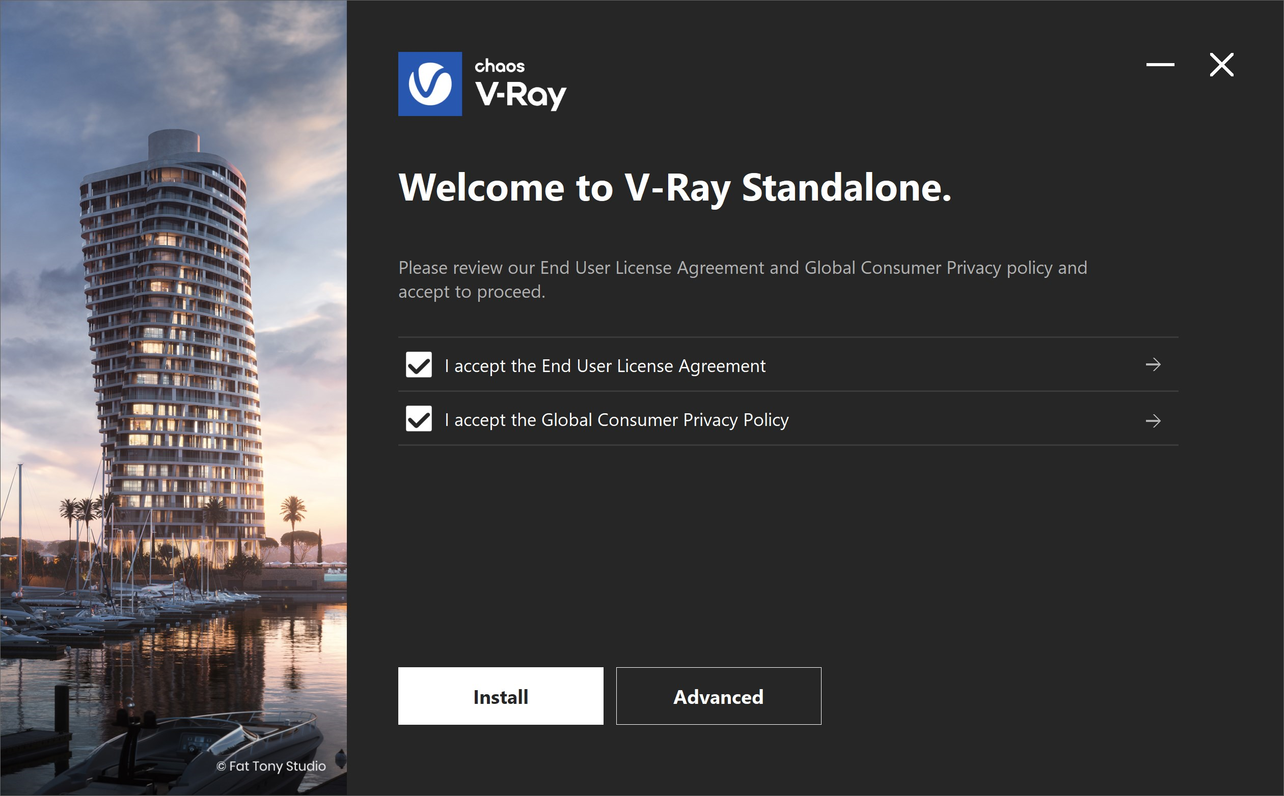

Welcome
Carefully read the End User License Agreement and the Global Consumer Privacy Policy. Click the I accept buttons if you agree to the terms.
Proceed to click the Install button. If you need to customize your V-Ray installation, click the Advanced button.

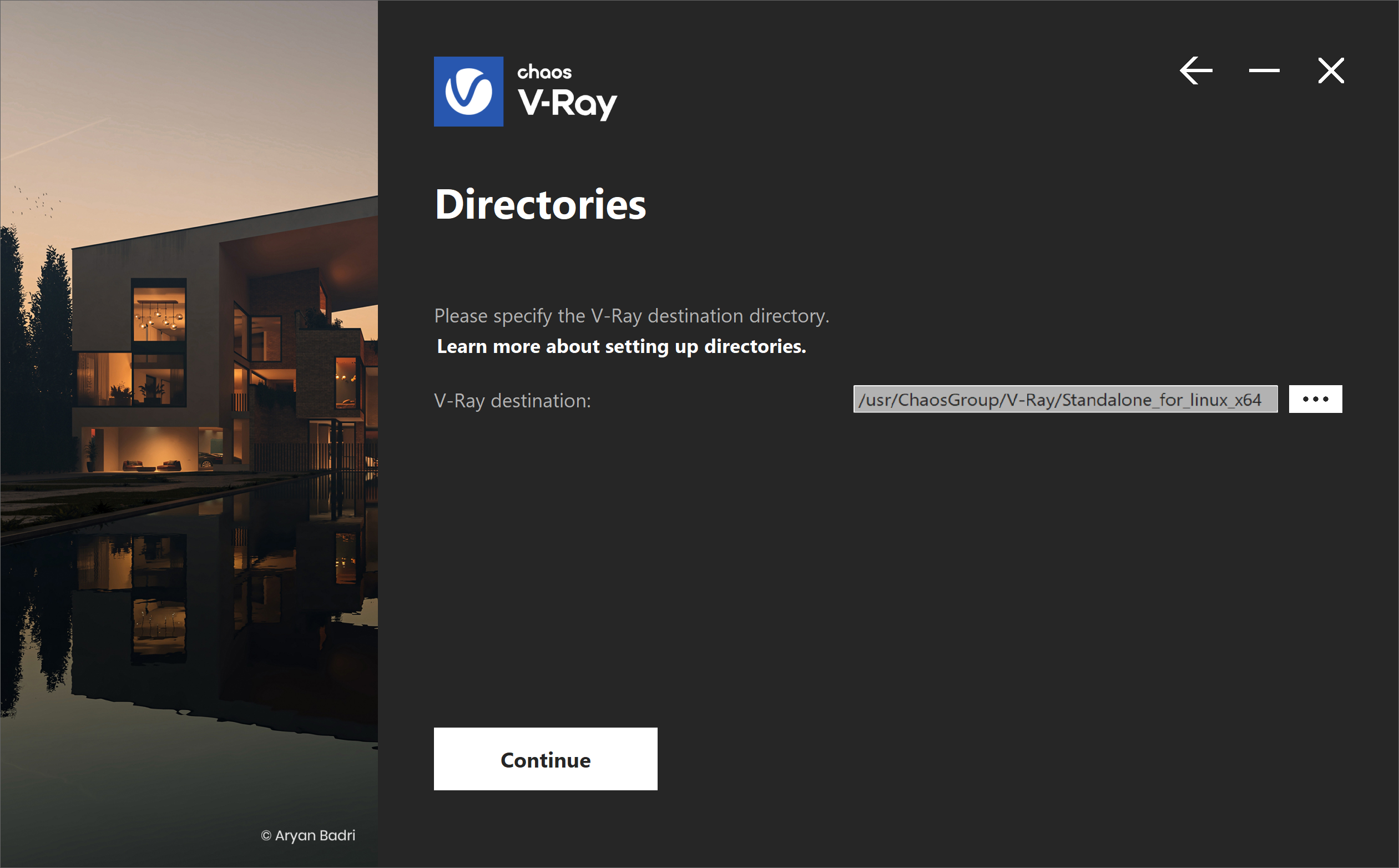

Directories
Here, you can specify the installation path. Please check if the default folder is correct.

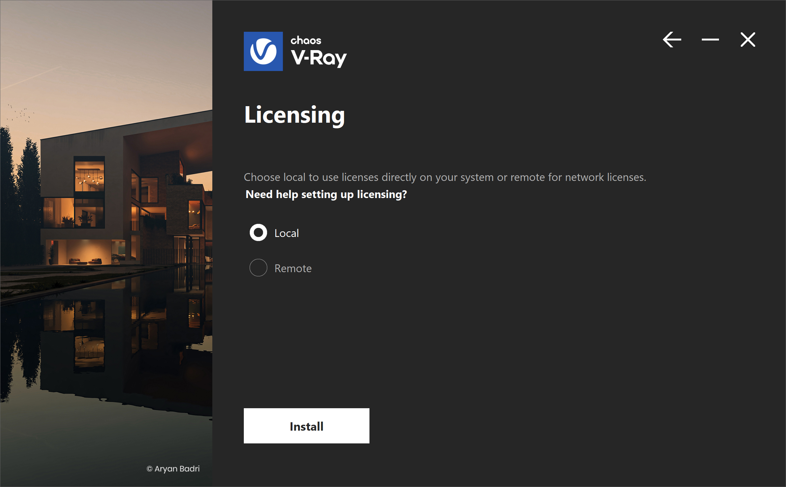

Licensing
In this step, you can specify whether the Chaos License Server runs locally or on another machine.
Local – This option installs the License Server on your machine. For a walkthrough, see the Chaos License Quick Start Guide.
Remote – This option allows you to configure your Chaos product for floating licenses in a local network. Fill in the IP address of the Chaos License Server in your network in the Primary License Server field. Please leave the port 30304 unchanged. For more details on this setup, see the License Server Deployment page.

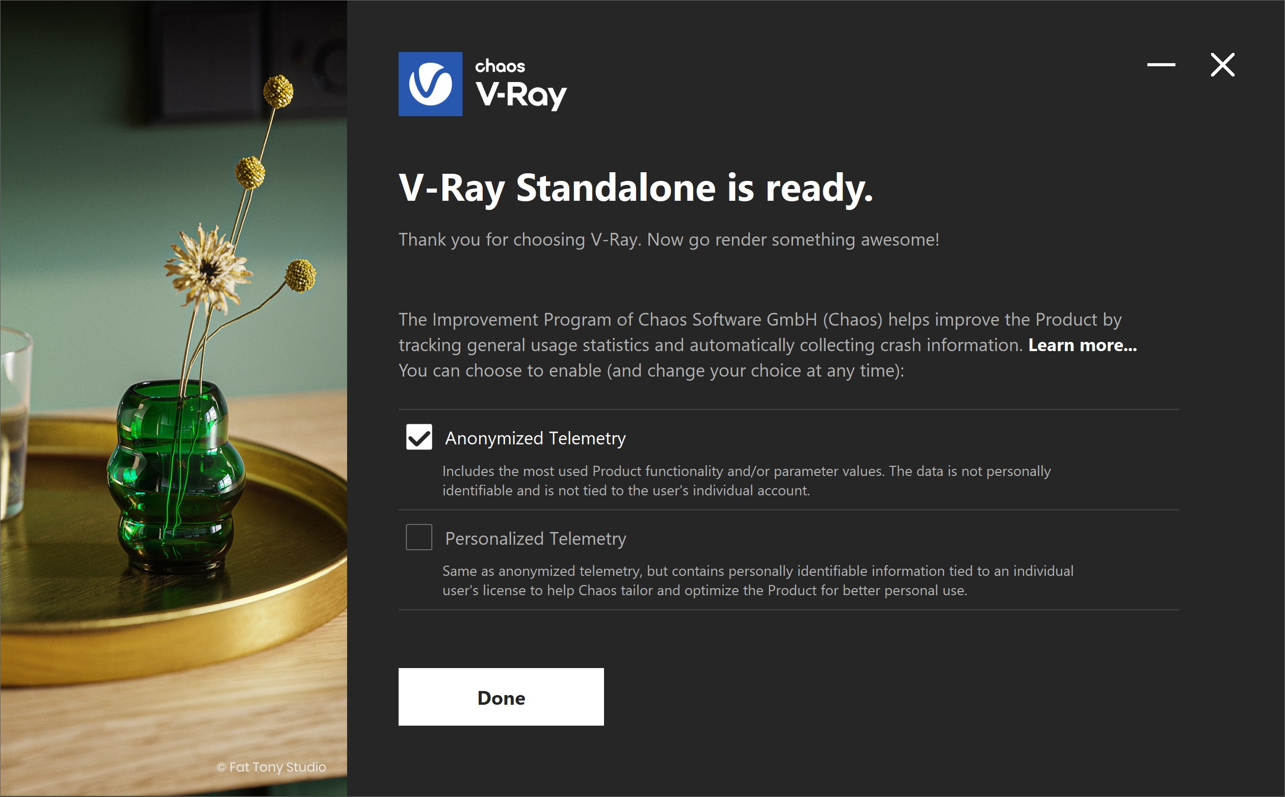

Chaos Telemetry
Participate in the improvement decisions for future versions of V-Ray Standalone. No intelligence property is violated when agreeing to participate in the feedback program. Chaos does not gather scenes, assets, materials, etc.
Anonymized Telemetry – Includes the most used product functionality and/or parameter values. The data is not personally identifiable and is not tied to the user's individual account.
Personalized Telemetry – Includes the most used product functionality, parameter values, but also contains personally identifiable information tied to an individual user's license. This helps Chaos tailor and optimize the product for better personal use.
Click on Done. Don't forget to activate your license before use. No Chaos product can be used without a license!
