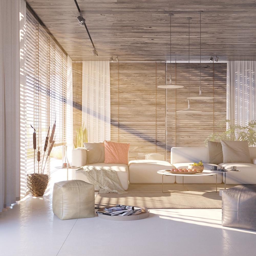

The Atmosphere Render Element is useful for changing the appearance of the atmosphere and volumetric effects in a rendered image using compositing or image editing software. In the example, fog is generated using the V-Ray EnvironmentFog. The fog is assigned a warmer color and the intensity is increased, using the Atmosphere RE.
Before
After

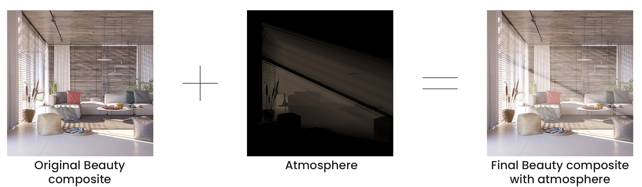

Compositing Formula
The V-Ray Atmosphere Render Element is added to the Beauty render to form the final image.
