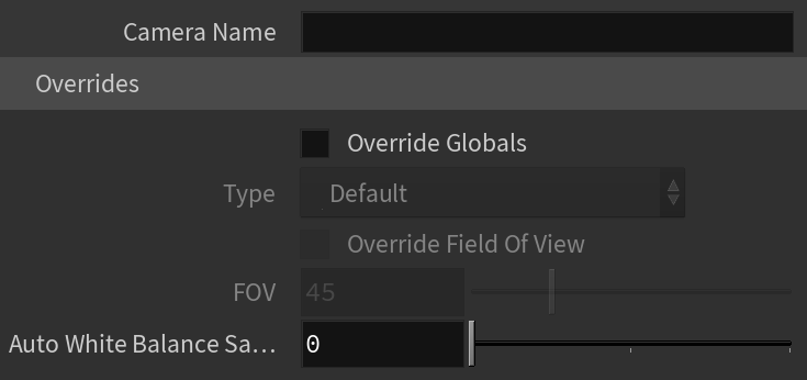

The V-Ray Camera Properties allow you to override some of the camera settings specified in the Camera Tab. In this way, you can have different camera settings for each camera in the scene. The options below control the way the geometry is projected onto the image.
Camera Name – Custom name to be used for the camera when exporting it to a .vrscene file. If not specified, the full path of the camera node is used.
Override Globals – Overrides the global camera settings for the current camera. Must be checked in order to access the settings.

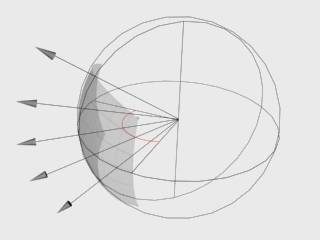

Spherical – A camera with a spherically shaped lens.

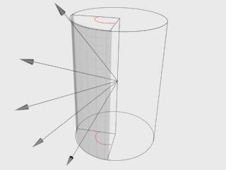

Cylindrical (Point) – Casts all rays from the center of a cylinder. In the vertical direction, the camera acts as a pinhole camera, and in the horizontal direction, the camera acts as a spherical camera.

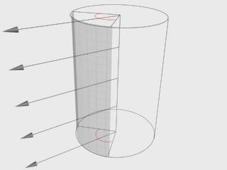

Cylindrical (Ortho) – Casts all rays are cast from the center of a cylinder. In the vertical direction, the camera acts as an orthographic view, and in the horizontal direction, the camera acts as a spherical camera.

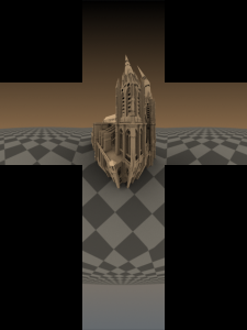

Box – Six standard cameras placed on the sides of a box. This type of camera is excellent for generation of environment maps for cube mapping and generates a vertical cross format image. Box camera can also be used for generating irradiance maps for GI: First you would calculate the irradiance map with a Box camera, then save it to a file and finally reuse it with a Standard camera that can be pointed in any direction.

Override Field Of View – Overrides Houdini's FOV angle. This is because some V-Ray camera types can take FOV ranges from 0 to 360 degrees, whereas the cameras in Houdini® are limited to 180 degrees.
Field Of View – Specifies the field-of-view angle when the current camera type supports FOV. This option is available only when Override Field Of View is enabled.
Auto White Balance Sample Accumulation Mode –

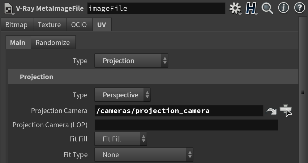

Projection of Textures
To project a texture from a camera, set the texture mapping type to Projection.
Then link the specific camera to the Projection Camera field of the texture.
If you are projecting a texture from a camera in Solaris, link the specific camera to the Projection Camera (LOP) field. For more information, see the Solaris Camera Settings page.

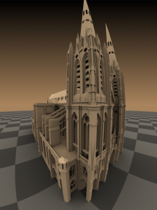

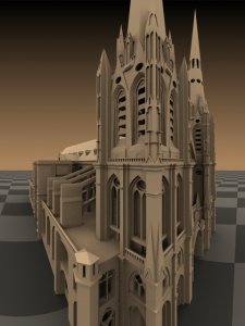

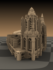

The images below show the differences between camera types:
Default camera
Spherifical camera
Cylindrical camera
Orthographic cylinder
Box camera
Fish-Eye camera

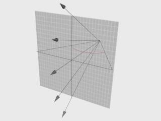

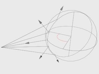

This example shows how the rays for different camera types are generated. The red arcs in the diagrams correspond to the FOV angles.
Default
Spherical
Cylindrical (Point)
Cylindrical (Ortho)

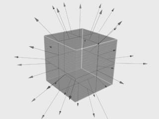

Box
Fish-Eye
