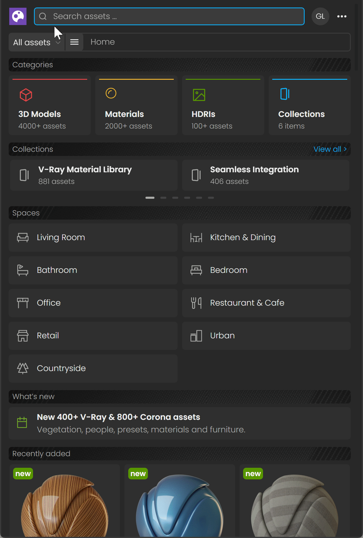

1. Click the Cosmos button from the V-Ray Shelf to open the Chaos Cosmos Browser. Alternatively, go to V-Ray menu > Import > Cosmos Browser.
2. Click the Sign in button. Then enter your Chaos credentials.
3. Use the menu or the Search tab to find assets. You can additionally choose between different Categories.
An option to show the Downloaded assets only is also available.
The filters help you refine your search by date, popularity, color, and space.
4. Use the  button to enable the Multi-Selection Mode. In this mode, you can select several assets to download, update or delete at once.
Currently the Multi-Selection Mode cannot be used for importing multiple assets.

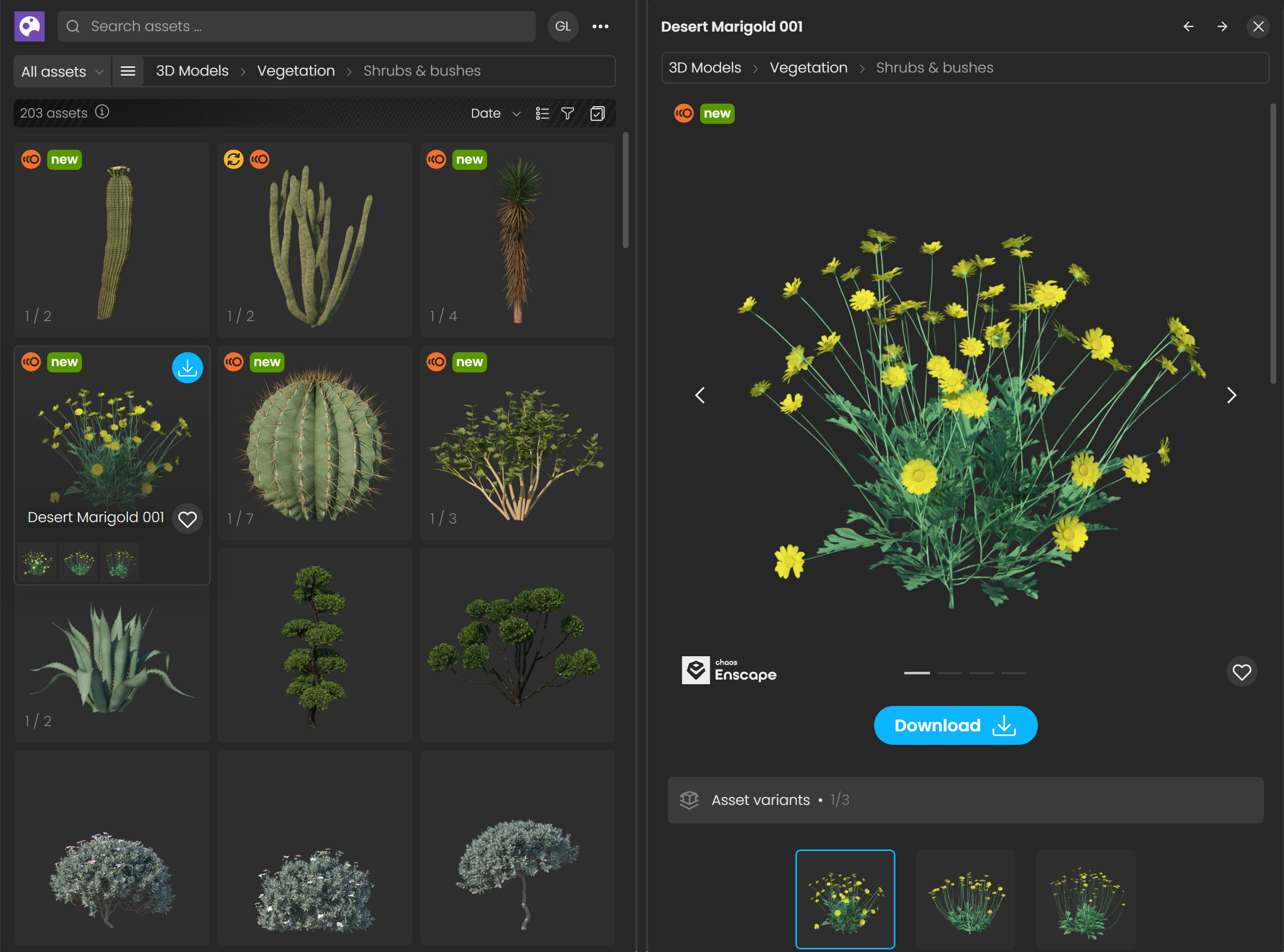

Once you choose an asset, you have to download it. Hover over it and click the Download  button.
Another way to download an asset is to click on it. This reveals additional information. You can see the category/space/color of the asset and other additional information. Other connected assets can be filtered by clicking on any of the additional information parameters. Click the Download button to download the asset.

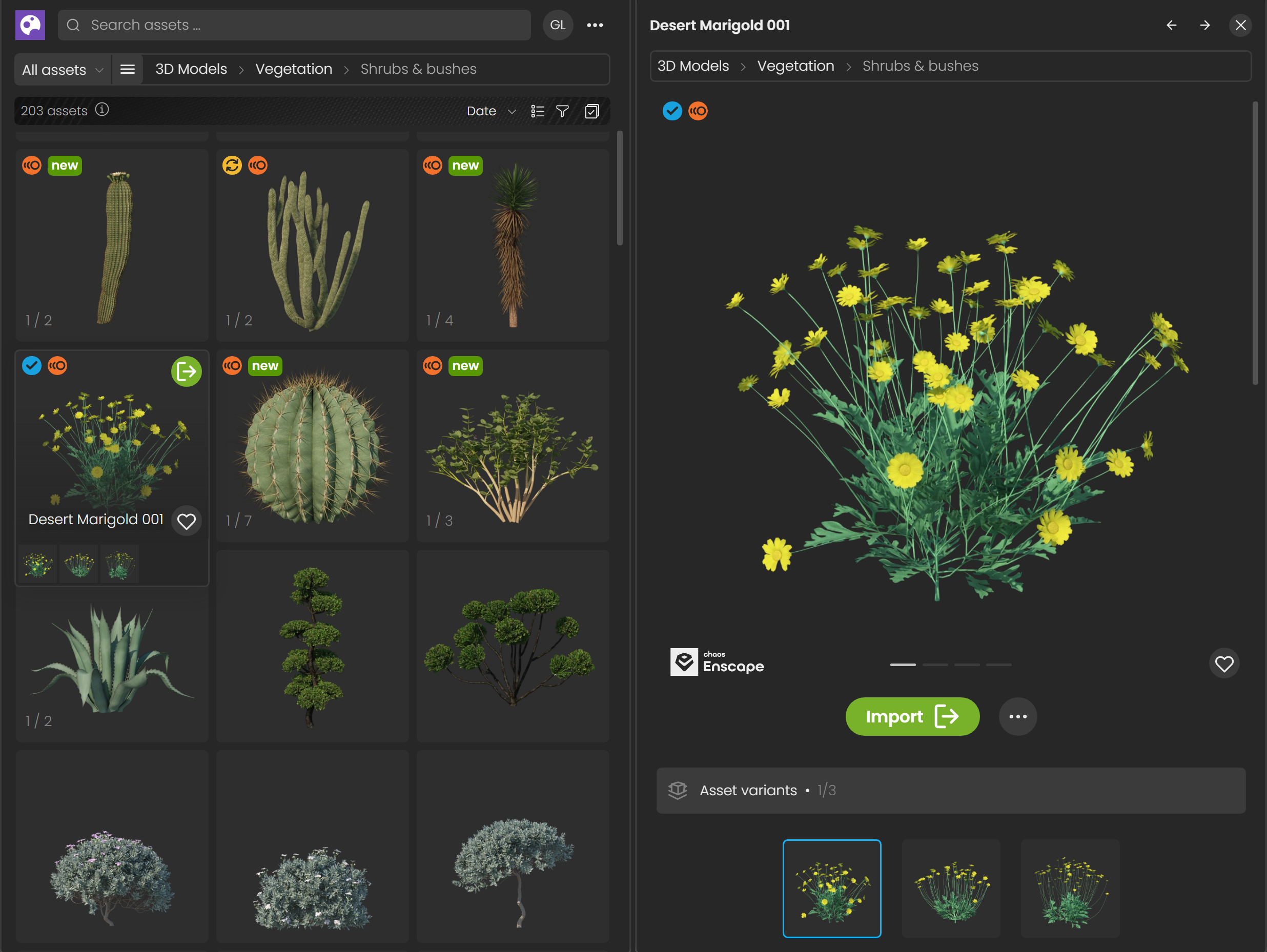

Once the download is complete, a pop-up window will state that the asset is downloaded successfully. Use the Import  button to bring the asset into the host platform. The button places the asset at 0,0,0 of the coordinates system.

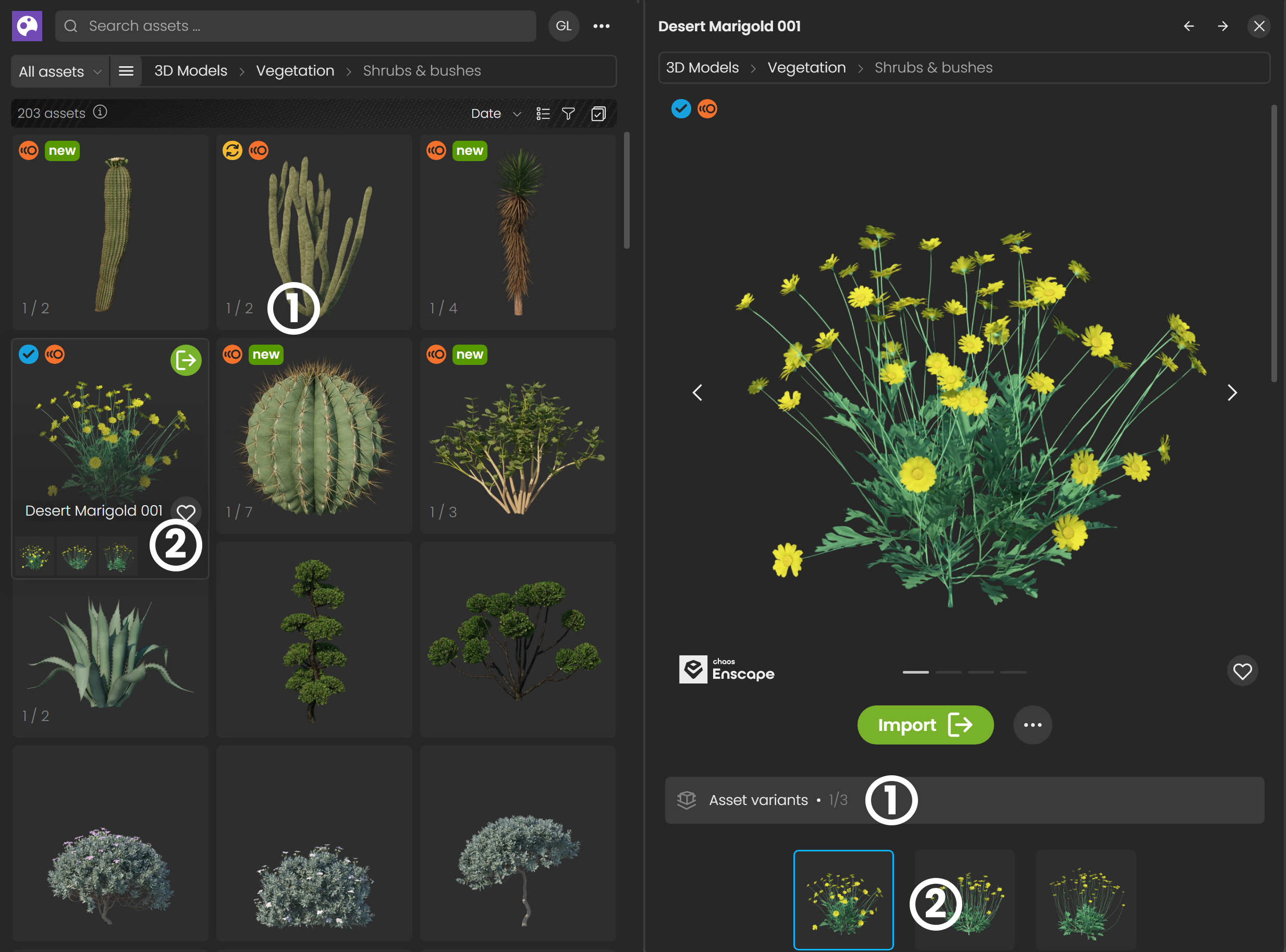

Assets with Variants
Some assets have more than one variant. Assets with variants combine different versions of the same asset into a single item in the library.
1. Assets with variants have an indicator displaying the total number of its variants.
2. To display the asset variants, hover over the asset. The variants show as small thumbnails and you can preview them by hovering over the thumbnail.
Note that you have to download and then import each individual variant if you want to have them all in your scene.

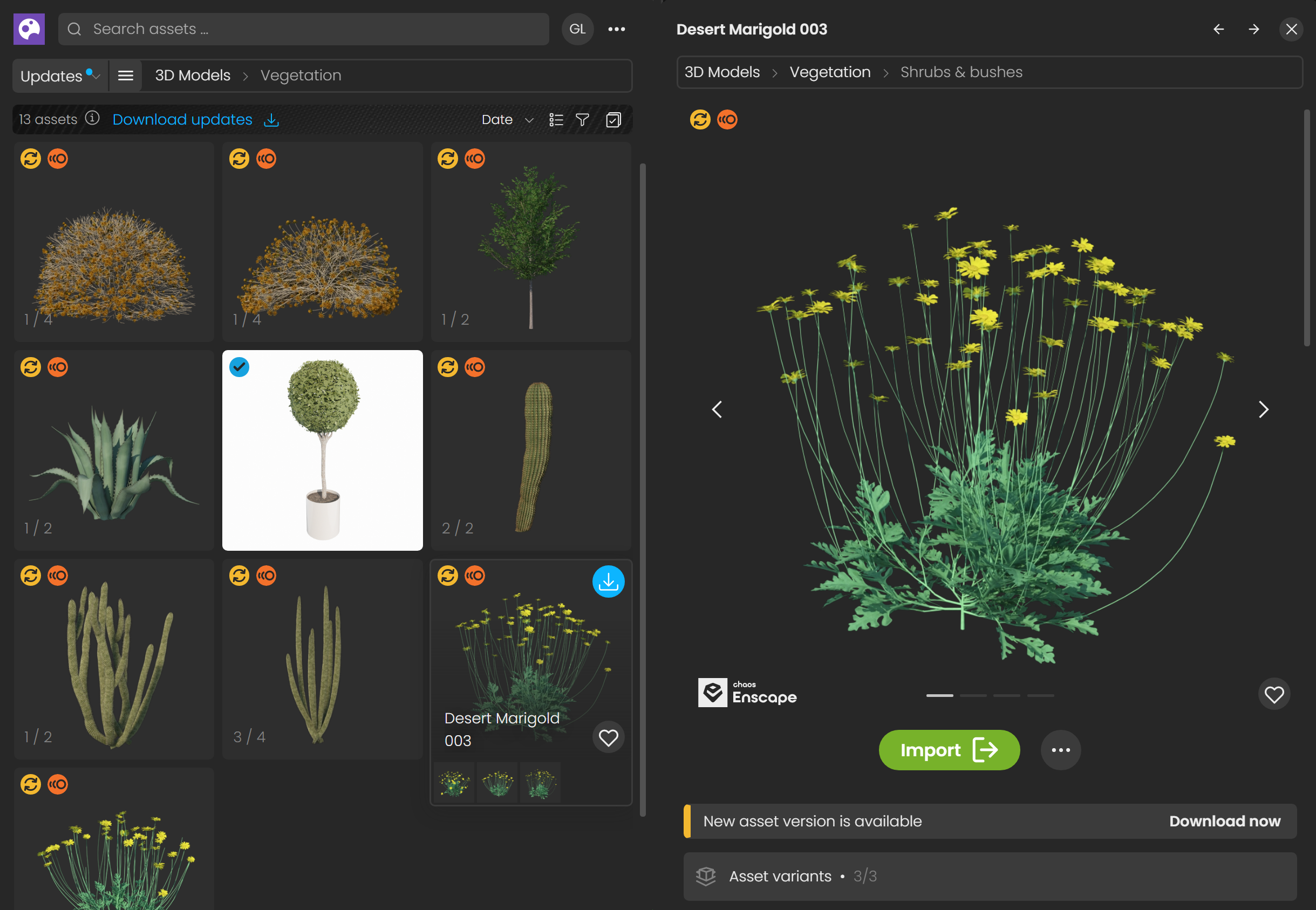

Cosmos assets get updated over time. When an update is available, an update label appears. You can download the new versions from within the Chaos Cosmos Browser. Click on the labeled asset to open a popup window and click the Download now update text in the bottom.
