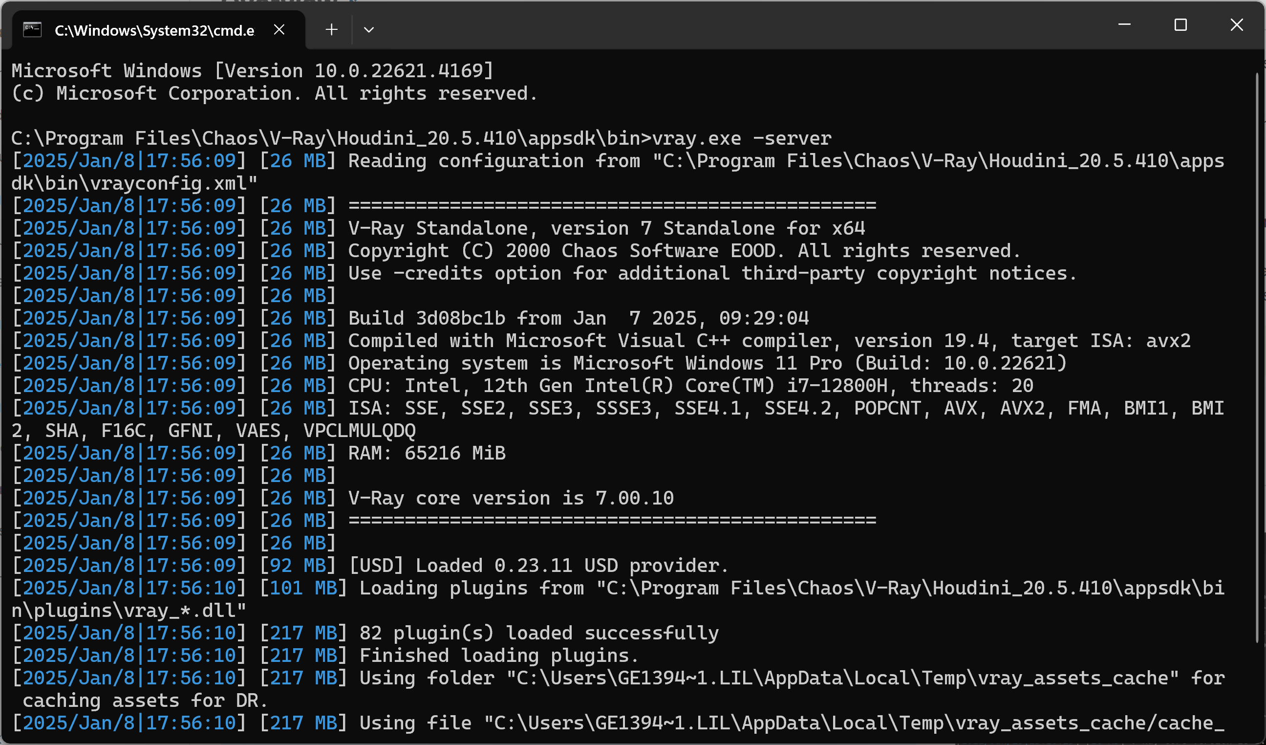

Render Servers:
  1. Navigate either to the V-Ray for Houdini installation folder, or the V-Ray Standalone installation folder.
  2. Navigate to the "appsdk/bin" folder if using V-Ray for Houdini, or the "bin" folder if using V-Ray Standalone.
  3. Open a new Command Prompt/Terminal and call "vray.exe -server" to start V-Ray in Server Mode.
 The default V-Ray installation paths are:
  • Windows: "C:\Program Files\Chaos Group\V-Ray"
  • Linux: "/usr/ChaosGroup/V-Ray"
  • OSX:  "/Applications/ChaosGroup/V-Ray/"

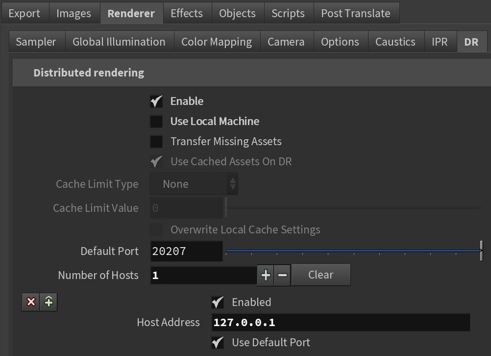

Render Client:
  1. Inside Houdini, create a V-Ray Renderer and go to RendererDR.
  2. Select Enable and add the Render Servers' network addresses. You may also want to disable "Use Local Machine" so that rendering is not performed on the Client machine.

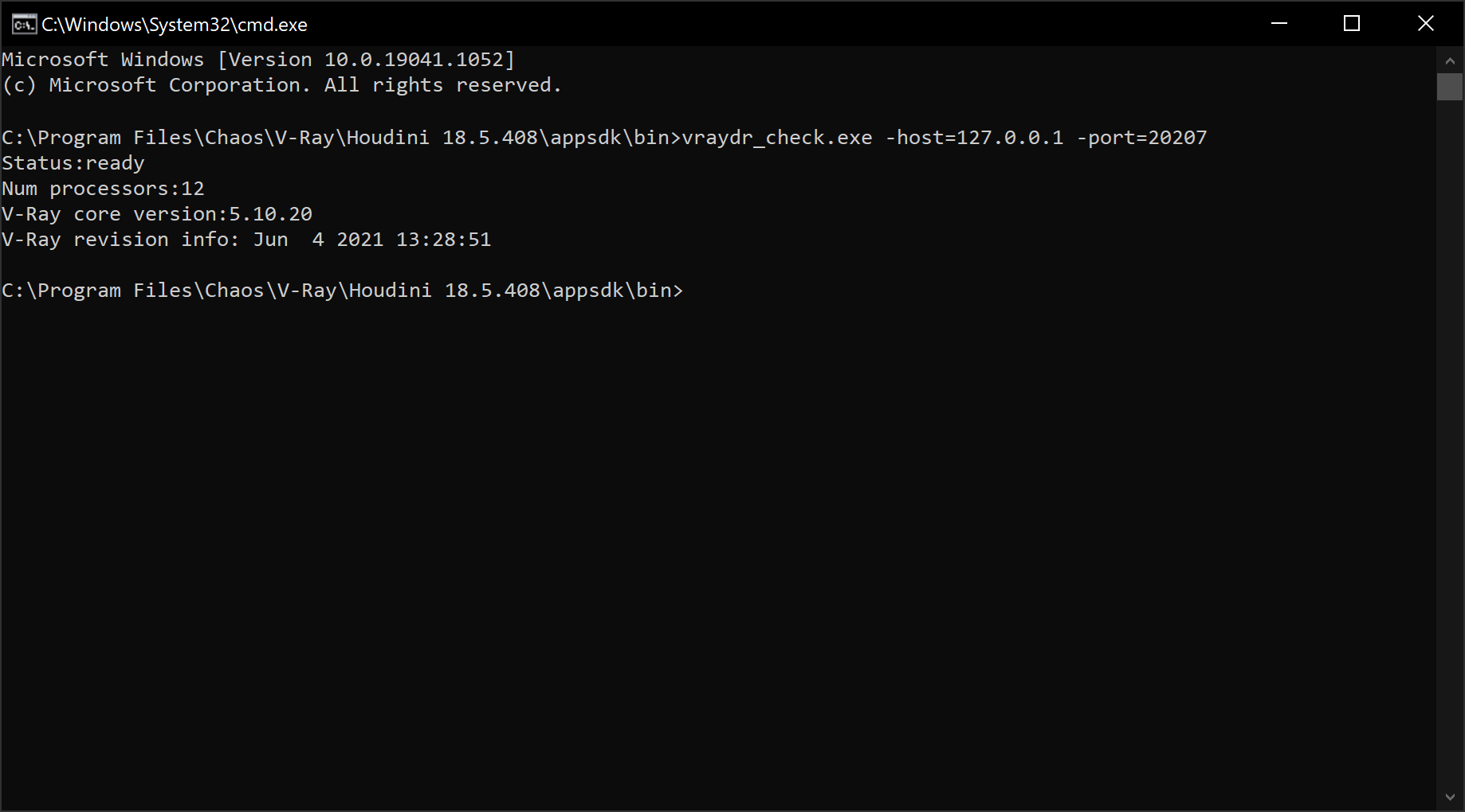

It is crucial to ensure the V-Ray Core Version is the same across all Render Servers and the Render Client. An easy way to check is by using the V-Ray DR Check tool.
  3. Open a new Command Prompt/Terminal and call "vraydr_check.exe -host=(HOST_ADDRESS) -port=(PORT_NUMBER)". For example: "vraydr_check.exe -host=127.0.0.1 -port=20207".
The following information is returned:
  • Status:ready
  • Num processors:12
  • V-Ray core version:5.10.20
  • V-Ray revision info: Jun 4 2021 13:28:51
