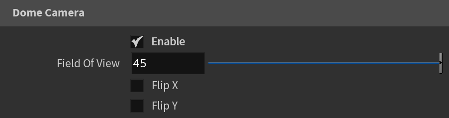

Dome Camera Properties
Enable – Enables the options in the rollout.
Field Of View – Specifies the field of view for the V-Ray Dome Camera.
Flip X – Flips the view around the X axis.
Flip Y – Flips the view around the Y axis.
