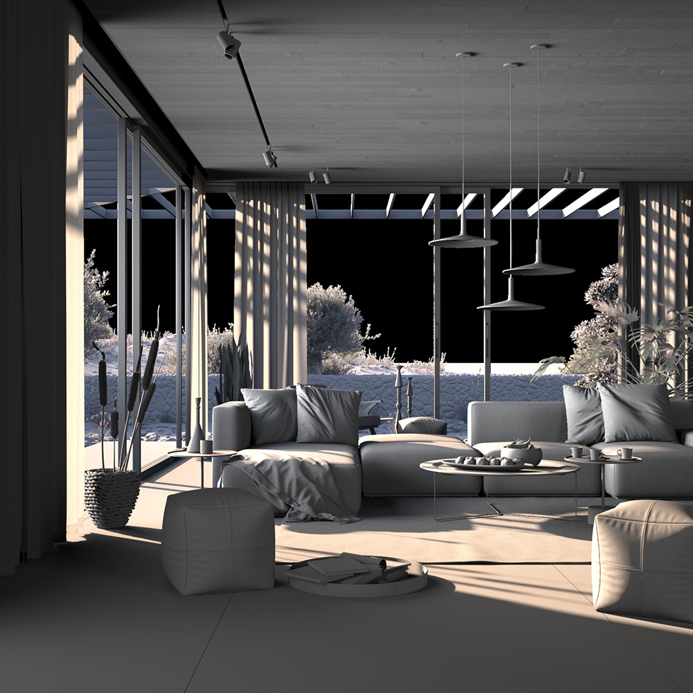

The Raw Direct Light Render Element stores the effects of direct light on scene objects with no diffuse components or GI contribution.
This is useful for adjusting the brightness of direct light during compositing.

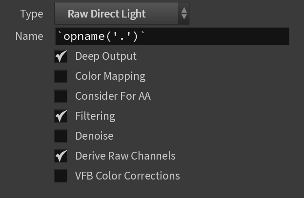

The parameters for this render element appear in the V-Ray RenderChannelColor render channels node.
Deep Output – Specifies whether to include this render element in deep images.
Color Mapping – When enabled, the Color Mapping options in the render settings are applied to the current render channel.
Consider For AA – When enabled, anti-aliasing is used where possible.
Filtering – Applies the image filter to this channel. Image filter settings are in the Image Sampler tab of the Sampler tab of the V-Ray Renderer node.
Denoise – Enables the render element's denoising, provided the V-Ray Denoiser render element is present.
VFB Color Corrections – Applies the post render color adjustments made from the VFB.
This render element is not supported with V-Ray GPU rendering.

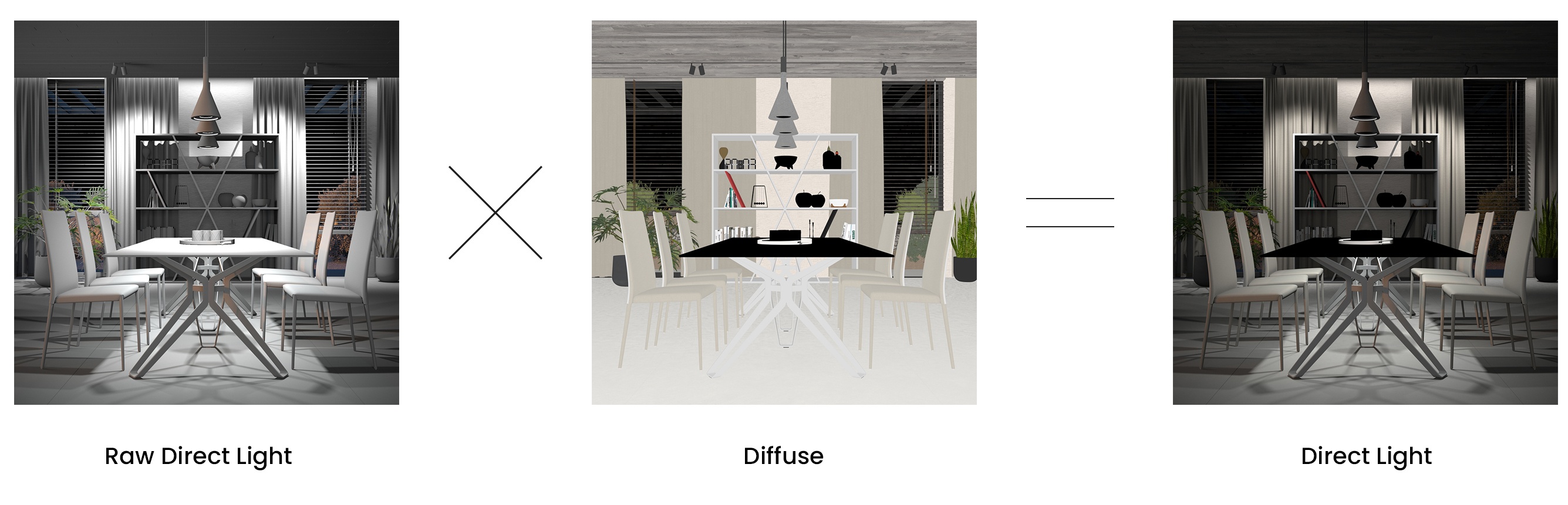

Underlying Compositing Equation
Raw Direct Light x Diffuse = Direct Light
