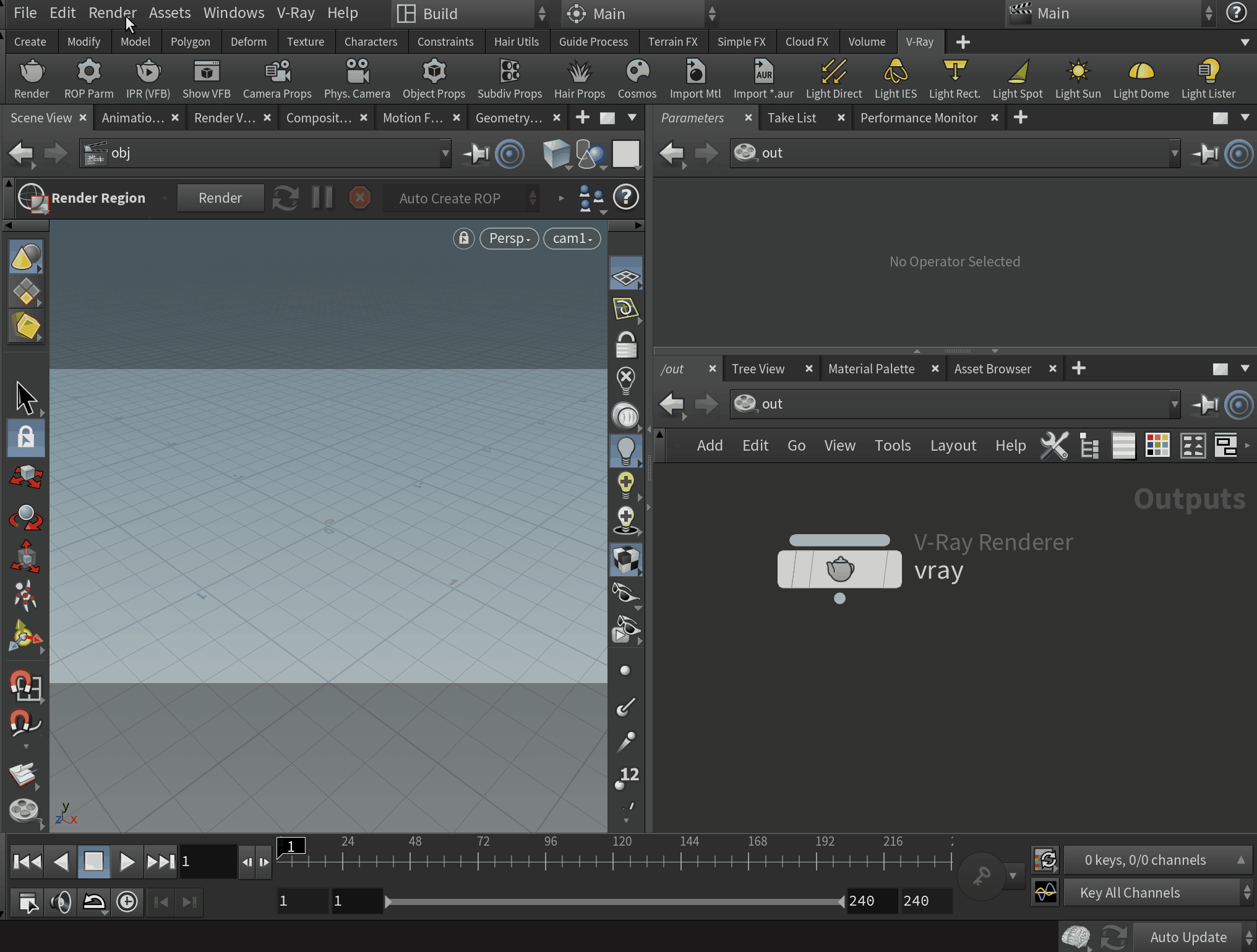

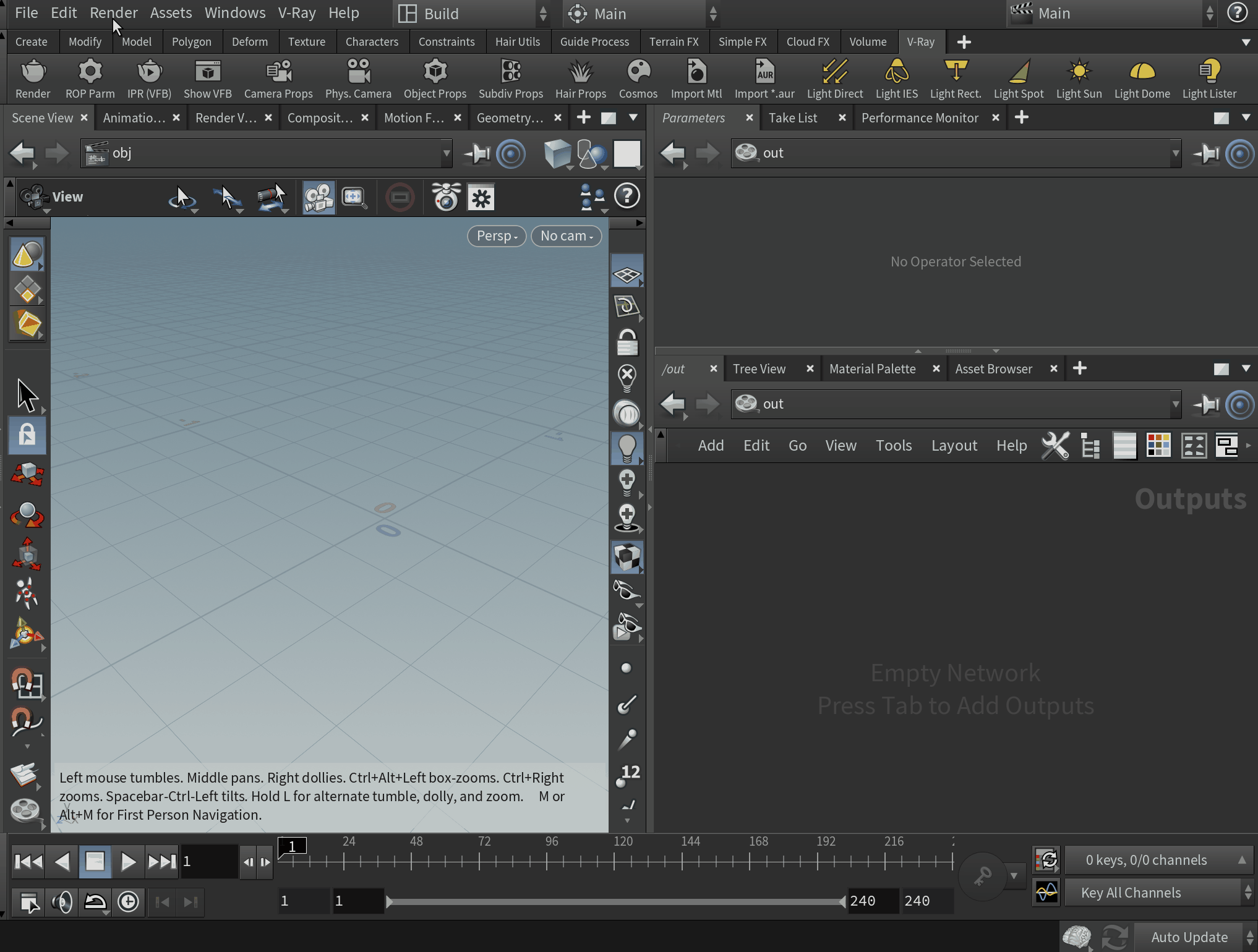

Create a V-Ray Renderer node in the out Network using one of the following ways:
  • Go to Render menu > Create Render Node > V-Ray
  • ||out Network|| > V-Ray Renderer

If vray/vray_ipr nodes aren't created in the out Network, clicking the Render button or Show VFB button on the V-Ray Shelf automatically creates a vray node. If necessary, the render settings can be configured.

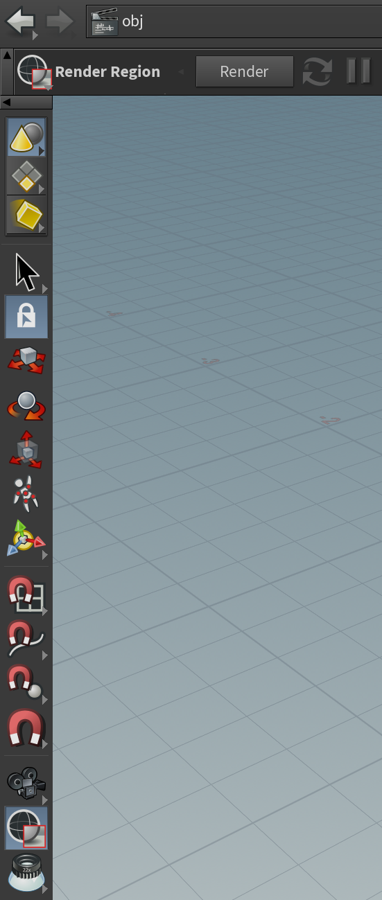

Select the Render Region button.
Select a region in the Scene View that will automatically start rendering using V-Ray IPR. For more information, see the Interactive Rendering page.
